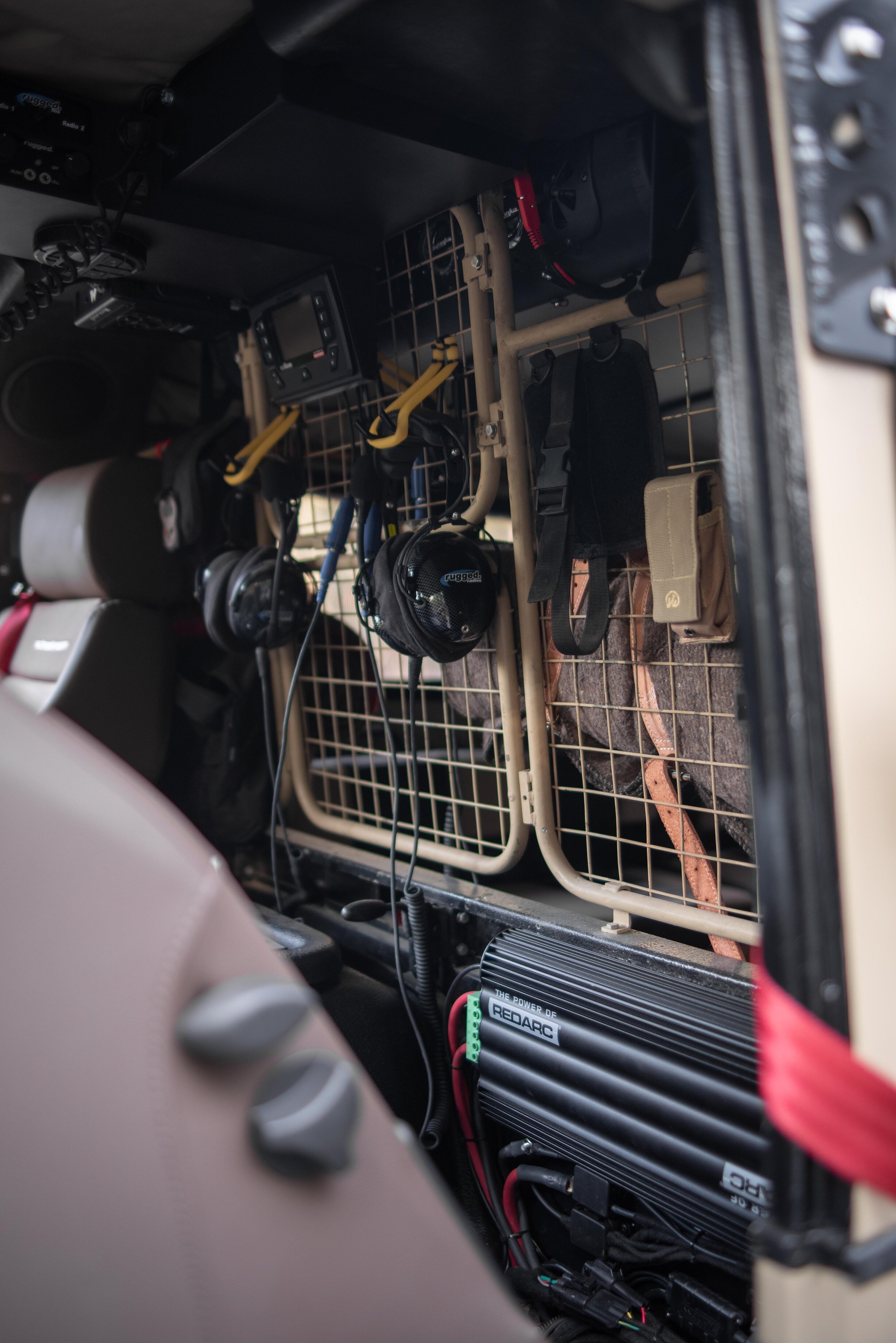

I have used the Rugged Radio intercom system for years. I have headsets for driver and passenger as well as one for the rear passengers (usually for the Team leader for whatever Search & Rescue team I'm hauling). I have them tied into my iCom radios so I can also use them for comms during a mission. I added the bluetooth module so my phone connects to them as well so I can pipe in music as well as take calls. Over past 4-5yrs they have performed extremely well. Highly recommend them.
Here's a few pics. First is headsets hanging on the divider panel.
If you look at the center console you can make out the two red buttons which is the Push To Talk to use the headsets with the radios, for intercom it's voice activated and I've had no problem dialing in the sensitivity for highway speeds in the Pinz. The controls are on the side of the center console, drivers side. I'll see if I can find a picture of them mounted.
