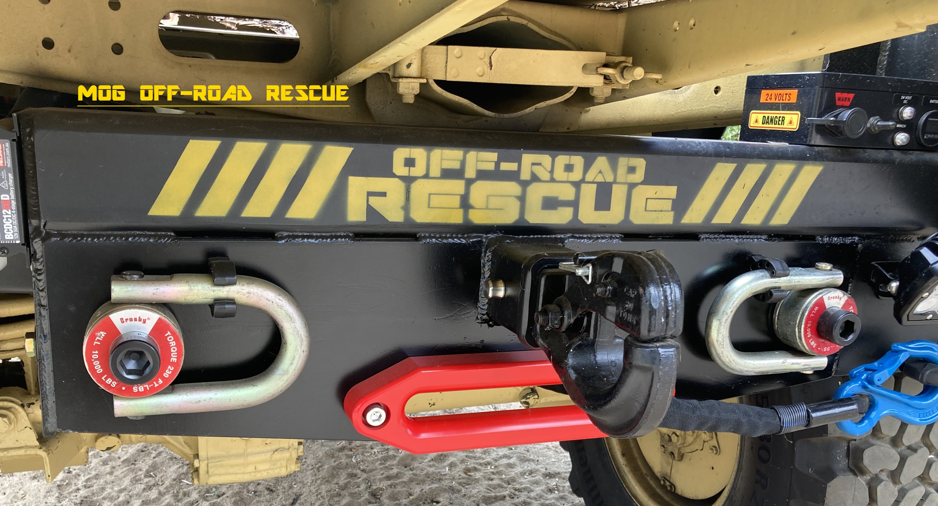

Design work on the front winch mount.
The holes on each lower side are threaded bolt holes for the swivel shackle recovery points, allowing any-angle anchor points that typical bow shackles don't allow for. They are actually rated at full working load even at 90 degrees!
The white chalk lines are where I'm plasma cutting the rest of the plate out for the larger industrial sized fairlead.

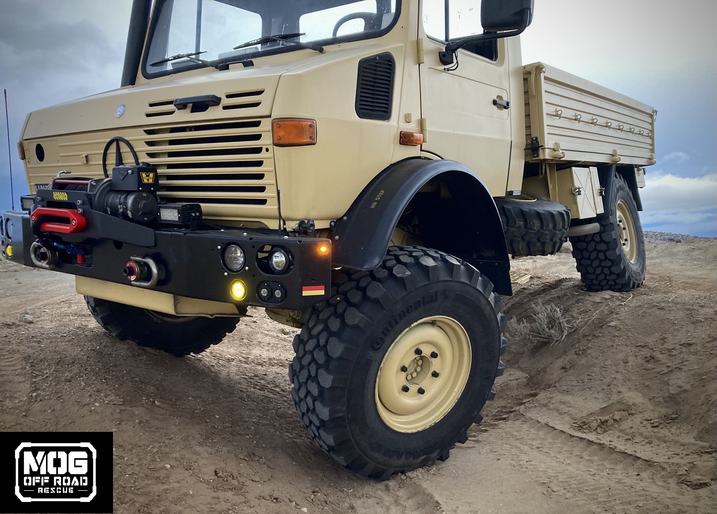

With no budget, it took endless months and a ton of custom work since I made it up as I went along, but my headlights/fog etc are done and working!
In case anyone is curious, the headlight is a multivolt Morimoto 90mm, beside that is the high-beam VisionX LED, under those are the Hella DE fog light converted to LED H3, then the two little lights are white and amber warning flashers.
On the right outer edge is the mini marker LED from Peterson, and the rectangle light over to the left is a Tomar LED white driving and switchable amber fog 2-in-1 light.

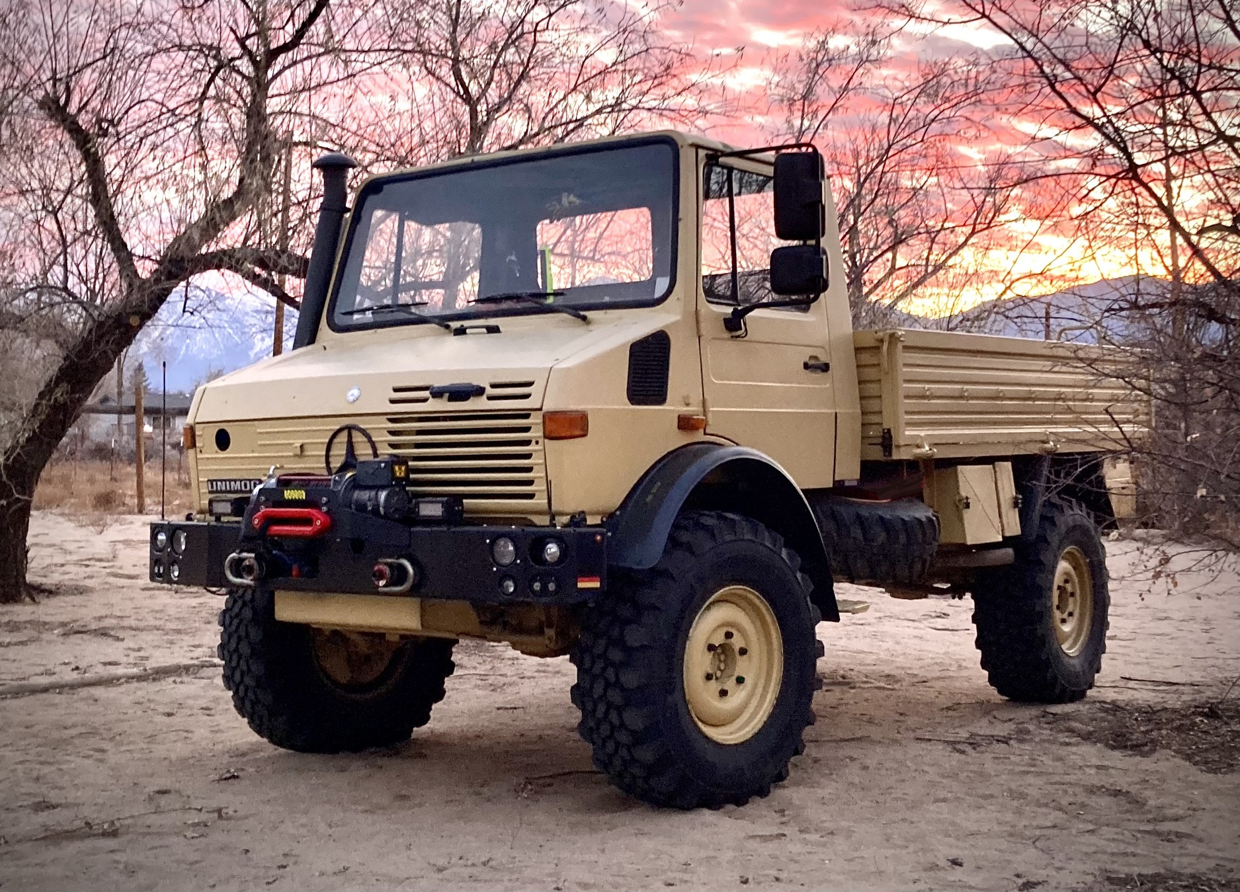

Website link- Check it out! https://www.mogoffroad.com/
Hopefully the sight of this machine arriving to people's call makes them feel better about the likely outcome. :D

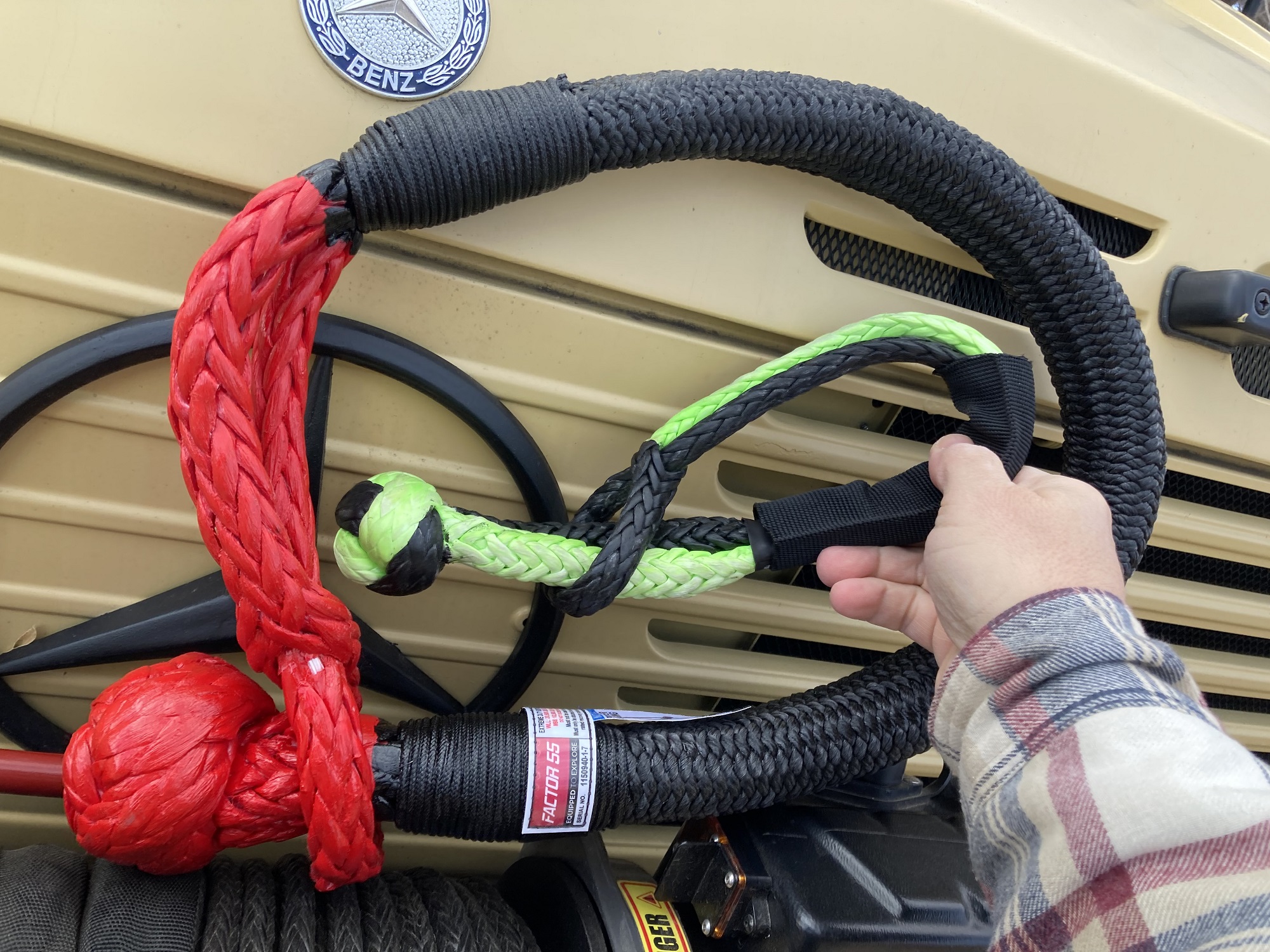

What most medium and full size 4x4's use for a soft shackle is in the middle. That's a 7/16" rated for loads around 10K lbs. (breaking around 45k)
The red one is a heavy duty version that I carry. Breaking strength on that one is 102,000lbs. Should get the job done on those heavier duty rescues. :shock: :lol:
