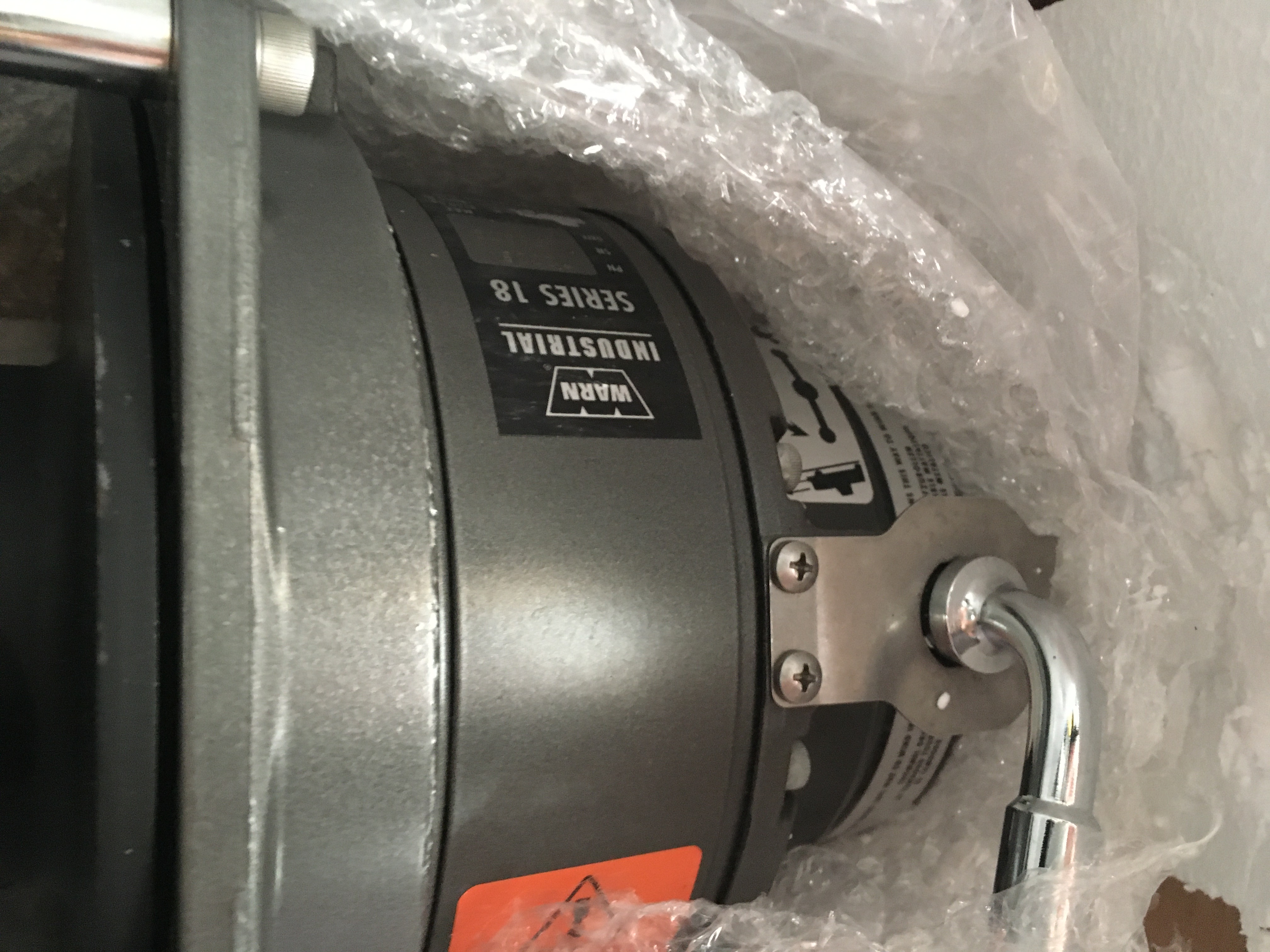

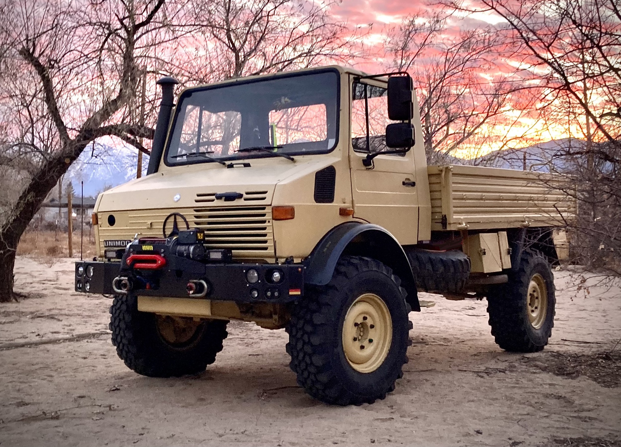

Thanks Ron. This won't be a wrecker exactly, but more of a Swiss-Army knife off-road recovery/logistics truck. The mini crane will allow for some unique abilities for cargo transport and other lifting duties (could pick up a UTV and place it where ever!), while keeping a lot of cargo room in the stock bed, which a tow boom would not allow. It'll also be set up to optionally carry a water or fuel tank, or a 12kw generator for remote EV charging, etc.
It's going to get three Warn winches (by yours truly!) which will help deal with most recovery situations out there. Two 18K industrials and one custom built 8274 rated at about 10K but is high speed with a very long rope, plus it can be directed 90 degrees off the bed, in either direction.

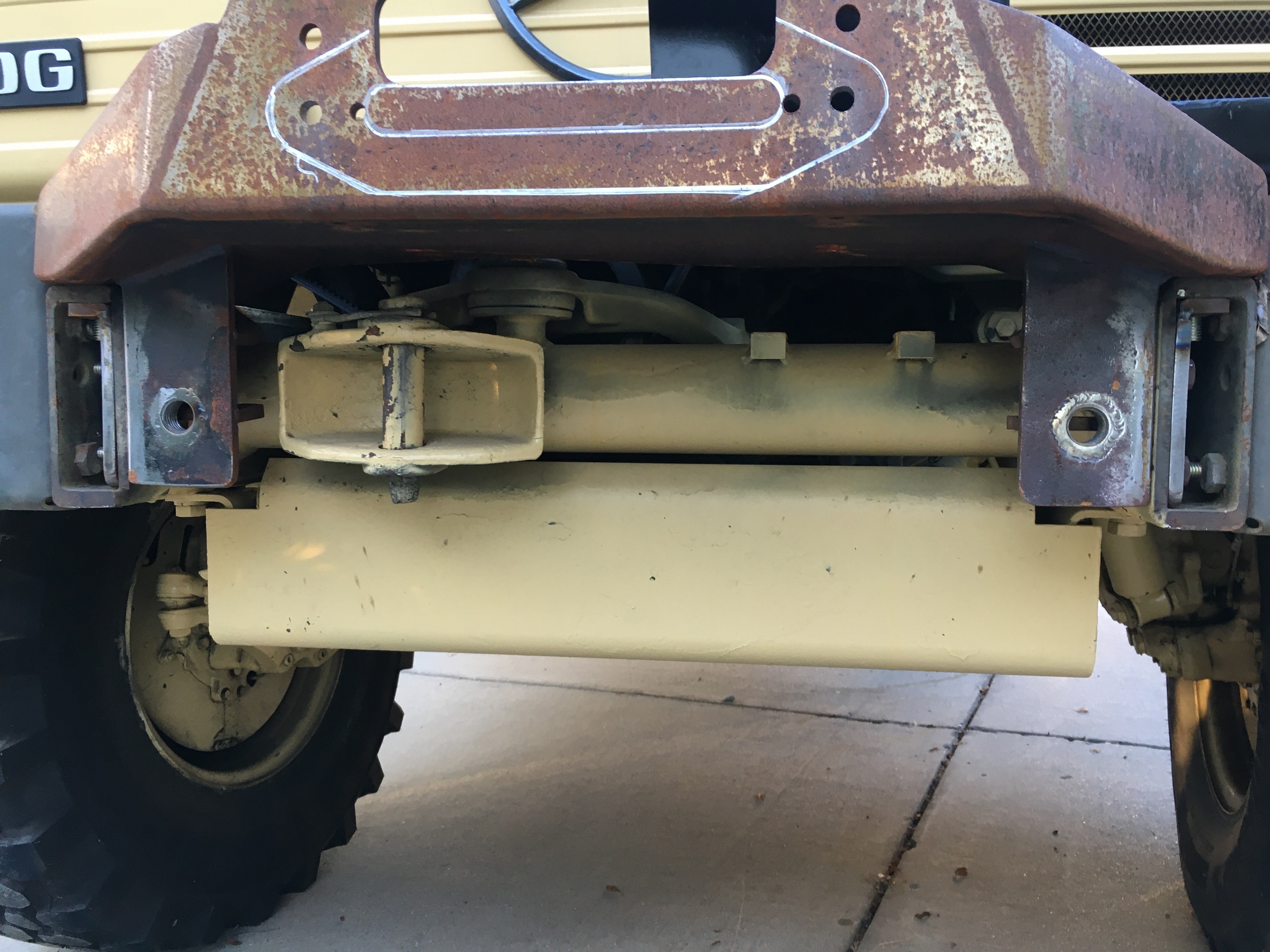

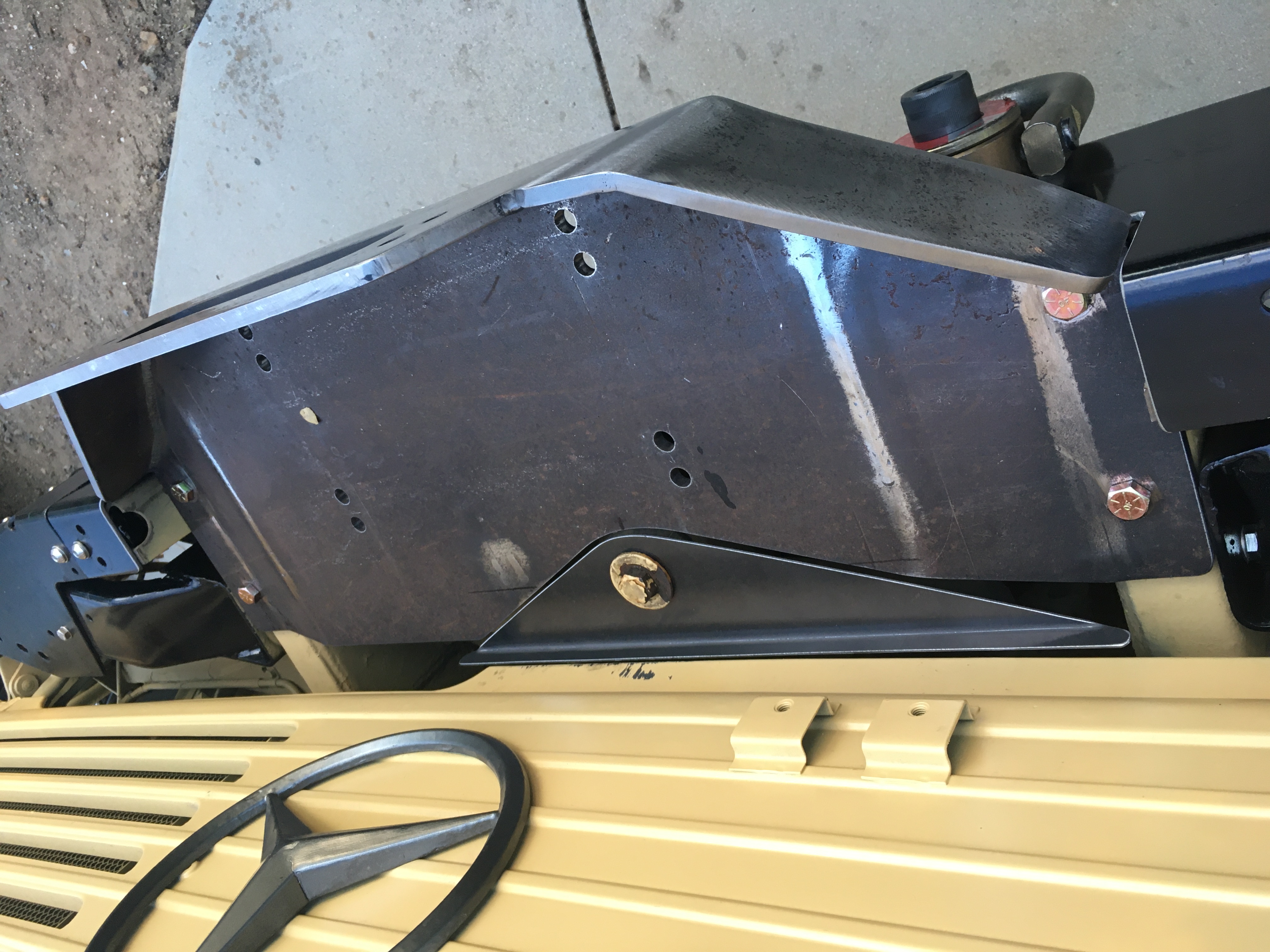

Design work on the front winch mount.
The holes on each lower side are threaded bolt holes for the swivel shackle recovery points, allowing any-angle anchor points that typical bow shackles don't allow for. They are actually rated at full working load even at 90 degrees!
The white chalk lines are where I'm plasma cutting the rest of the plate out for the larger industrial sized fairlead.

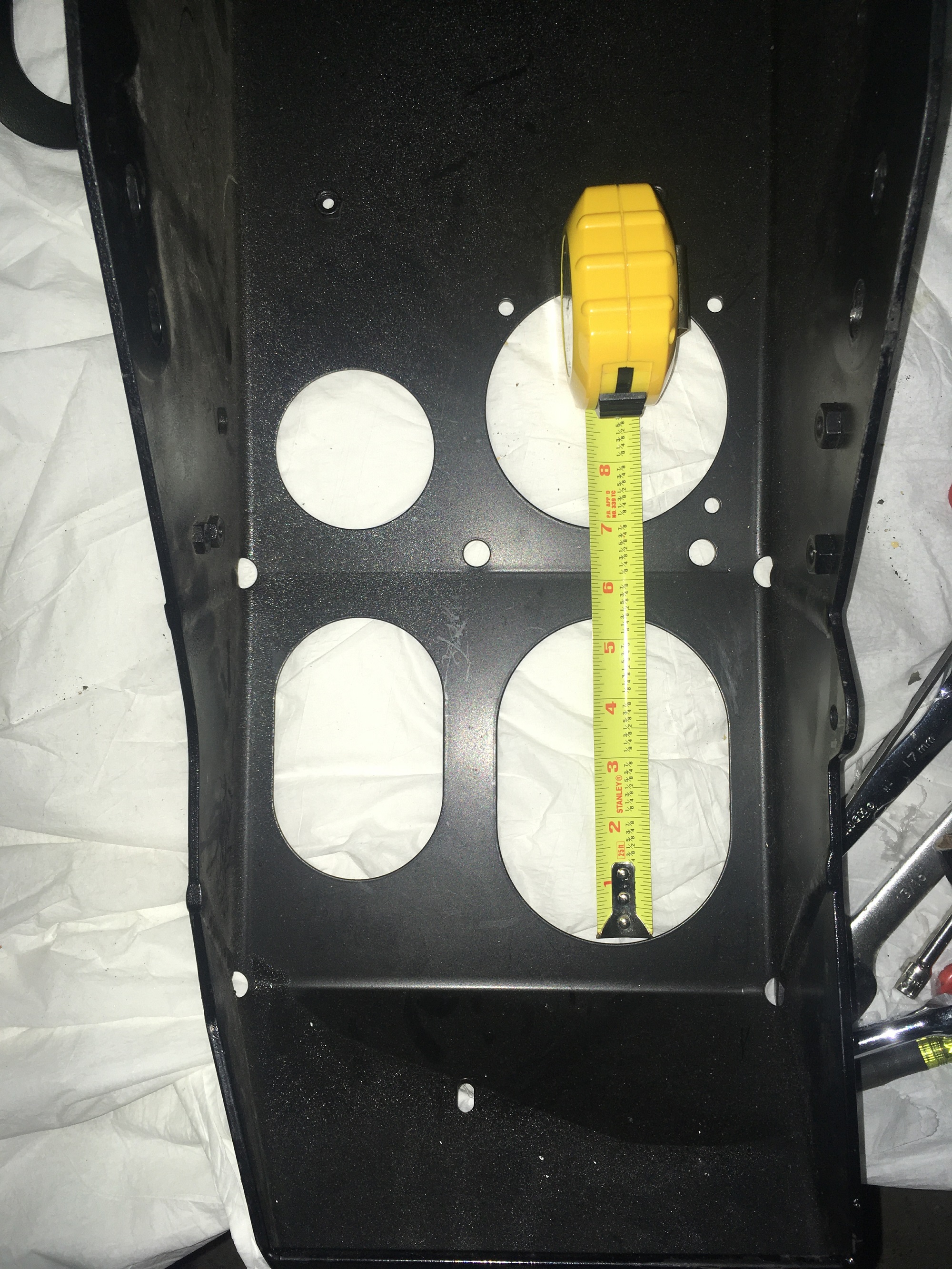

The awful, useless original headlights are going away. I'm custom building the new headlight/lights into new Unimog bumperettes.
Lots of fab work involved. All I got was the outer pieces which were taken off a 2022 model, no brackets or light mounts.

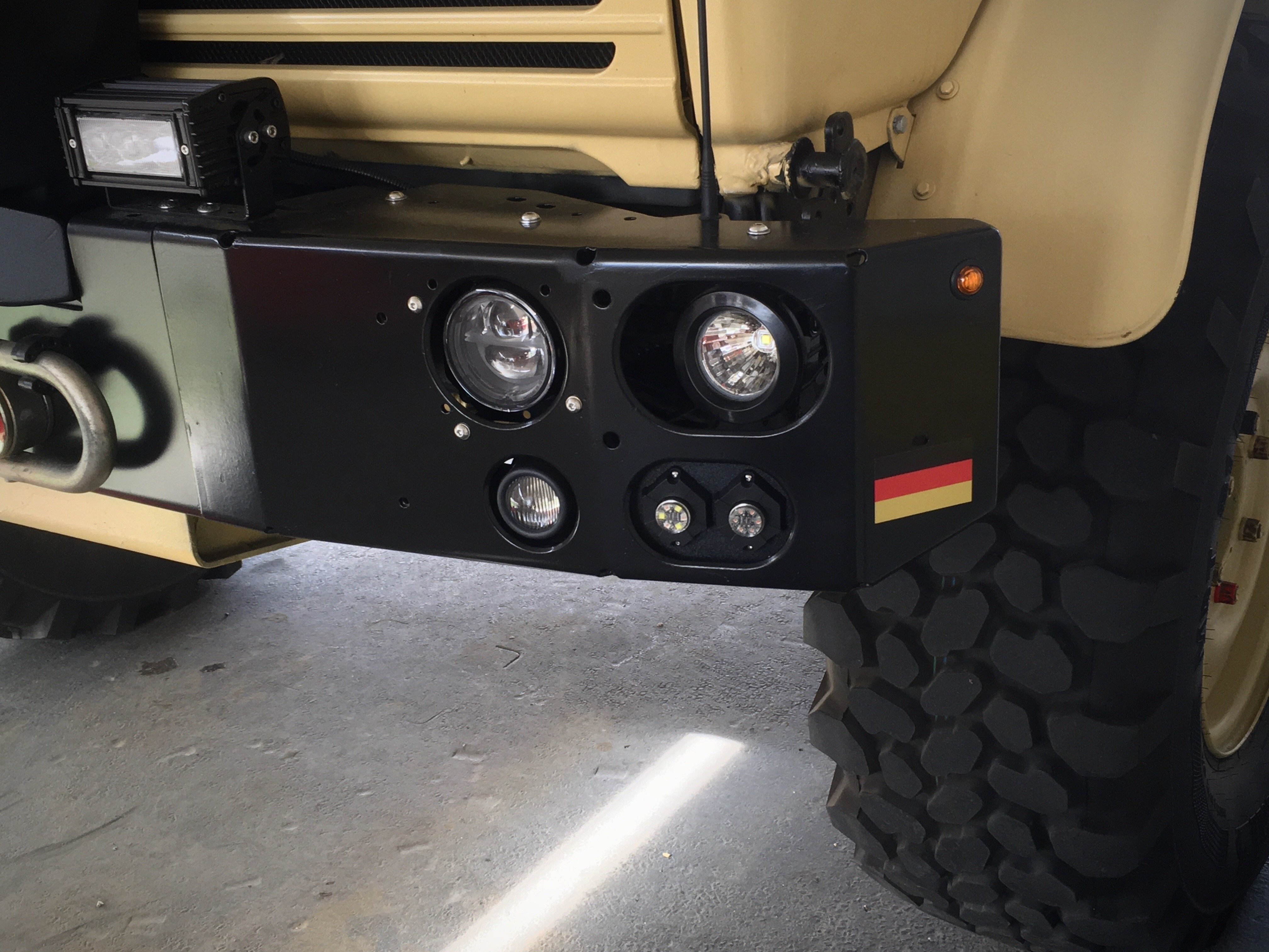

With no budget, it took endless months and a ton of custom work since I made it up as I went along, but my headlights/fog etc are done and working!
In case anyone is curious, the headlight is a multivolt Morimoto 90mm, beside that is the high-beam VisionX LED, under those are the Hella DE fog light converted to LED H3, then the two little lights are white and amber warning flashers.
On the right outer edge is the mini marker LED from Peterson, and the rectangle light over to the left is a Tomar LED white driving and switchable amber fog 2-in-1 light.

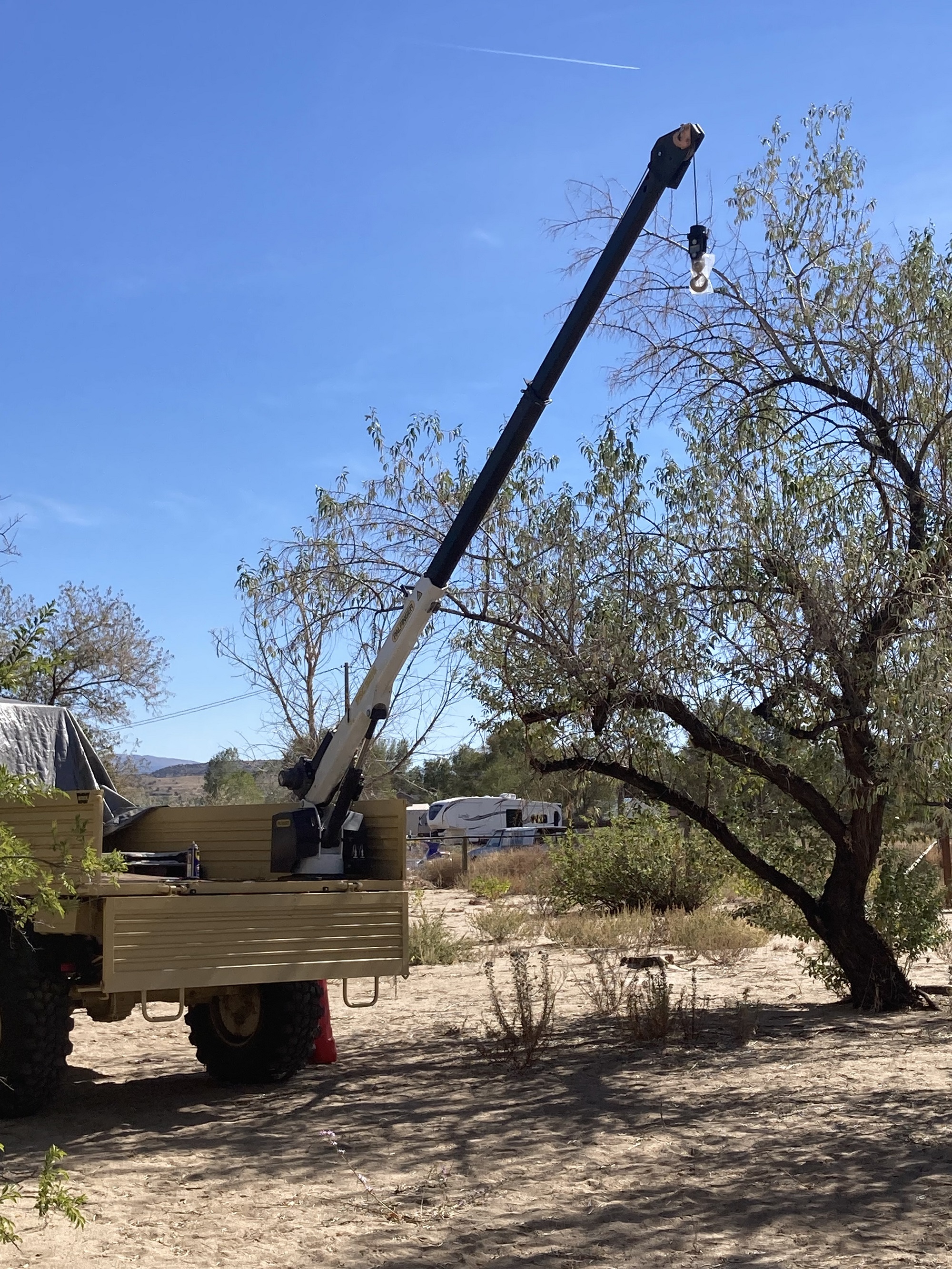

Did I mention the crane is installed now too? :D

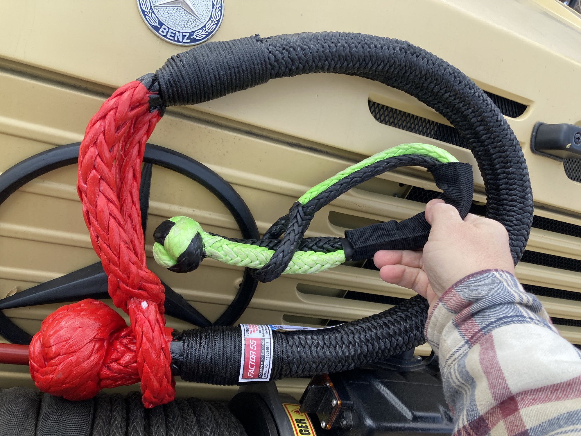

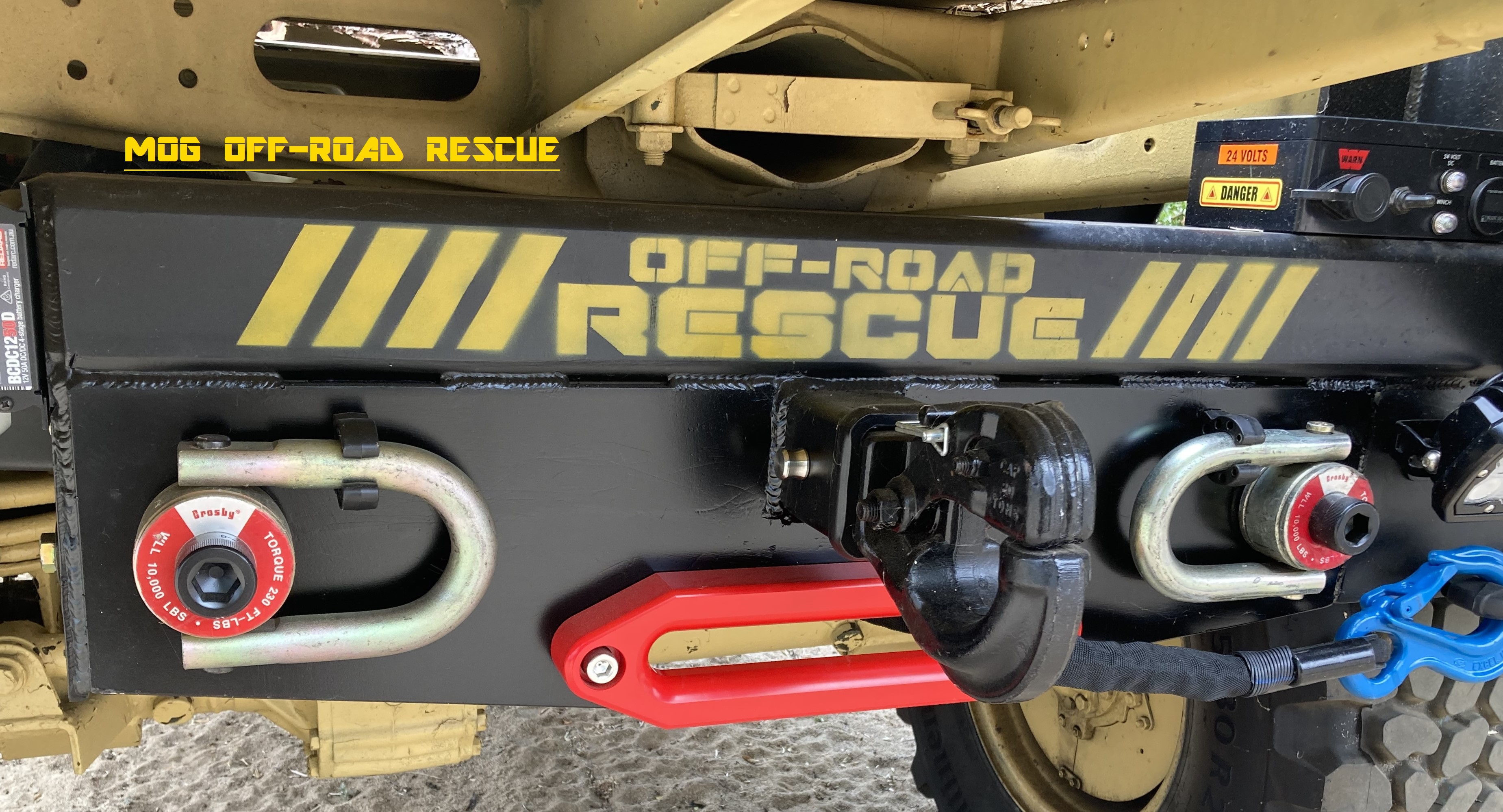

What most medium and full size 4x4's use for a soft shackle is in the middle. That's a 7/16" rated for loads around 10K lbs. (breaking around 45k)
The red one is a heavy duty version that I carry. Breaking strength on that one is 102,000lbs. Should get the job done on those heavier duty rescues. :shock: :lol:

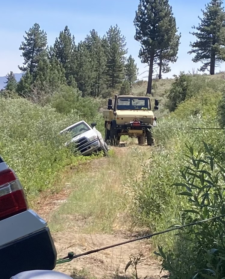

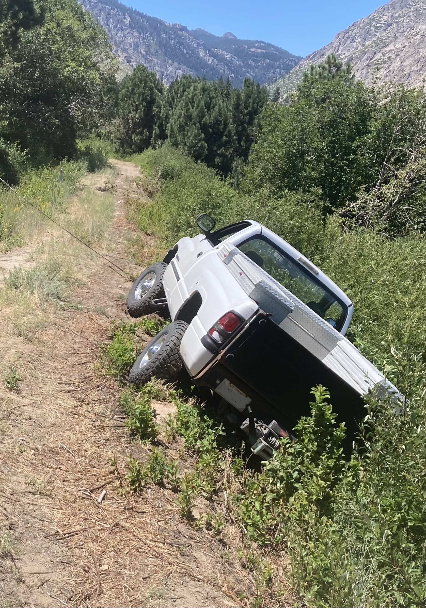

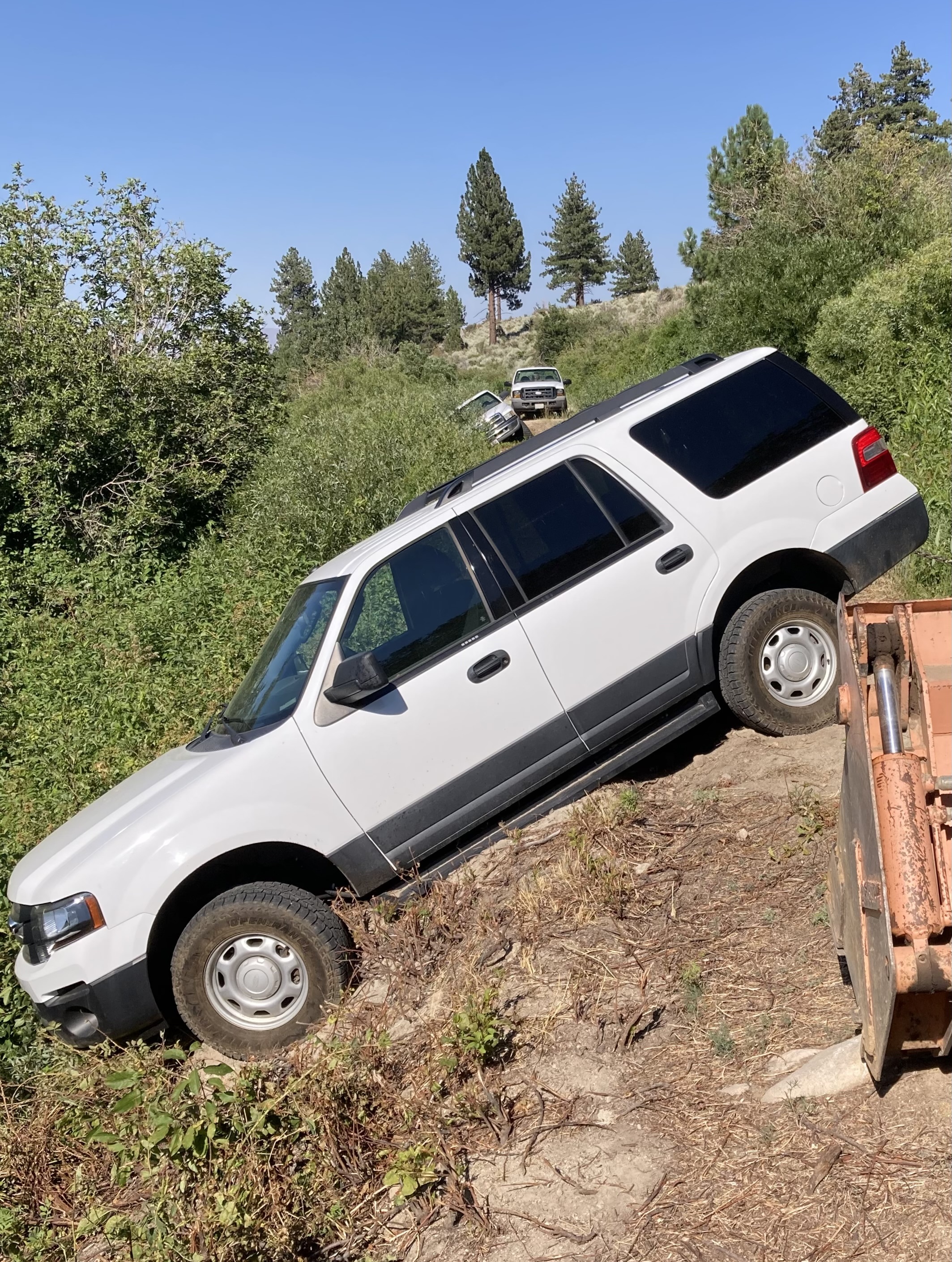

The photo does no justice to how dangerous this was. The drivers were very lucky!
Got a call to rescue two Gov. agency owned 4x4s that had been stuck like this for 2 weeks, after they had spent a full day of attempts to free them using a backhoe and a loader, breaking several straps and got very nervous. There was a 150ft drop on the steep side and about 5-6ft drop on the other with a creek. Road was about 9.5ft wide total. I used a snatch block, dyneema rope extensions and the front Warn 18K lbs winch to bring both vehicles back up.
I wish I had better pics/video but I was way too busy to get much of anything.
