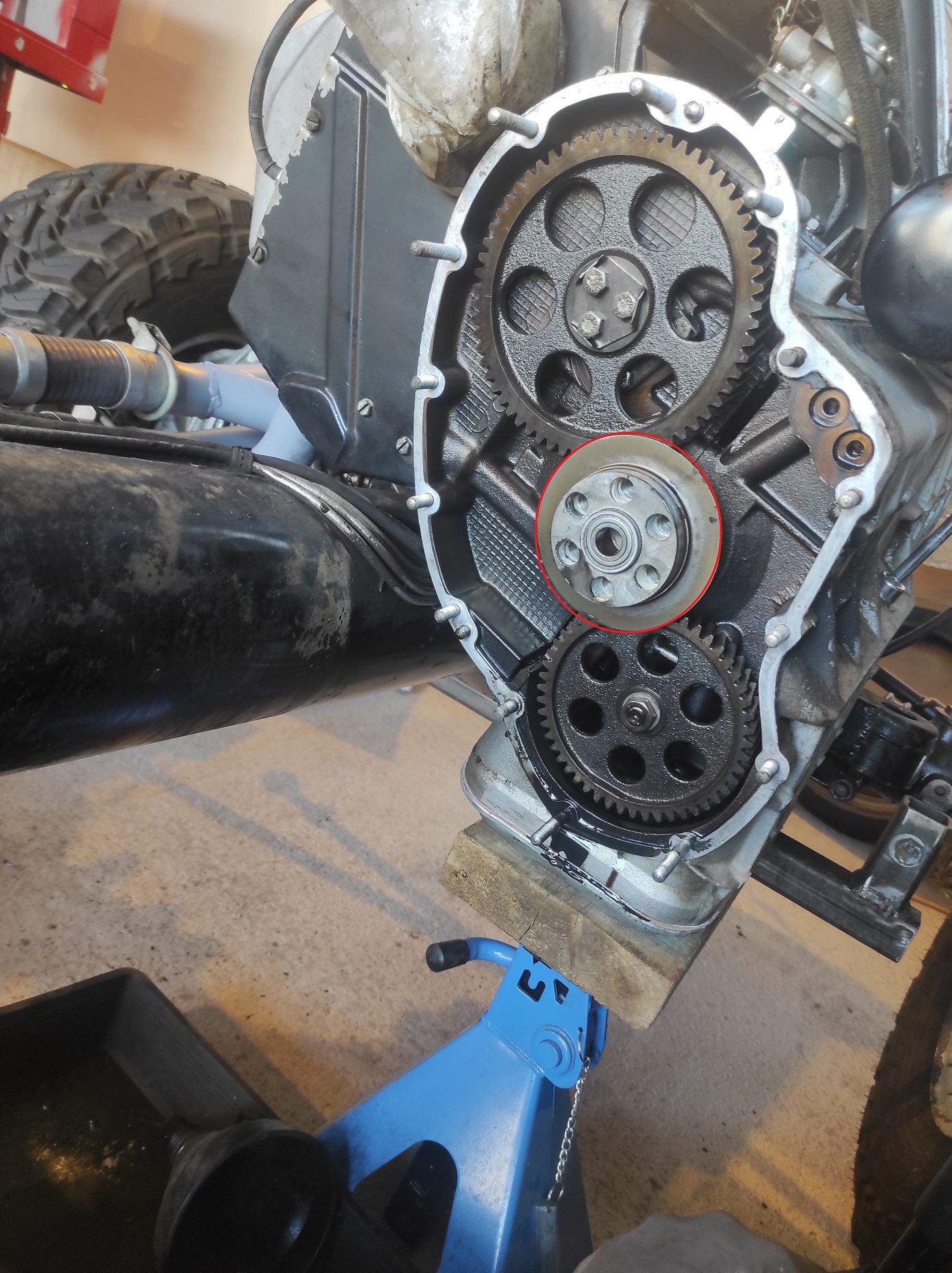

I've had a slow drip at the bell housing weep hole for awhile. No signs of drainage down the side of the engine, so tonight I pulled the transmission to try to determine if it's the transmission input shaft seal or the rear crankshaft seal. Signs point to crankshaft seal.
Q: How hard is it to remove and replace that crankshaft seal once the flywheel is off?
Color points to it being Rotella 15W-40 engine oil versus the relatively pink MT-90 that's in the gearbox. I can't get much smell from the sample in the bell-housing, so that also points to engine oil, not gear oil.
Pictures below. More if people think it'll help confirm the culprit.

Does anyone have a photo of the area where the seal goes with the seal not in place?

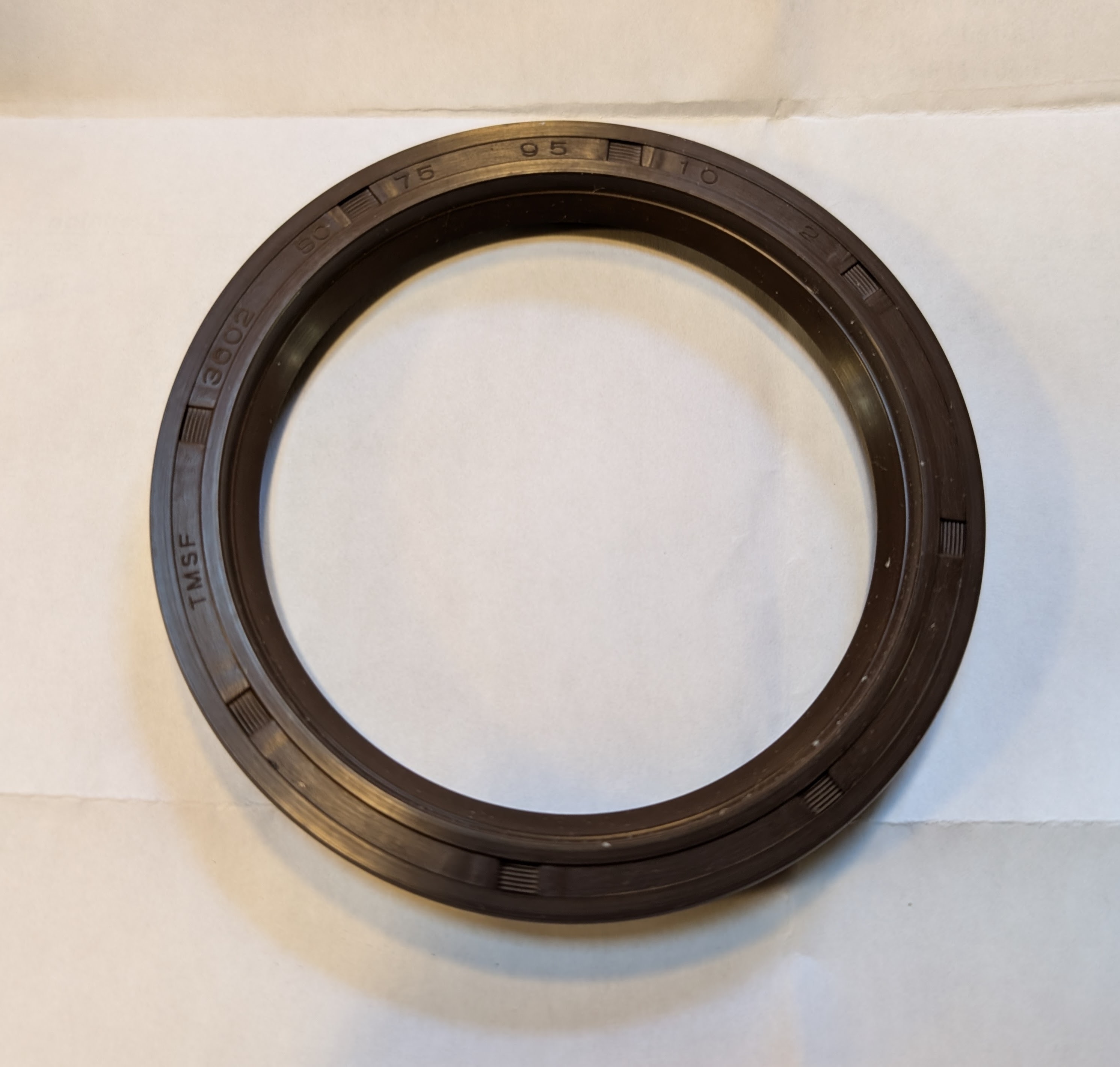

The front seal is a SKF 75mm x 95mm x 10mm HMSA-10 RG. These are dual lip. One to retain oil the
other prevent dust/grime ingress. Once removed the gap from the outer seat edge to the crank flange

I'll pull the flywheel in the next couple days and see how things look behind it. I picked up an induction heater for the bolts. Last time I used a torch and it definitely wasn't a fast process. It's partially an excuse to buy a new tool.
My biggest fear is that it'll be unclear if the leak is from the crank seal or the cam cover. All is TBD pending flywheel removal. I'll first photograph it and then clean it up before digging into the crank seal which arrives tomorrow along with the new bolts.
I ordered the Lisle 58430 - Lisle Seal Puller to give a try -- that's my first strategy. And I agree, that it makes sense to remove the rubber & tension spring beforehand. If that fails, I'll try other hook methods.
I've also mused about tack-welding onto the seal surface as a somewhat last resort. And I agree that drilling would be risky unless one could be certain that it wouldn't introduce any shavings into a place they couldn't be removed from with 100% confidence. I'm also tempted to use Freon to shrink the seal to loosen it.
Thanks for the extra notes!

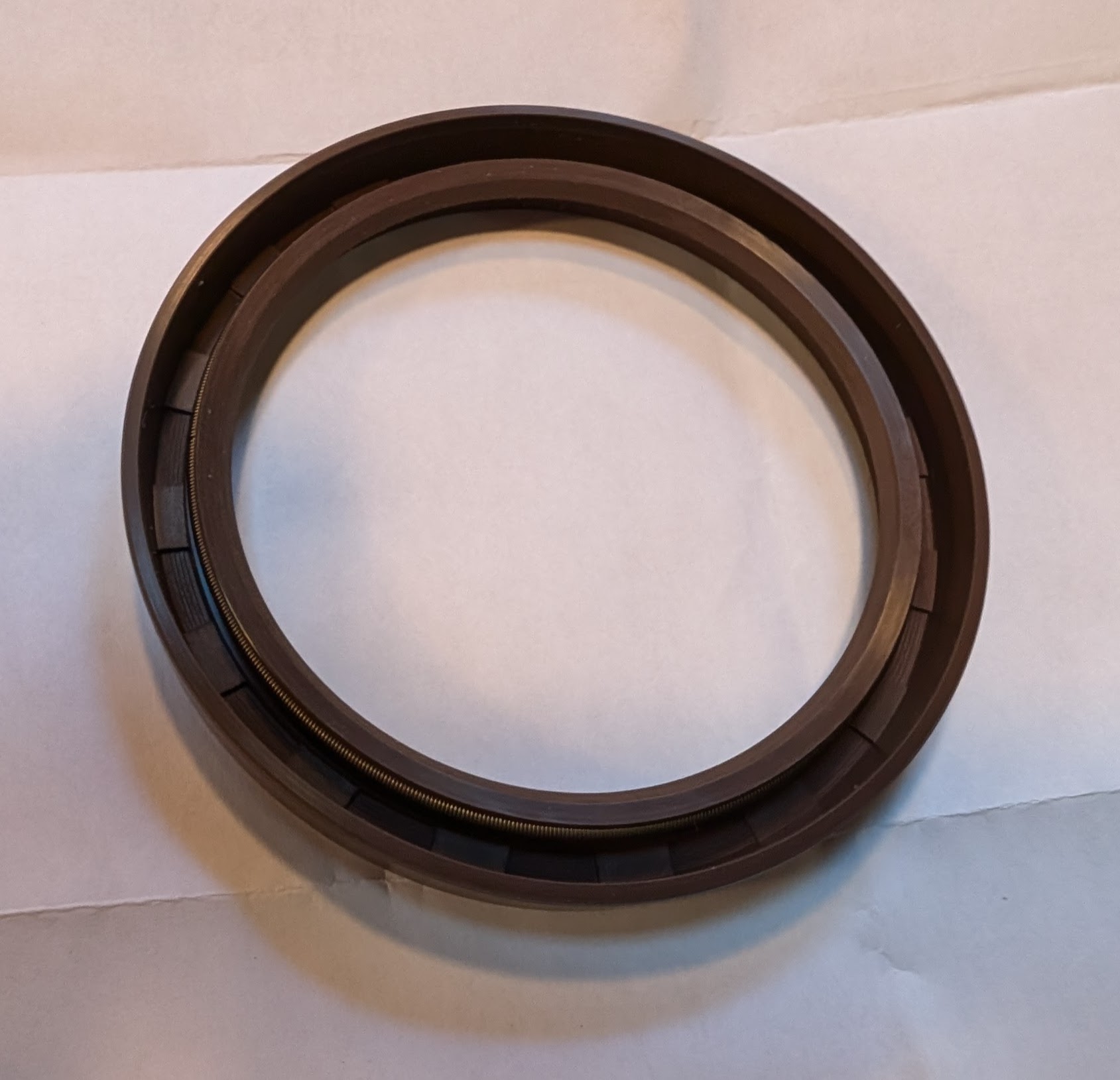

For the curious, this is what the new rear main seal looks like. A magnet confirms there's ferrous metal under the plastic exterior.

Flywheel's off. No bolt heating required. Used DeWalt DCF899H + 5Ah battery.
Bottom of the seal is wet, and the rest of things look dry (see photo), so I'm going to pronounce the seal as the source of the leak. And I see a drop of oil hanging on a casting boss on the right just to the left of a large nut, further incriminating this seal.
I'll try the Lisle #58430 puller first.
