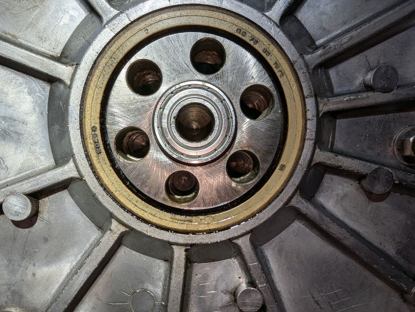

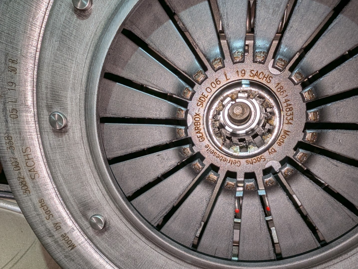

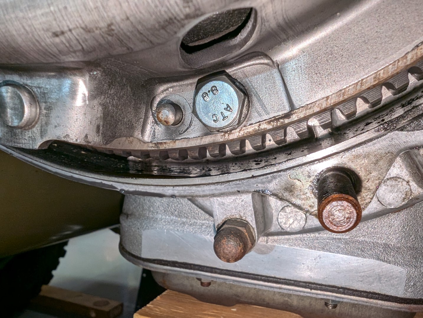

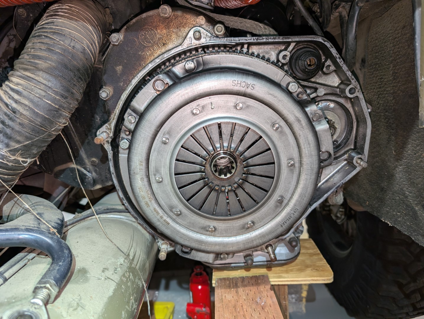

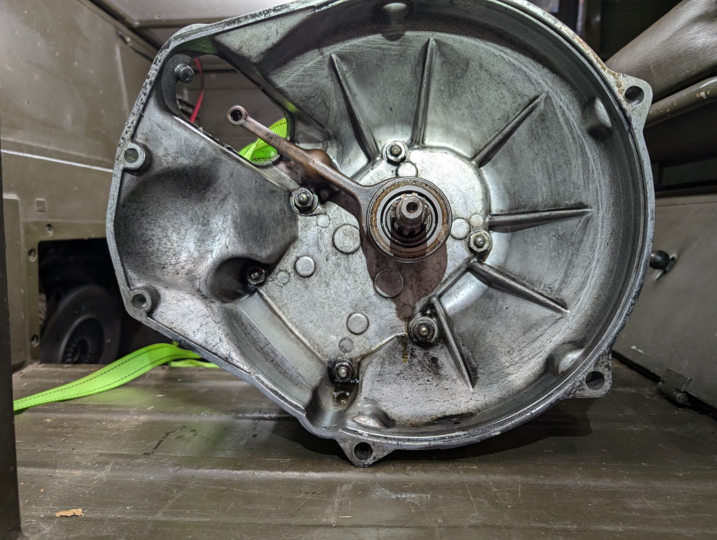

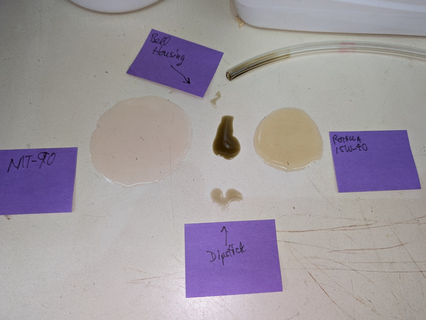

I've had a slow drip at the bell housing weep hole for awhile. No signs of drainage down the side of the engine, so tonight I pulled the transmission to try to determine if it's the transmission input shaft seal or the rear crankshaft seal. Signs point to crankshaft seal.
Q: How hard is it to remove and replace that crankshaft seal once the flywheel is off?
Color points to it being Rotella 15W-40 engine oil versus the relatively pink MT-90 that's in the gearbox. I can't get much smell from the sample in the bell-housing, so that also points to engine oil, not gear oil.
Pictures below. More if people think it'll help confirm the culprit.

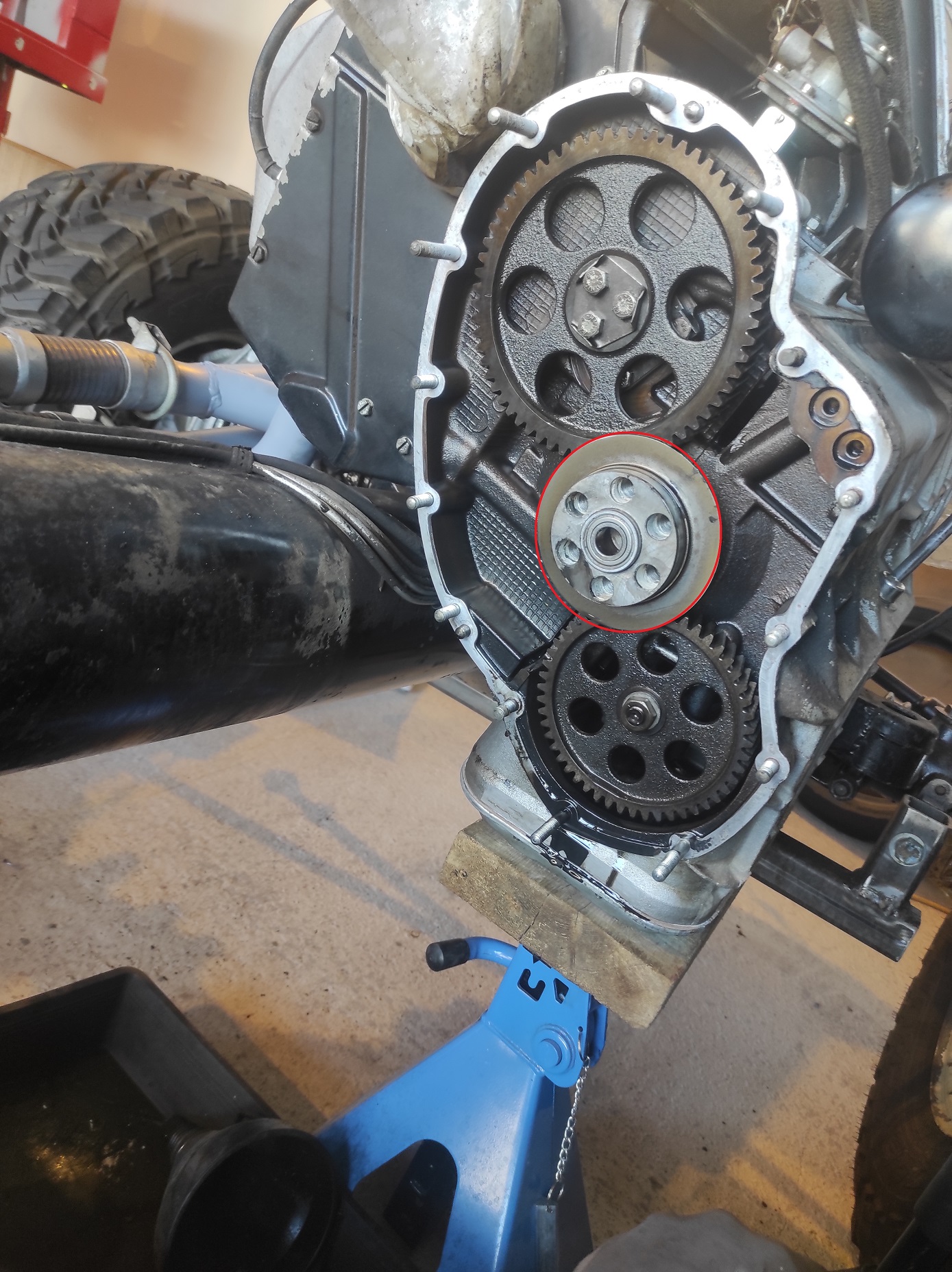

Had to think about this one :// Although I've done this a few times,
I've always pulled the Valve Timing Housing off as well since there
were leaks near the starter motor due to the stress in that area.
So...when you pull the Housing off, the rear main seal comes with it.
That makes replacing a wee bit easier -but- then dealing with re-sealing
the housing a much bigger job.

Thanks for the insights. I'll pull the flywheel and see how things look. Sometimes it's tricky when something's been leaking for a bit to figure out where the oil might be coming from.

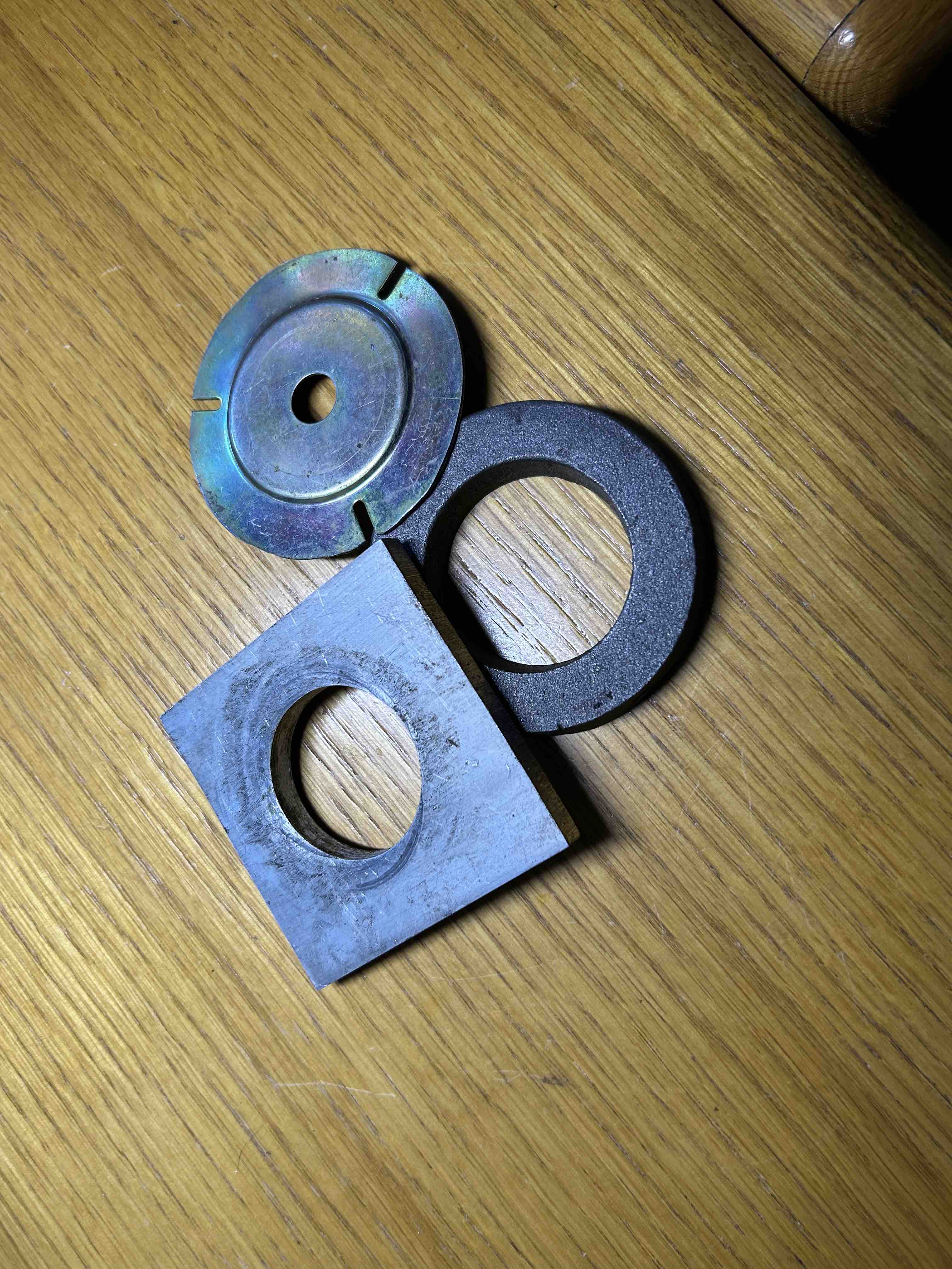

Found the "Installer" :roll:
Collars I used to "crank" in the front seal. More or less shims
with a thick Aluminum plate I placed a washer on and used
the threaded front crank to screw in place square. I don't
see why these can't be used with a rubber hammer to nudge
the rear seal in place.

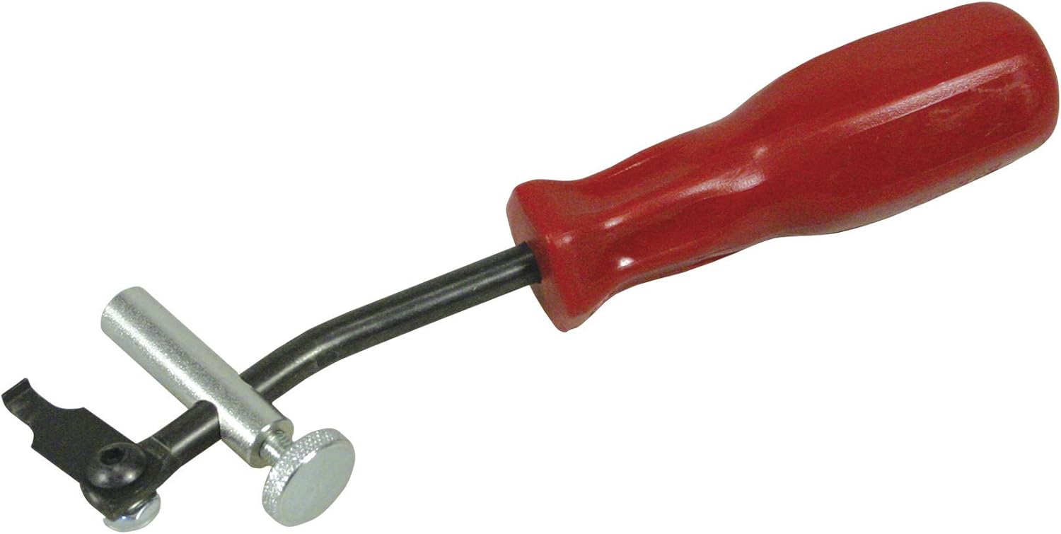

I ordered the Lisle 58430 - Lisle Seal Puller to give a try -- that's my first strategy. And I agree, that it makes sense to remove the rubber & tension spring beforehand. If that fails, I'll try other hook methods.

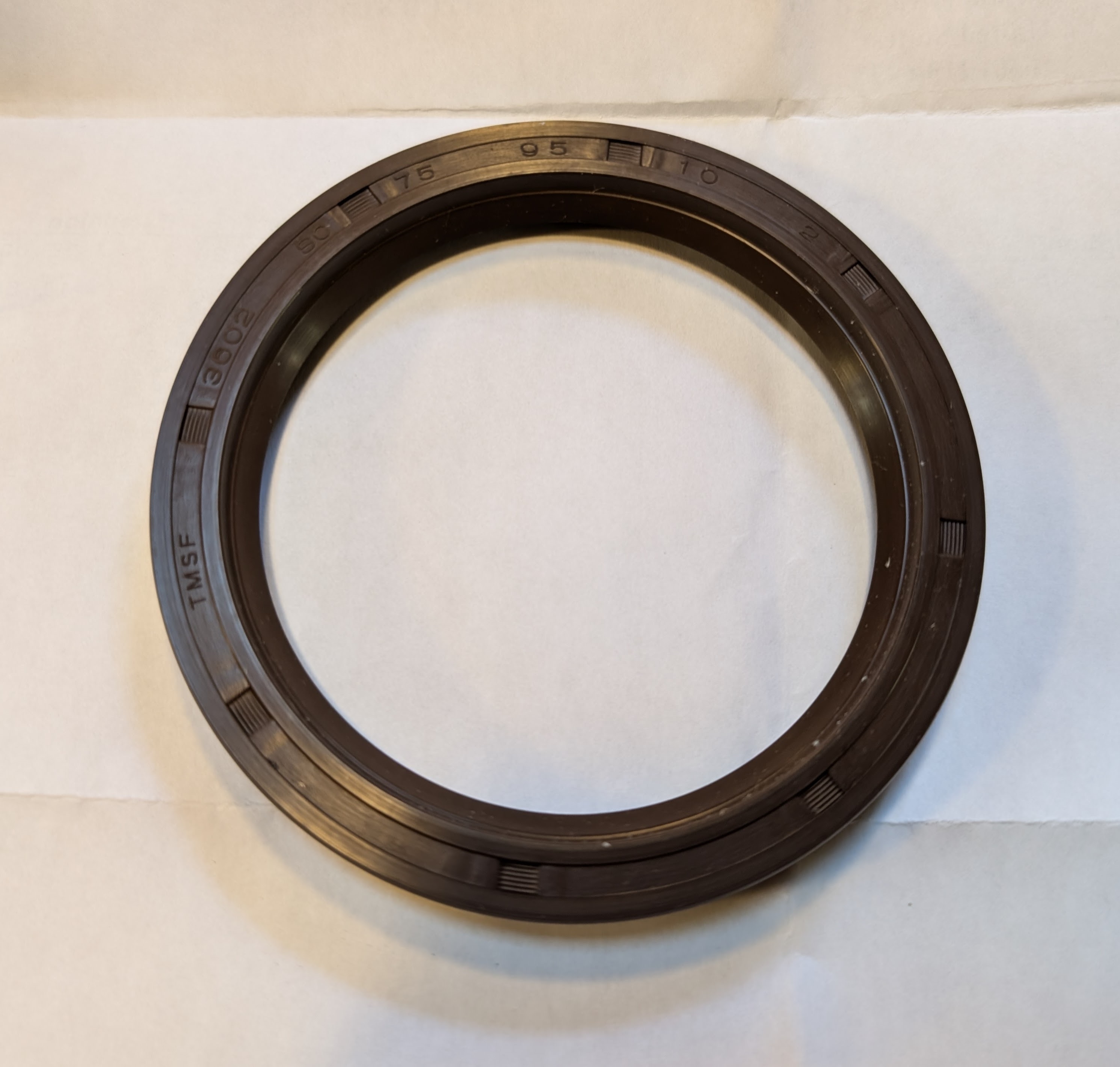

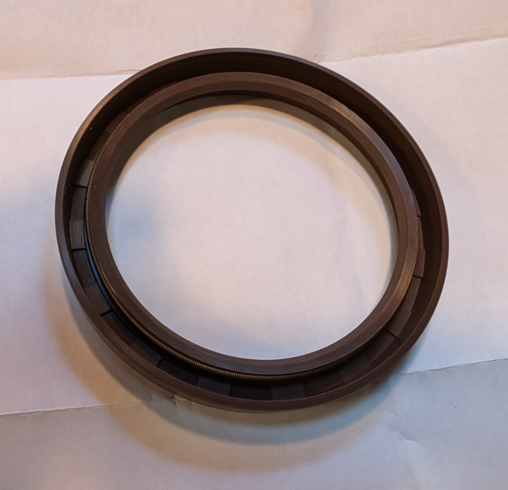

For the curious, this is what the new rear main seal looks like. A magnet confirms there's ferrous metal under the plastic exterior.

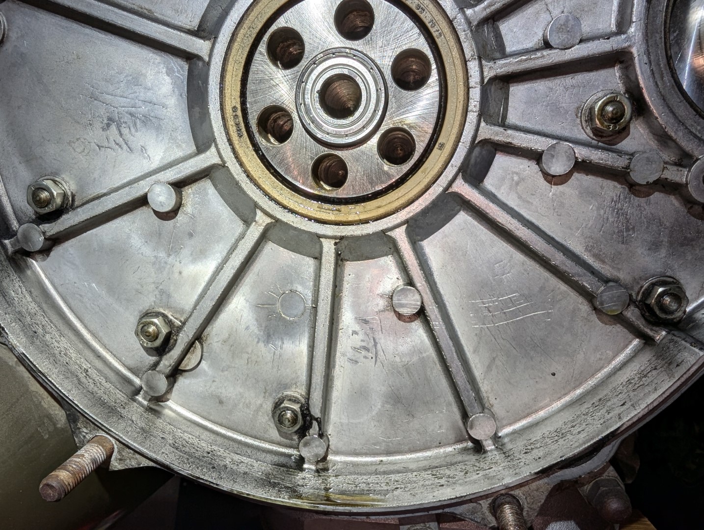

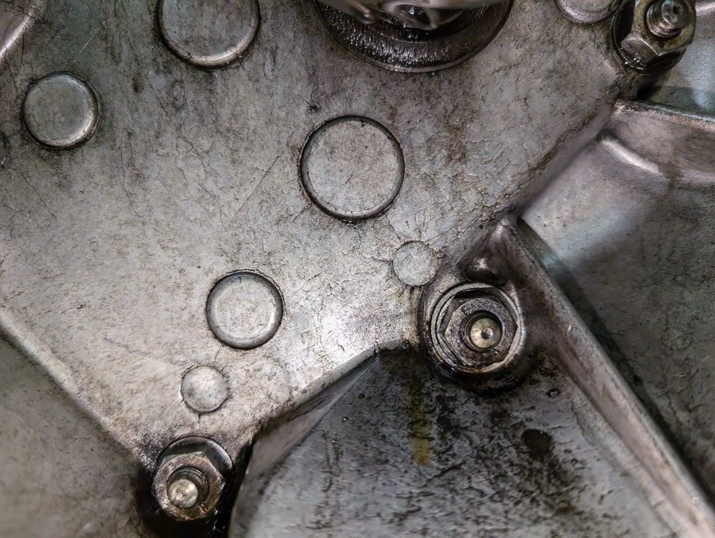

Flywheel's off. No bolt heating required. Used DeWalt DCF899H + 5Ah battery.
Bottom of the seal is wet, and the rest of things look dry (see photo), so I'm going to pronounce the seal as the source of the leak. And I see a drop of oil hanging on a casting boss on the right just to the left of a large nut, further incriminating this seal.
I'll try the Lisle #58430 puller first.

I would recommend replacing the timing cover gasket (7101010141) as well.
This is a simple task and you don't need to purchase any additional tools to remove the rear main seal when you take the cover off.
Remember that there is an additional metal cover/thrower (7101020201) on the crankshaft. Just be careful not to damage it when removing the rear main seal.
