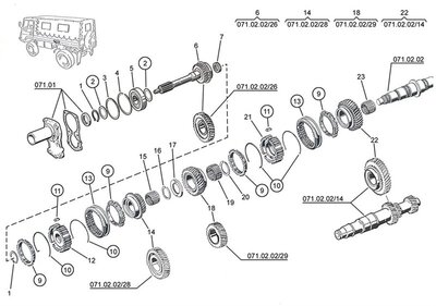

My manual 710M gearbox is making noise in 5th gear. It's been like this since I bought my Pinz 2 years ago. Not getting worse, just looking for my options.
The other gears don't make noise, maybe a little in 4th.
Can this be fixed by changing some components ?
I'd like to do the job myself this summer, during a 2 week vacation.
Do I need special tools to replace the problematic components?
Can I "risk" buying the parts I need before actually opening my gearbox? (to reduce downtime)
Should I take the opportunity to replace more parts of the gearbox?
It's not entirely clear from the picture below which parts are involved in 5th gear.
Taken from here:
https://www.puch.at/en/products-&-spare ... ive-shaft/
Or is it here instead?
https://www.puch.at/en/products-&-spare ... ntershaft/
This is all new to me, but willing to learn.
Taken from here:
