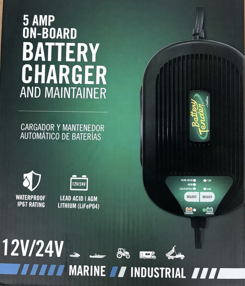

Any possible issues using this on my two 12v NATO batteries in the Mog? I was tired of swapping my trickle charger over and got one of these 24v versions a while back (via a heavy discount on ebay)
- s-l960.jpg (154.54 KiB) Viewed 3680 times
