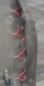

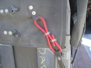

Just a pic to show how the cord and clamps from McMaster look. They have the cord in a couple other colors, including black, but I like the looks of the red.

Can you post some part numbers please ?

3961T4 - 7/32" cord
3961T3 - 5/16" cord
54285K23 3/8 to 7/16 pinch clamp
I browsed the website and picked these from memory, I'll verify against my invoice tomorrow (it's at work). They list 4 sizes of cord, I ordered 1 foot of each for comparison and liked the 2 above sizes the best. Color choices are red, blue, black and yellow. I froze my samples for 2 days, pretty stiff but no cracking when pulled, and they return to normal stretchiness when thawed. Only time will tell on sun exposure resistance. The smaller size works nice for the split sides on a 712M.

I checked the invoice, the pinch clamp I ordered is McMaster #54105K37. $8.78 for a pack of 25. They work fine for both cord sizes.
