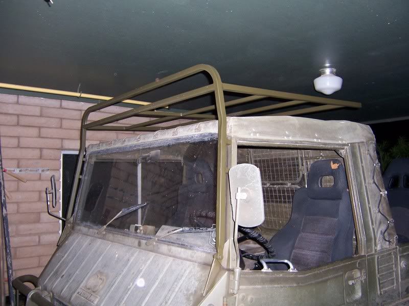

anybody have any??

A picture of the rack Andre did for our 710M is on the Yahoo groups CalPinzclub Pictures, Gonzaga Bay section. I was so nice to put most of the gear up top, leaving over half of the back free for pasengers, or just getting to stuff.
Surprisingly it was not as top heavy as I had anticipated, although it did rock more in all directions with weight up there. I'm figuring the rack and braces total about 300 lbs and we probably had 3-500 lbs of gear and firewood up there, too.

first decide what you are wanting to carry in the rack. Then find one similar to those commercially available and have it built. If you fab guy has any skills he will be able to fit it to the truck. You have it easy with a K type vehicle but on the M's the use of the antenna bases work well. The only problem is they require holes in the canvas.
If I were to do one for a K, I think I would incorporate the features of this rack
http://www.central4wd.com/inventorydeta ... er%7C45841
Easier to load and unload. This would be very simple to duplicate on a Pinz and still look sharp.
