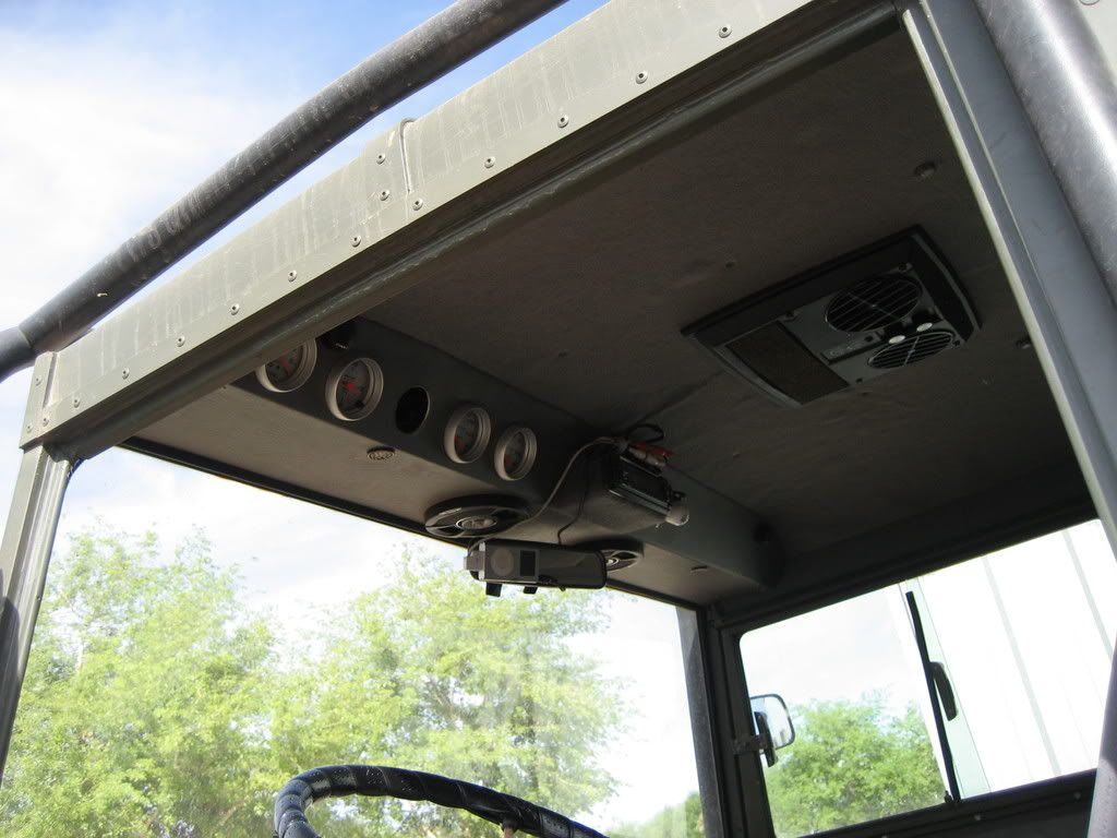

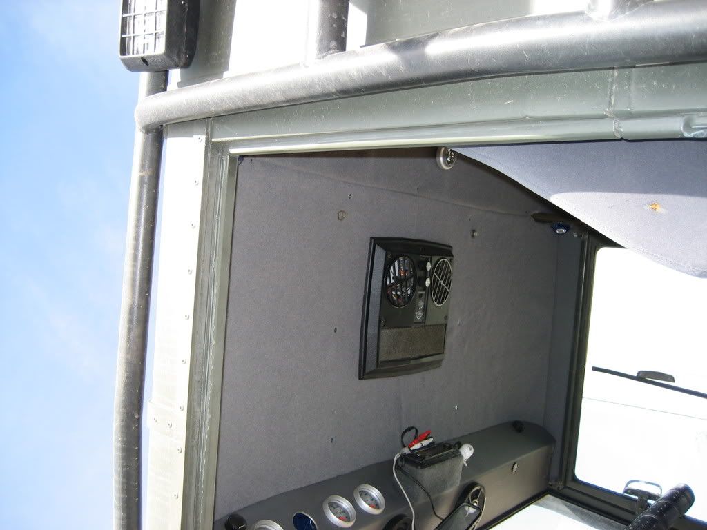

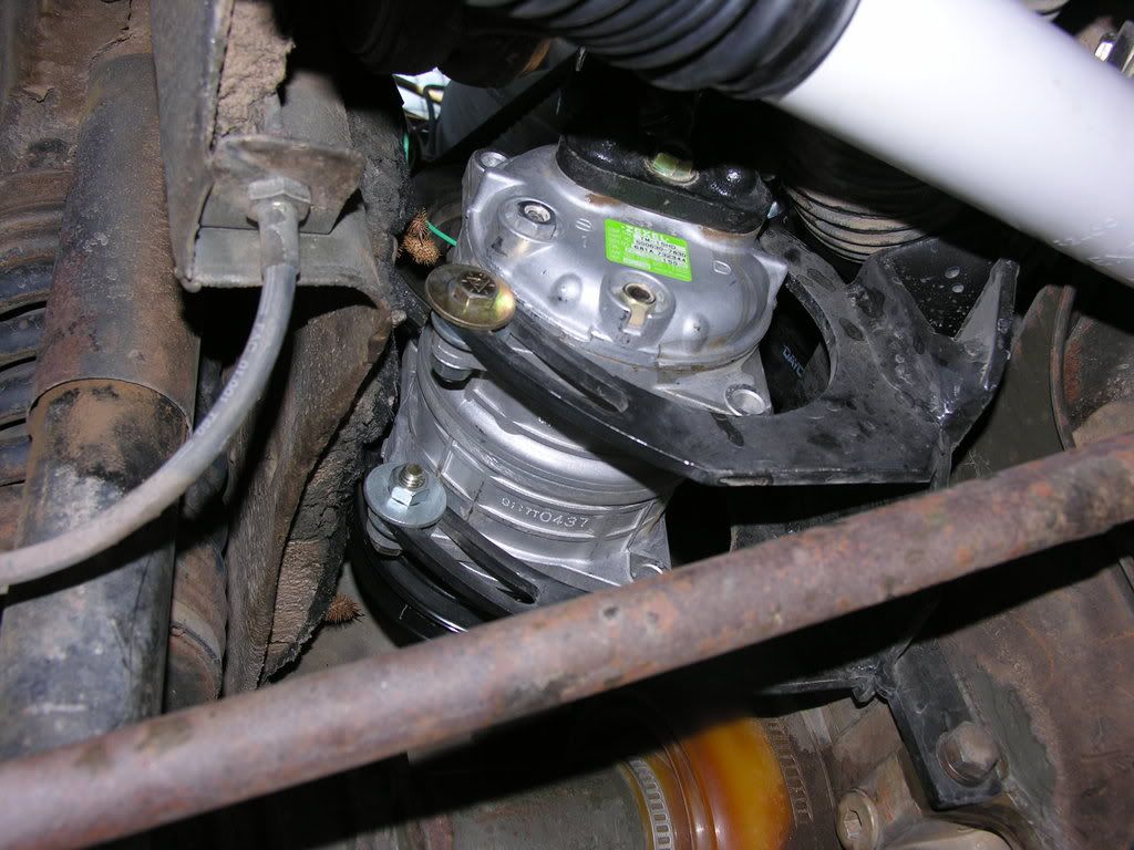

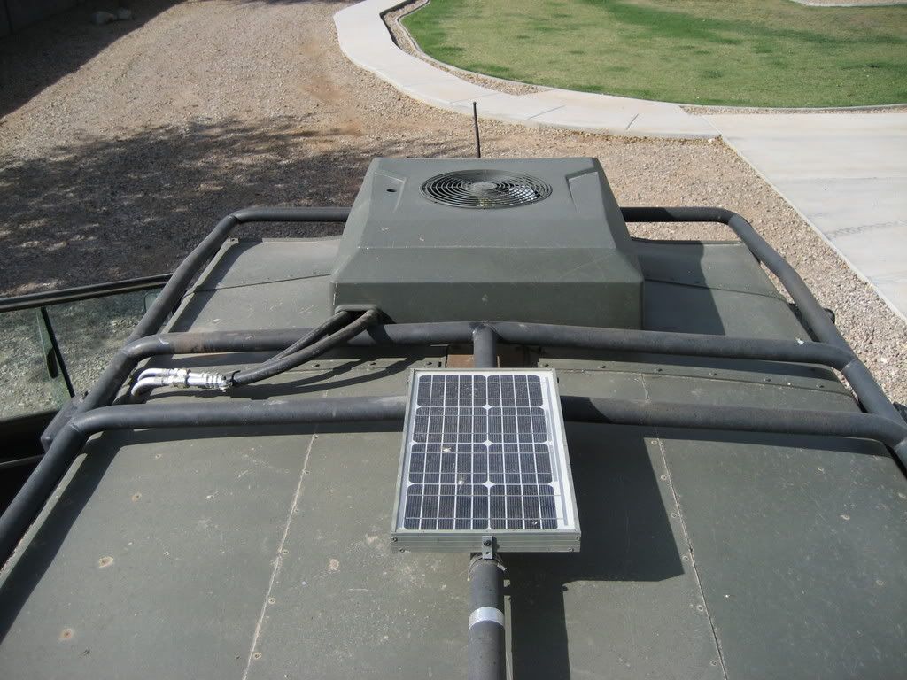

You are correct. None of the AC installs I have seen in the M's are addressing the rear area, only the cab. Mark's unit is run off the engine with a standard compressor on his current 712. The AC unit is mounted on the hard cab roof he has fabricated. I don't see enough power loss on the engine to be a negative thing, but then again we are not at any serious elevation. Having taken my pinz to several of the CO. treffens at altitudes exceeding the 12K level mark I can see where they would not want to loose even a minute bit of power. You also have to consider that they are not looking at temps nearing the 120 mark either so AC is not as big a factor, nice yes. Again don't want to squash any ideas. They can all be done just depends on how deep down in your pocket you are willing to go. I have found, at least here in AZ most of us are not afraid to spend money on making our trucks what we want them to be. I know this goes against the old school pinz crowds thinking that all pinz owners are cheap, I for one am offended by that statement, considering the amount of time and modifications done to my pinzies.
