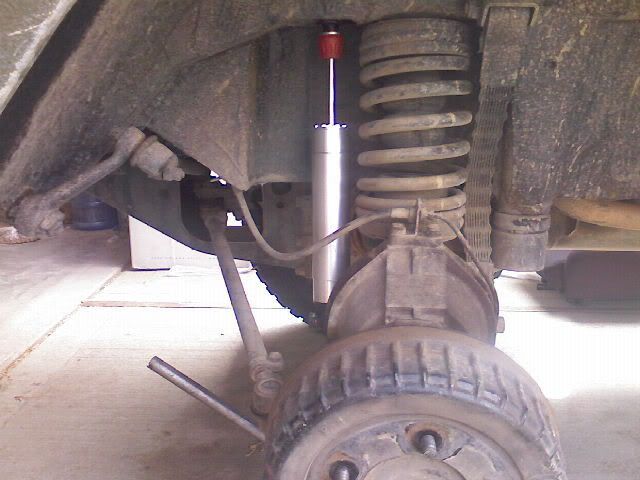

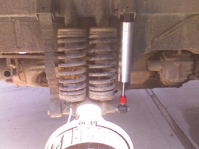

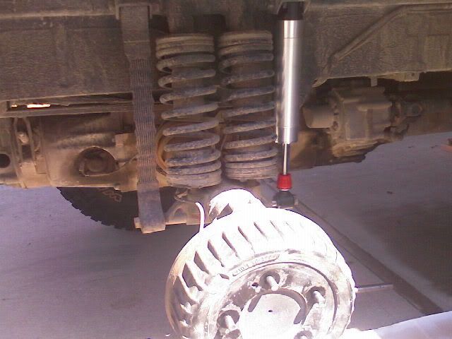

I recently installed a set of Doetsch (made for the Pinzgauer)shocks on a 710, what a nice test ride 8)
Here's a couple of shots.
By the way Scott at E.I now carries these in stock for immediate delivery at the same price as direct ordering from Doetsch(which takes 3-4 weeks).
They even come with stickers :D
Cheers, Jim LaGuardia

I spoke with the factory and they said that the shock is designed to be installed upside-down. In other words, the chrome rod points up. Jim, have you ever heard anything about this?
Posts: 1639
Pinzinator,
I ran into this same issue when I installed mine. The factory (Bobbi) told me they could be installed either end up. Due to the small access hole for the front upper body mount, the shock could only be installed with the chrome rod end up.
It's been over a year and they work fine. Just my experience. I'd be interested in Jim's and anyone elses comments too.

pinzinator wrote:I spoke with the factory and they said that the shock is designed to be installed upside-down. In other words, the chrome rod points up. Jim, have you ever heard anything about this?
I'm curious about this too. Many hydraulic shocks have an "up" and a "down" and they will lose some of their damping in one (or both) directions of travel, creating a "dead spot" in the shock's travel and adversely affecting handling. I've experienced this firsthand with a set of Rancho shocks, and can verify that it's important to not run shocks that are oriented the wrong way.
Many gas shocks are able to be run either end up, but it depends on how the valves are designed. If the Doetsch Tech shocks were designed to operate either direction, then it shouldn't be a problem. However - especially when a shock is designed for a particular vehicle - the compression and rebound damping are usually not the same. So proper orientation would be important to maintain if this is the case.
Can Doetsch Tech or Expedition Imports verify if there are different rates of damping for compression & rebound? And which direction these shocks are optimally oriented?
Posts: 935
Location: Indio, California
Post by pinzinator »
Given a choice, I would rather that they point up, that way they can be installed on all 4 corners. If installed normally they would be limited to rears only, if that is the proper direction. I have them in the rear, and was considering installing them up front when I made the call to Doetsch. Reversing the rears is easy. You can verify the proper direction at Doetsch by calling 619-442-7300, the reply I got today had been posted previously. I don't know the name of the woman.
