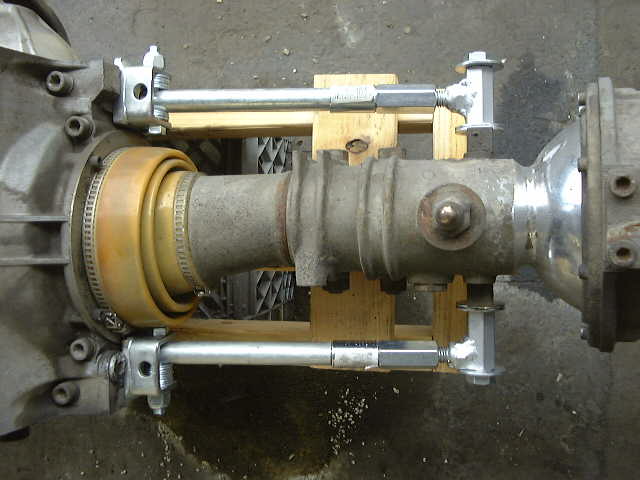

I've been trying to think of a feild repair for the shaft, but the only thing that comes to mind requires welding, grinding and a heavy gauge steel tube. It would be easier to just carry a spare. :roll:
For those of you that are breaking axle's, is it due to excessive rust in any way?
For pics on home made axle removal tool I made a while ago.Click Here
