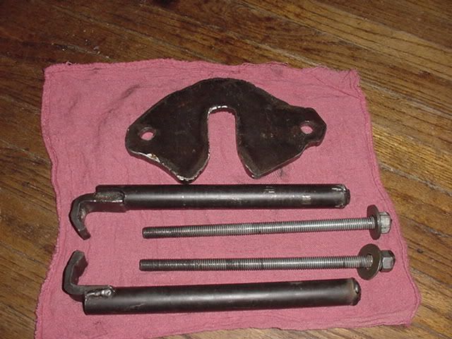

Jim LaGuardia wrote:Here is a couple pics of the first one I made, It is a modified version of the factory compressor(the original had a 2 piece base).
I will warn you not to use cheap quality anything when making a tool that can do major damage if not made correctly :!:
Cheers, Jim LaGuardia

I agree..springs under pressure are quite the bomb when compressed!
Thanks for the refresher pics!

Erik, the only spec you need to make the tool is 10 1/2". That is what the spring must be compressed to to be removed/installed.
All this is in the repair manual......................................... :P
