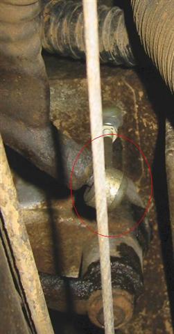

No need to remove long shifter arm.
Use screw drivers or pry bar to remove the other end of dog bone I have circled in red (note what end goes to what so you won’t need to readjust the rod).
Remove old bushings (suggest one at a time so as to insure you insert the new ones in the same direction as the old) and press new ones into place in dog bone I used a bench vice to press the warm bushings into the dog bone (soak bushings in hot water just before pressing into place).
Then take the dog bone with the shiny new bushings to the truck and begin the fun of forcing the dog bone ends over the balls. I used a variety of wood sticks as leavers to force the bushings into place.
If I remember correctly I did one from the top and the other while lying under the truck.
Let me know if elaboration is needed.
Ed

A big set of channel lock pliers or a big C clamp will re attach the rod ends in seconds :wink:

Thank you all so much! The problem is now fixed. The second bushing was also about worn out as well, so I'm glad i got more than 1! I was able to wiggle them both off by and, and pull the bushings out with pliers. Even soaked in hot water, boy were those hard to get into the dog-bone thing. I had to use a vice, a bolt, and adjustable pliers....but once they were in, I was able to pop them on into my truck all from the access plate only using a 2x2.
