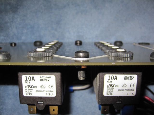

E-T-A made the original 8 amp circuit breakers and they now make a 24V 10 amp as a replacement for it that many marine supply companies sell. Sea Choice repackages it under their own brand as part #13111. Companies like West Marine, etc. carry them though i found the best deal on eBay. There are a few listed on there now- here's one: http://cgi.ebay.com/ebaymotors/SEA-CHOI ... 1083wt_941

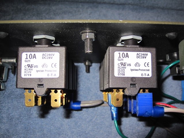

I've used these and they work fine but unfortunately won't mount the same way as the originals. They have a threaded neck that fits thru the original holes but won't fit the original bracket. I ended up replacing all of them at once. They also have spade terminals rather than screw type so you'd need to crimp on some new female terminals to the existing wiring. Probably took me 2-3 hours to do working at a slow pace with a few breaks. Not a hard job, just tedious. Here's a shot of the finished project:

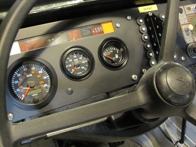

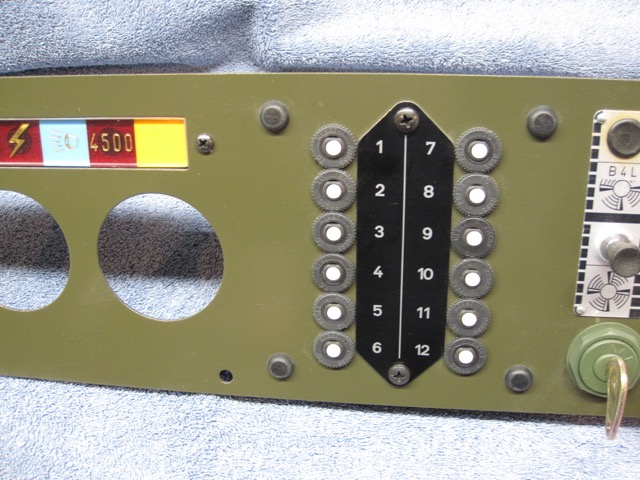

I've been working on a second dash re-wire for about a year now :oops: , so here are some current photos:
The plastic nuts on the cb's bump into each other so you need to start at the top or the bottom of each row and work your way along tightening carefully as you slide them into each other. I hope this makes sense.
