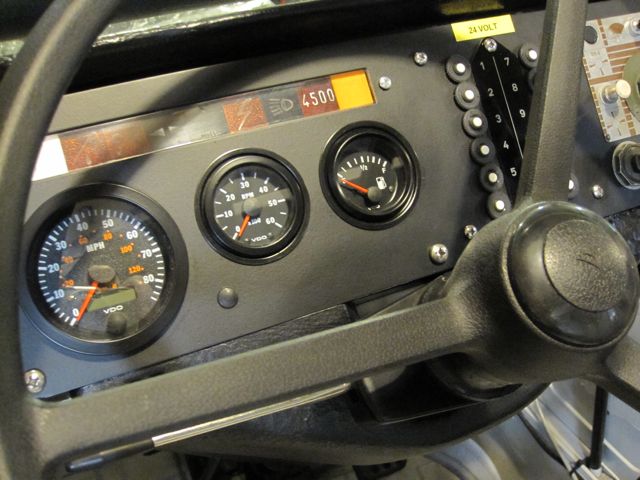

Does anyone know where I can get new lenses for the in-dash indicator lights - turn signal, E brake, brights, 4500 rpm, etc.
Mine have holes burned in them, probably due to using wrong bulbs.
SAV only has a blue lens. Can't find them on other supplier's sites.
Since they are apparently just little plastic squares, there may be some sort of shade tree work-around. Anyone have any experience with these?

When I first got the pinz the 'plates' were very faded but no holes or burns. I checked out the prices for new ones
and then went to a hobby store and got glass paint, the type that you would paint designs on glasses with (light
shines right through) and then removed the plates and painted them the colors that appealed to me. Total cost was under $5.00.
http://s400.photobucket.com/albums/pp88 ... MG3460.jpg
