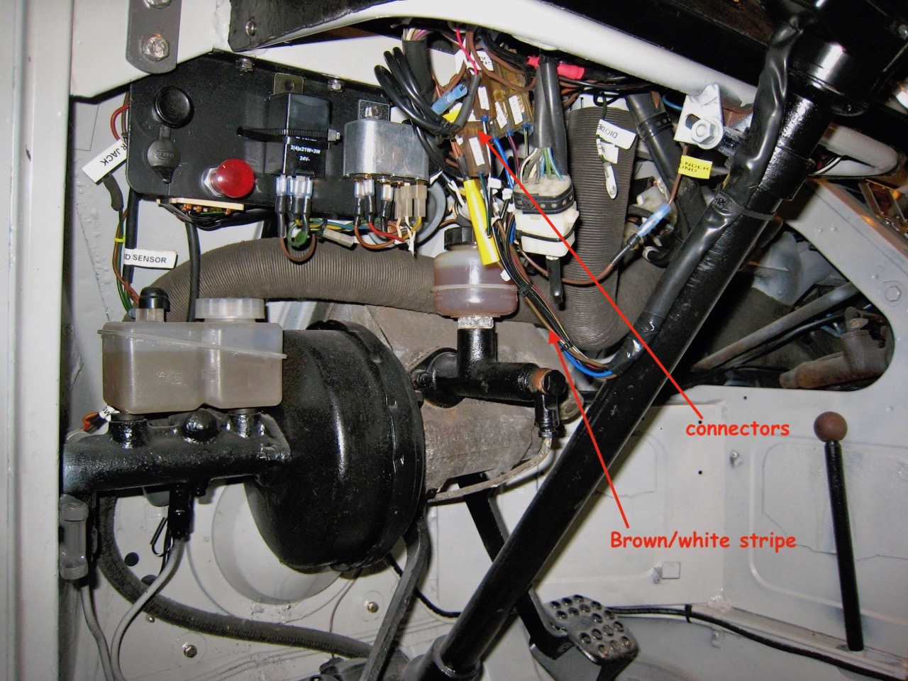

I'm dredging up this old post as I am having trouble figuring out my loss of high beams, right and left. No click from the relay when signal lever is activated so I suspected a bad relay. However, in reading this post, there is a comment that a brown wire from the steering column is the high beam switch. Well it just so happens I have a dangling brown wire with a spade connector coming from the steering column. . The problem is, my relay seems to have wires on all of its connections already. And, review of the color wiring schematic shows the brown wire as the horn wire. ( my horn works) Any help is appreciated and especially if the pictures of the relay connections could be reposted since they are no longer visible. I think will put a meter on that brown wire and see if activating the lever sends a voltage.

Well I just could not let this go tonight so I decided to get the voltmeter out and do some late night testing. As it turns out, the dangling brown wire appears to be just a ground for the high beam switch. Or, at least grounding it gives voltage and the relay cycles giving high and low beams. This brown wire has a spade on it so it must clip into somewhere. Any ideas? If I can't find its real connection, I will just ground it somewhere.
Again, any input is appreciated!

Re: headlight relay
The brown wires throughout the truck are typically ground wires including the one connecting to the horn button. Possibly the loose brown wire you have found actually has a faint white stripe on it, in which case it is the lead from the high beam switch in the turn signal switch. It probably loosened up and fell out of the plastic connector(s) where it connects to its mate that goes to the relay. It would have a spade terminal on it.
This photo may help:

Thanks Paul, I will look again but I was pretty sure it was solid brown. The brown and white, according to the schematics, goes to/from the 31b on the relay to the high beam switc.. My dangling brown wire does come from that group of wires so I will check the connectors. It makes sense that it plugs into there but it is probably important to find the right one. I also need to follow that blue wire as it appears to be the one lighting the high beam dash light which also does not function. It appears to come directly form the #6 breaker along with the right high beam headlight.

Re: headlight relay
The wiring harness from the turn signal switch in my photo uses some different color wires because it is an Austrian switch, not Swiss.
