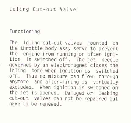

Thanks! Are they for theft prevention or roll-over issues? My 1st thought was to plug them...but I would like to know what they were intended for. Just in case.
Re: Fuel Solenoids...
Roverchef wrote:Thanks! Are they for theft prevention or roll-over issues? My 1st thought was to plug them...but I would like to know what they were intended for. Just in case.
Per the repair manual "to prevent engine from running after ignition is switched off".

As Mark said, they are to prevent dieseling when the engine is shutdown...
Without them, and using the clutch to stop the engine just puts stress on components and premature failure.
Also, if there is afterun, without the solenoids to stop the fuel, there will be a little unburnt fuel sucked into the engine that will wash lubricate from the bottom of cylinder walls. May even seep past the rings and into the oil.... not an immediate affect, but over time
Jim,
By plugging them, I think he removed the solenoids and capped the hole..... not a good thing... ok for 'get me home!" but not long term
