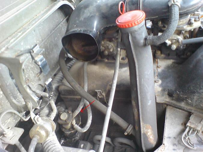

To gain access to the fuel pump I removed the engine cover and then took off the air filter. Here it is:
See the wet patch under the fuel pump. Something is definitely wrong!
Before removing the hoses from the pump I clamped them about 2 or 3 inches from the end to minimize fuel spillage. The manual says to pull the hoses off. I found that I had to twist them to get them off. Then they came off quite easily.
I tucked the hoses out the way and used the 13mm spanner to remove the two nuts at the base of the fuel pump. They are not the most accessible nuts, but fortunately I found that after loosening them about a quarter turn with the spanner they came off the rest of the way by hand.
I removed the two washers and the pump lifted off easily. I also removed the push rod that was sticking up beneath it and the black plastic bit that the pump sat on. I looked at the base of the fuel pump and saw the lever which gets moved by the push rod. I pressed it with my thumb and petrol squirted out like from a water pistol. Something to look out for!

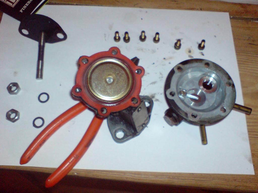

This is the removed fuel pump, nuts, washers and push rod. There is a gasket still on the push rod:
I'm glad I took this picture because I had to refer to it later when I reassembled the pump.

Before opening up the fuel pump I gave it a quick clean with a paper kitchen towel. In hindsight this was a mistake. I should have spent a few more minutes to clean it more thoroughly which would have made the job a lot more pleasant and saved time in the long run.
Being very wary that springs might pop out, I cautiously removed the top cover. It came off easily and there didn't seem to be any danger of bits popping out, although there was still some petrol inside so I ran outside so that it wouldn't spill on my dining room floor.
Here's what I found:
At this point I realized that I wanted to keep the inside clean, but the outside was dirty. I really should have given it a good clean before I took it apart.
Straight away I recognized two parts from the repair kit. It's not obvious from the picture but there is a gasket sitting on top of the diaphragm.
I swapped the old for the new and replaced the cover, making sure that it would be a clean seal.
