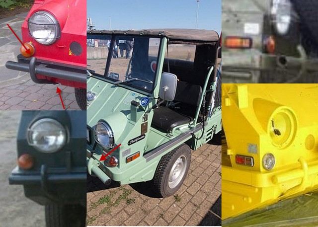

Ok - I did some digging on Google and went through my pics
This is all just for interest sake but here are a bunch of the "V1" bumpers like I have on mine.
I am wondering if the US DOT requestest the square hollow mount so there was some "give"/crumple to the bumper (even though it is only 1")??

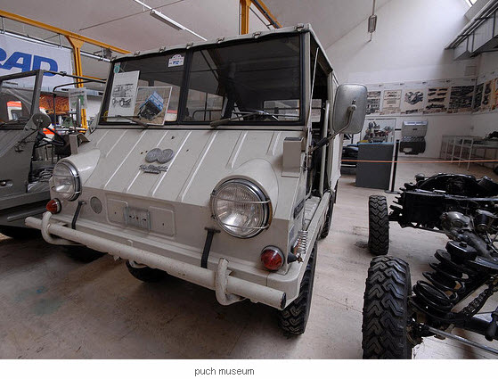

The mount is also directly behind the bumperette vs far to the side like on the "V2" bumper. I also found a pic of the NA Pathfinder in the Puch Museum - it has the V1 bumper and mount...hhmmm... :idea:
You would assume they would have a pretty original one but who knows!!

You could be on to something with the US regulations idea as the examples you've found are all Pathfinders. I assume that the Pathfinder in the Puch museum was returned there from the US at some point in its life

As far as I have observed, U.S. spec bumper is unique to U.S. models. I have never found this bumper on other(non U.S.) Bug Eye models.

Hi,
The bumper which is shown e.g. in the picture with the red Haflinger and in the pictures from the Puch Museum is a younger version. The other bumper style is an older version, which was also used on some other civilian Haflinger versions e.g. in Europe.
It appears to me that Pathfinder marked 3/71 on the compliance plate have the older style bumper, while Pathfinders with younger dates on the compliance plate have the younger bumper type. I don't know for which reason the bumper was changed, but maybe it was a problem that the older bumper was partially in front of the headlights.
The younger bumper is, as far as I know, unique for Pathfinder models. I haven't seen it on other Haflinger versions.
By the way... the Pathfinder at the Puch Museum was never exported to USA. There exist quite a lot of such Haflingers in Europe. It appears that a batch of Pathfinders was not sold to USA any more in 1972.

In my 1st post the red haflinger is marked 12/71
The tan one is marked 3/71
So if I follow what your saying 3/71 and older have the larger bumperettes ('older' version)
And anything marked 4/71 and newer should have the smaller bumperettes ('younger' version)
Makes sense

Hi there,
yes, this sounds correct to me, except that I haven't ever seen 4/71 so far. It appears that the next younger ones after the 3/71 are 10/71, 11/71 and 12/71. Then comes 4/72, but these vehicles already mix up with Haflingers which stayed "at home" for local sale.
