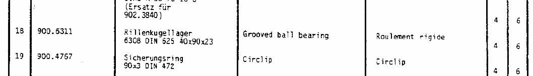

I will be tackling the two rear seal leaks soon, and while I bought all the parts needed from SAV, I forgot to order the bearings :oops: . Since shipping charges really add up, and I read on SDP-PINZGAUER that the wheel bearings can be purchased at an automotive/bearing supply shop....
This is a standard seal available from NAPA & the seal stores so are the bearings 6208/C3.
....could someone help me clarify the bearing part numbers? From the pic they aren't the same bearings, so which bearing(s) does 6208/C3 refer too?

Print out the page from the spare parts catalog and take it with you to the your bearing supplier, in the German language column it gives a call out for the original suppliers part number (not positive what ones you want to replace) the parts guy should be able to cross reference the bearing, seal, or whatever is in that column if it’s a common part. The same goes for things like fuel lines and such, name only in “foreign language” column full description with manufactures part number if applicable in German column. also note the right colums have the quantity needed for 4x4 or 6x6
such as "rillenkugellager 6308 din 40x90x23"
http://www.mcmaster.com/#6308-ball-bearings/=iw0a8s

REAR Wheel hub repair:
The Inner wheel bearing - SAV D054120050 is in an FAG box labelled NJ2207E.TVP2
The outer bearing - SAV 9006311 is in an FAG box labelled 6308
These #'s correspond to the parts manual EDZZ refers to

Thanks!
All bearings were double SAV locally. SAV here I come! :mrgreen:
