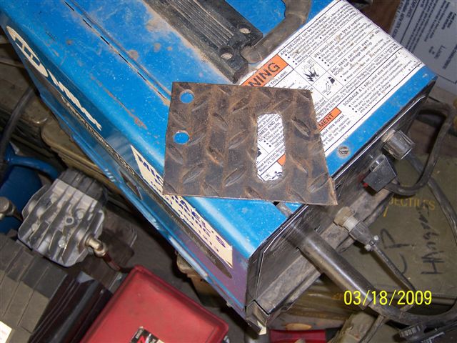

When I have needed to tweak the front nose I made a piece to attach to the hinge location ran a come along to the rear bumperette. Did not take much to get the doors to line up properly.
dimensions (Small).jpg (32.21 KiB) Viewed 1785 times
door tool.JPG (82.12 KiB) Viewed 1785 times
