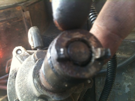

Okay, so I trimmed the lock ring by about 2mm, as it had stretched, and that helped a lot. I also added a lock washer. Now, when I removed the dizzy to get at the ring, I noticed some very obvious wear on the "teeth" at the bottom of the shaft. There is still enough meat left on each toot, but you can see the wear. Is this something to be concerned about?

Well it is probably still OK but if you want to fix it correctly, find a 009 Basch distributor used on a VW motor (cheap should cost about $50 or less and replace the bottom piece as they are the same. Pay special attention to the dributor as you take it appart as it has to go back the same way. When you have it appart analy clean everything inside and lighty re-grease it as you put it back together.
I see on the Austria ebay site there is one for $ale if you want to spend the cash and just replace it.

westernair wrote:Well it is probably still OK but if you want to fix it correctly, find a 009 Basch distributor used on a VW motor (cheap should cost about $50 or less and replace the bottom piece as they are the same. Pay special attention to the dributor as you take it appart as it has to go back the same way. When you have it appart analy clean everything inside and lighty re-grease it as you put it back together.
Thanks Shawn!
Another winter project!! :roll: :mrgreen:
Another quick question, is the bottom piece supposed to move around? Seemed loose.

Yes it should be a bit loose.

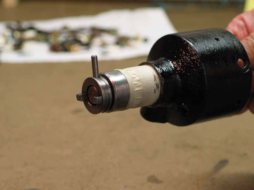

westernair wrote:Maybe want to call Glenn ring a call before doing any welding...
http://www.glenn-ring.com/bosch/
Thanks Shawn! I found some pics that show how to remove the drive without complete dissasembly. Picking up a used dizzy for cheap, with a good drive unit, should suffice. I also Emailed Glen to see if he sells just those parts.
