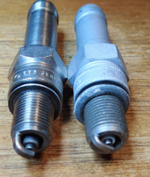

I've not seen any of the plug cross-references on the various pinz sites listing the Bosch WC145ERT2 (or WC145 ERT2) as an alternative to the original Bosch WC8DC.
The plugs are similar but the WC145 is significantly shorter overall, does not extend into the combustion chamber as far, and the center electrode does not extend as far. I have found nothing about the heat range on the web relative to the 8 heat range of the WC8DC. The WC145 does not appear to be stainless steel but plated.
Any info on the WC145ERT2 in the standard ignition Pinz? I am not considering converting to civi, I like the stock system.

Where did you come up with the idea to use the WC145ERT2 ? this plug does not appear to be of similar characteristics to the standard Pinz plug. I can find no reference to the WC145ERT2 in the Bosch standard heat range charts.
Using a plug with the wrong reach and heat range can have very bad results. :shock:
Would likely also void your warranty. :lol:
You may want to look at the Champion XMN-12 as this appears to be a proper substitution if the correct Bosch WC8DC is unavailable or too pricey.

edzz wrote:Where did you come up with the idea to use the WC145ERT2 ? this plug does not appear to be of similar characteristics to the standard Pinz plug. I can find no reference to the WC145ERT2 in the Bosch standard heat range charts.
I am sure you will be equally shocked that this is what SAV sent me after they told me prior to the order that the Bosch plugs they had were specifically WC8DC. I took the same issues and sent them back. :shock:

OK, guys, so I am confused. I bought "original" Bosch WC145ERT2 plugs a year ago from SAV. Still have not installed them because the stock ones are doing perfectly since I got the truck two years ago. Should I NOT use the new plugs?

This is old hat, as previously posted(several times)those plugs are at least 2-3 heat ranges too cold. It is unwise to stick with the mil cap and plugs. An engine with these plugs will run like crap at altitude or have very hard starts in cold weather.
Put the civy kit with conversion coil wire in and experience just how good your Pinz can run.
Cold plugs = less fuel economy :shock:
The NGK (BP6ES)plugs work great, are the proper heat range, and are less than $4 ea on average, you can use a standard timing light with Beru wires without an adaptor, and Pertonix unit eliminates points.

Jim LaGuardia wrote:This is old hat, as previously posted(several times)those plugs are at least 2-3 heat ranges too cold.
Really? I searched all over here for Bosch WC145, WC145ERT, WC145ERT2 and never had a hit here, or in the Pinzgauer yahoo groups.
There are a couple of mentions on the german language pinzgauer boards, mostly suggesting (in Deutsch) that they "fit". I don't visually believe they are the right range due to the differences in construction and extension. But I could be wrong since there appears to be no Bosch docs I can find.

crcpinz wrote:OK, guys, so I am confused. I bought "original" Bosch WC145ERT2 plugs a year ago from SAV. Still have not installed them because the stock ones are doing perfectly since I got the truck two years ago. Should I NOT use the new plugs?
From what I have been able to find in old Bosch material (despite the difference in looks), and my 5th grade German language skills, they are equivalent as it gets in the Bosch line. They have old and new numbering schemes (new WC8DC, old WC145 ERT2)
W (14x1.25 thread)
C (Shielded, Watertight)
8 = 145 - Bosch "unique" heat range code (old vs new system in Bosch designation - heat value is the same)
D and T2 - 19mm "reach" (thread length)
C - electrode material in the new, the ER equates to other properties that are not significant
So while they look very different and are constructed differently, according to Bosch designation they work the same. I am also not sure why the pre-1979 numbering scheme (WC145 ERT2) is still floating around since the WC8DC is supposedly the newer designation, but there you have it.
