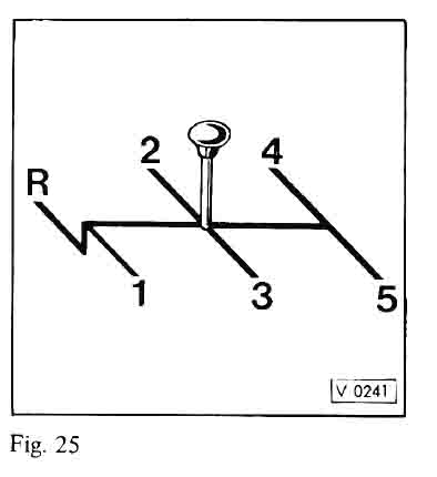

I find reverse is best found from first. On my '73 710K it isn't straight ahead of 1st (as the diagram suggests) but slightly to the right of straight ahead.
Once you've found it a couple of times, you won't miss it again.

+1 on that!! I was having a hard time getting into reverse without crunching gear teeth. Almost every time. Then I read a post about how the rev gear isn't syncro'd like the rest or the forward gears, and that by going into first (or any forward gear) first, and then quickly shifting into reverse, you'd avoid that crunch. WORKS LIKE A CHARM! I can now get into reverse like butter!
