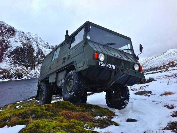

I had a replacement set cut from a flat 35mm sheet of Delrin. There's plenty of so called 'engineering plastics' out there that cut and drill beautifully; last for ever; and slide well when rubbing. You lose the organic look of wood but everything else is positive.
Hope you like black though.
If you have access to CNC then Delrin or similar would work beautifully.
Tony
Tony
- resized Pinz Ben Lawers pic.jpg (53.35 KiB) Viewed 7317 times
