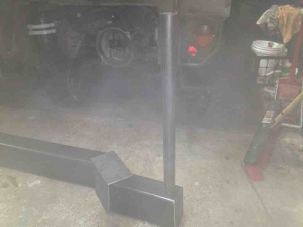

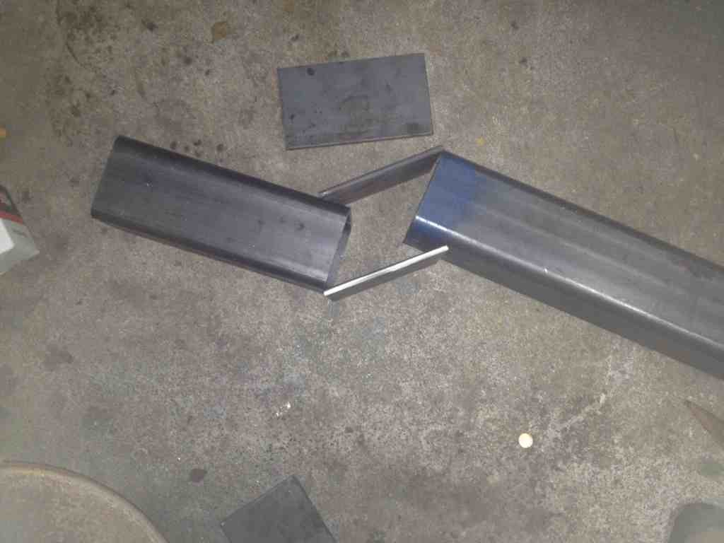

As I wait for my engine to come back for my hafi from Leonardo, I have decided to build a rear bumper for the Pinz.
So far I have only cut the bulk metal. This weekend I will begin the fabrication. Should weigh 65 lbs w/o the tire carrier.
I am using 1/4 inch 4x6 square tubing as it will allow for the 2 inch hitch to pass through it when connected to where the pintal was, the 1 3/4 DOM will be welded to where the stock braces come off the truck. Mounting points will be the 4 stock bolts below the rear door, the pintal bolts and the stock side braces. I will also at some point weld a s swing arm pivot into it for a swing out tire carrier.

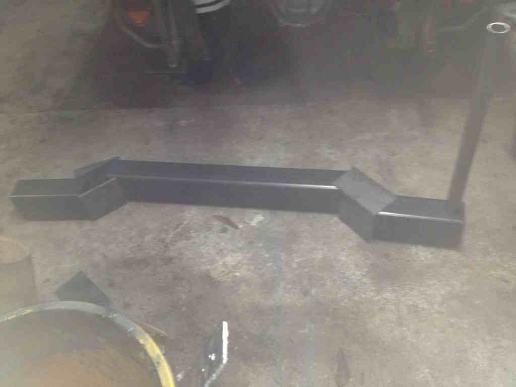

Post by westernair »
Made some progress so far, Next I need to cut and box in the 2 inch reciver pass through and cut the original bumper tubes off of the side braces so I can add the 1.75" DOM. The DOM tubing will extend to the height of the bed and will alow the installation of a removable rear hoop or other accessory down the road. The original bumper plug fits nicely in the tubing.

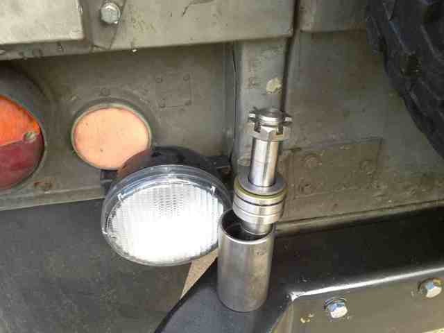

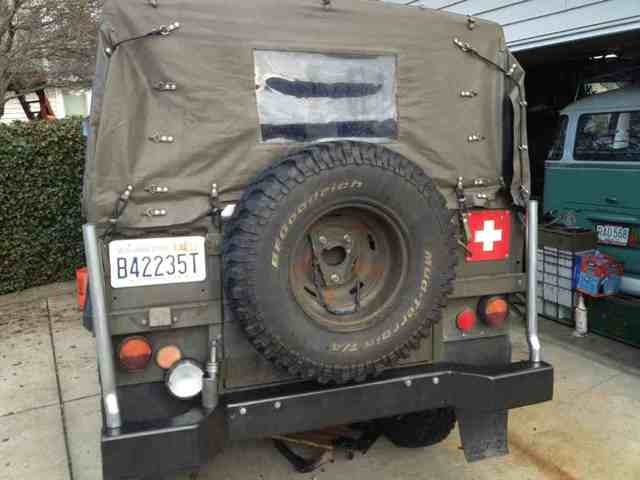

Weekends have been busy with non-Pinz stuff but during the evenings I have been still working on the bumper replacement. As you can see the blade is finished, now I need to cut the square hole for the 2 inch recever, make the spare tire mount, and weld on the upright bars.
My question now is where should I mount the hinge pin for the tire mount. Anyone have some experience with this and want to share? Also pics of the swing arm would help.

westernair
Posts: 748
Location: Tacoma, WA
Re: Rear bumper
I also may upgrade my backup light to lights mounted in the bumper.

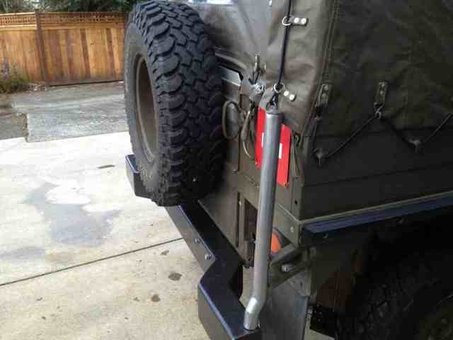

westernair
Posts: 748
Re: Rear bumper
Bumper swag. 1/4 plate plasma cut
