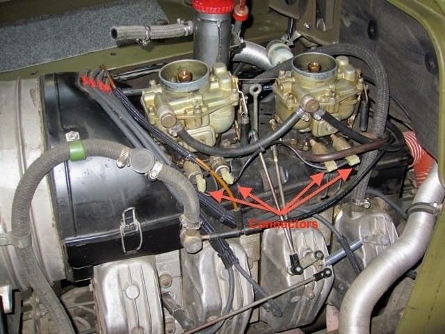

Thanks guys....anyone with time to post some pics of these electrical connectors it would be appreciated...PCollete...if the carbs do need adjusting I would be a bit afraid to tear those apart would a local shop be able to handle that or should I send them to EI for a rebuild?

Look at the bottom of your carbs - there are some wires that attach onto the fuel cut-off solenoids - only a simple blade connection.

Here's a photo with the 4 connectors indicated:

With the ingnition on, but the engine not running, you should hear a difinitive but quiet (sometimes not so quiet) click as you disconnect and reconnect each fuel cut-off solenoid. It is possible that these are not working (no 24V to them?) and someone "tweaked" the carbs to idle, anyway (running rich, or float level way too high). This could explain why it kept running when switched off.
Check for the clicks, then invest $20 in a fuel level sight gauge to determine if the float level is correct, or not. Then you will have knowledge to proceed with.

Post by Recon113 »
The solenoids all make a click....when I start and then stop the engine there is still gas dripping into the rear carb.....the choke lever seems fine and everything's appears tight on the carb
