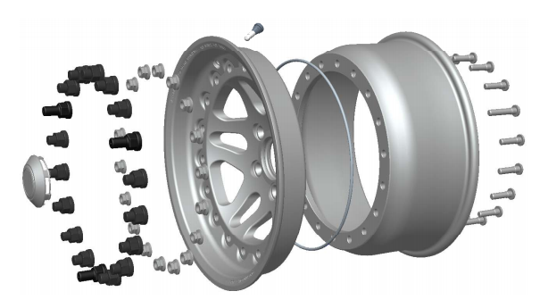

Re: Atik G wheels
Posted: Fri May 27, 2016 2:51 pm
Hutchinson's are great but once you go through rocks and bash up the 15 stud threads (x4 = 60) you'll be lucky to get them off without breaking them!
Some Hutchinson's come with the plastic nut caps but not a great solution.
