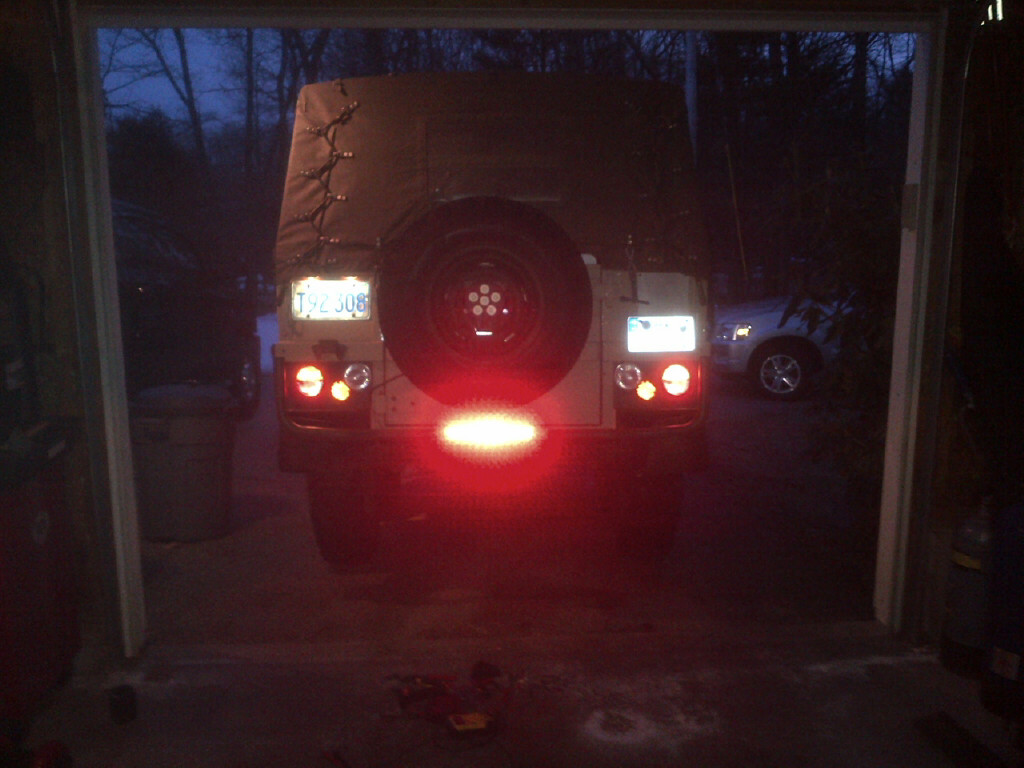

So I added a red LED extra brake light but I can't find the orange brake light wire I followed it in the main harness but it doesn't come out in the end. I checked at the lights and at the trailer connector. Is there a junction box somewhere that I lose it at? I also figured out the signal lights and brake light wires I have are the same so it would flash when signaling. All my signal lights are connected in the trailer conector so If I disconnect the wires there I lose all my lights. I was gonna use the pink wire but I can't find it under the dash to jump it to the brake switch. Any pointers or help?
This is the brake light I'm using nice and Bright and fits nice.

I drilled one hole in the center for the wires through both walls(Body is like a square tube crossmember in that spot) fed wires(shrink wapped togther) through and they come out to a nice big access hole that will make wiring fairly easy. Just need to remove pintle or hitch for easy access. I removed pintle because I am adding a 2" receiver but you could just as easily put the pintle back after s well.
I dilled 2 holes for the screws and then tapped the holes(body is nice and thick there so takes a tap nicely) for theaded machine screw.

Some Pictures of it all lit up. Took all my lights off and cleaned them with some windex and then used some meguiars clear plastic cleaner and clear plastic polish amazing how much brighter clean lights look.
