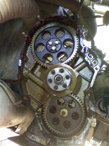

Yep, support engine, pull tranny, starter and timing gear cover. You then have access to flywheel which can be removed and the ring taken off and replaced. Had to fix an oil leak in the timing gear cover not too long ago so replaced the ring gear at that time as well.
what it looks like with flywheel removed and engine in place.
0309110923 (Small).jpg (44.95 KiB) Viewed 2648 times
