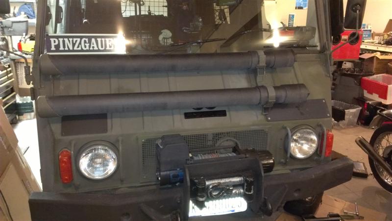

In this photo odd looking things are the correct antennas that were used with the Pinzgauers.
During operations the truck would be parked in a somewhat sheltered location and antenna wire would be run to the location that had been chosen for the antennas. This would allow the truck to be parked under camouflage or in the trees and have the antennas located at a location that provide proper radio operation. http://www.tacfl.org/equiment.html

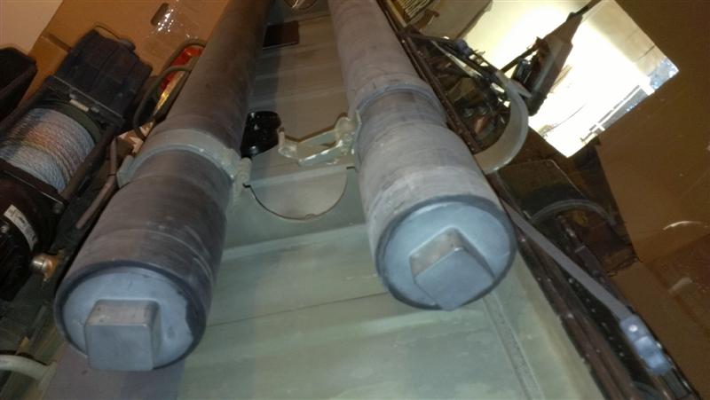

The set of pictures of the tubes on the front of my truck show tubes made from abs plumbing parts. Use your imagination, I used an inside fitting plug on the passenger side and a clean out fitting with a screw in plug for the driver’s side the raised piece just inboard of the driver’s side clamp is a coupled that I ground the inside ridge out of so it would slide over the main tube, I glued it in place just to insure that the tubes would not walk out of the mount. I scuffed the abs parts with sand paper to remove the gloss so they would look better on my truck.
I wish I could locate a set of the antennas cheap… fat chance of that happening.

Ed, that is very helpful. I have the whip aerials shown mounted on the white truck in your first photo. Since the come apart in the middle, to approximately the length of the front mounted tubes, I assumed those tubes were there to store them. Certainly it would suit me to use them for that.
I'll try the ABS route.
