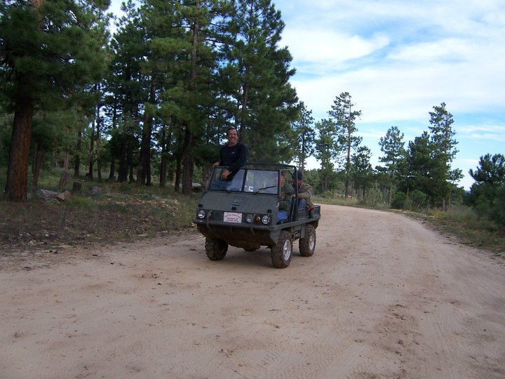

not to get too far off topic but the rims Mark used for his Haffy were take offs from the UTV world. He had adapters made and now the rims and tire selection are endless Not a great photo but it is all I have showing his wheels/rims.

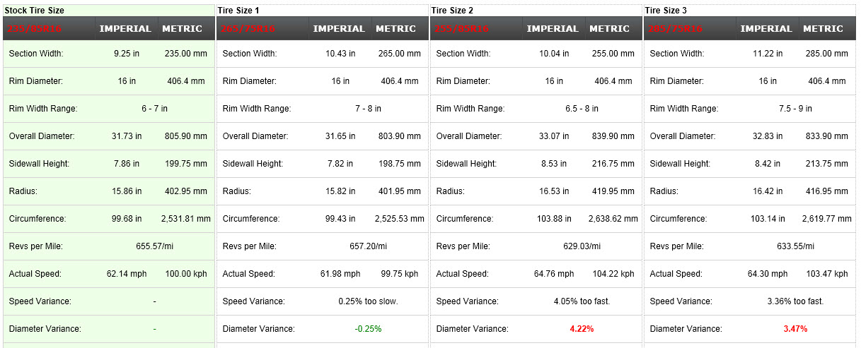

Re: Tires - convince me.
at least 20+ threads on tire size
here is the basic list
for stock look (narrow and size): 235/85R16
for close to stock: 265/75R16
for taller and no clearance issues: 255/85R16
and max size advisable on stock rims: 285/75R16
Brand is another 2 dozen posts (and my post above will no doubt cause a pile of new posts
