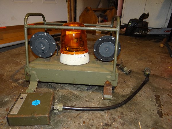

I have a beacon and horn unit from , i think, an ambulance. I have the horn and light part and the controller part,
What i need is parts to connect controller to the noise and light show.
The wires from both parts currently dead end in a 7 pin plus center pin male connector.
Please look at the pictures. As i get older my language skills diminish
What I would like to locate is 2 female 7 pin connectors. I have an accessory plug to pigtail in power Any ideas on locating the female connectors ? what is the proper name of these things.Thingamajig doesn't get you very far in a google search

Look carefully on the plug that you have. There should be a mil-std number (MSxxxx.xx....) It will probably end with the letter "P" for pins. Google the same number but substitute "S" for the P. (S for Socket)

I've used them as well for trailer connectors quick shipping and usually have just what you need.pcolette wrote:Try this outfit. http://www.eriksmilitarysurplus.com/miraca.html
They've helped me in the past.

Thanks for the help!! Gottem on the way !!
