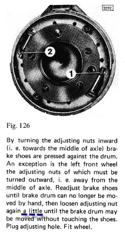

Re: Front brakes vs Rear Brakes
Not sure what 'a little' is but perhaps like undysworld suggested - reduce the amount your backing them off
- brakes.jpg (48.92 KiB) Viewed 4626 times

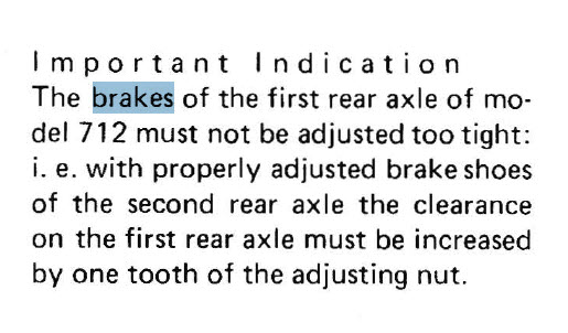

As a 712 owner.. whats this minor exception you speak of?(with a minor exception in a 712 )
Center and rear axles get adjusted differently to maintain traction on both axles when hard braking. Don't remember off hand which is adjusted harder than the other without the manual.(I service mostly 710's)
in the operators manual pg 158:totaljoint wrote:As a 712 owner.. whats this minor exception you speak of?(with a minor exception in a 712 )
- 712.jpg (41.1 KiB) Viewed 4588 times
