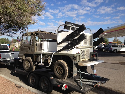

Here are some pics of it from when I first got it 10/14/13, drove to Austin, TX. to get it. It was a hunting rig with 6 dog kennels, high seats and gun racks.

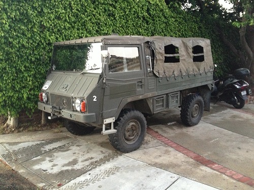

starting to come together but tho top is in bad shape!

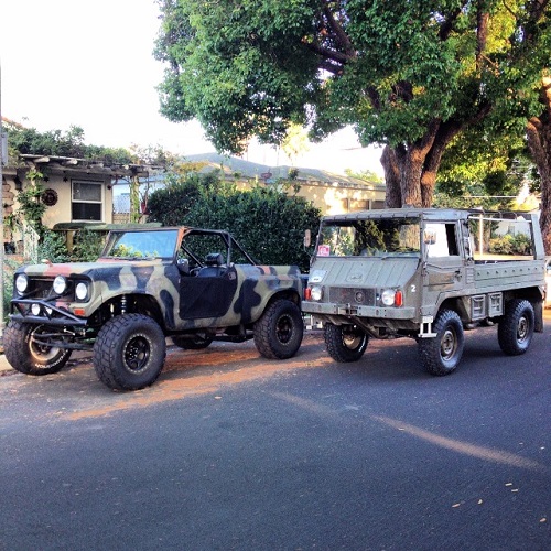

Here's one with my other rig, a 70 scout. just put some new 255/85 bfg mud ta's

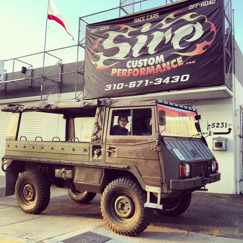

In front of my shop
