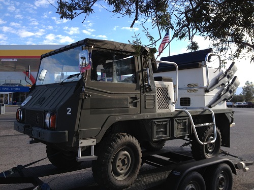

Here are some pics of it from when I first got it 10/14/13, drove to Austin, TX. to get it. It was a hunting rig with 6 dog kennels, high seats and gun racks.

Looking good!
Is that a rig via Andre?
