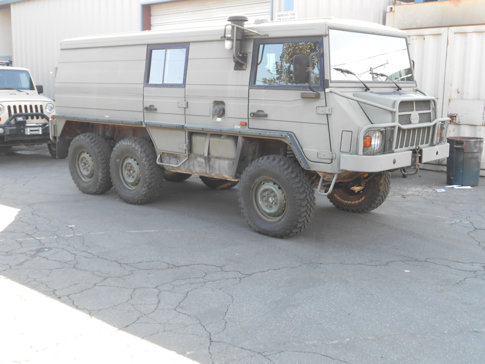

Well, the introduction was done in the Flying Dump Truck thread because that build is responsible for this find. Now, I’m starting the Pinzgauer’s own dedicated thread.
Some repeated pics from other threads, but all will be in this thread from now on.

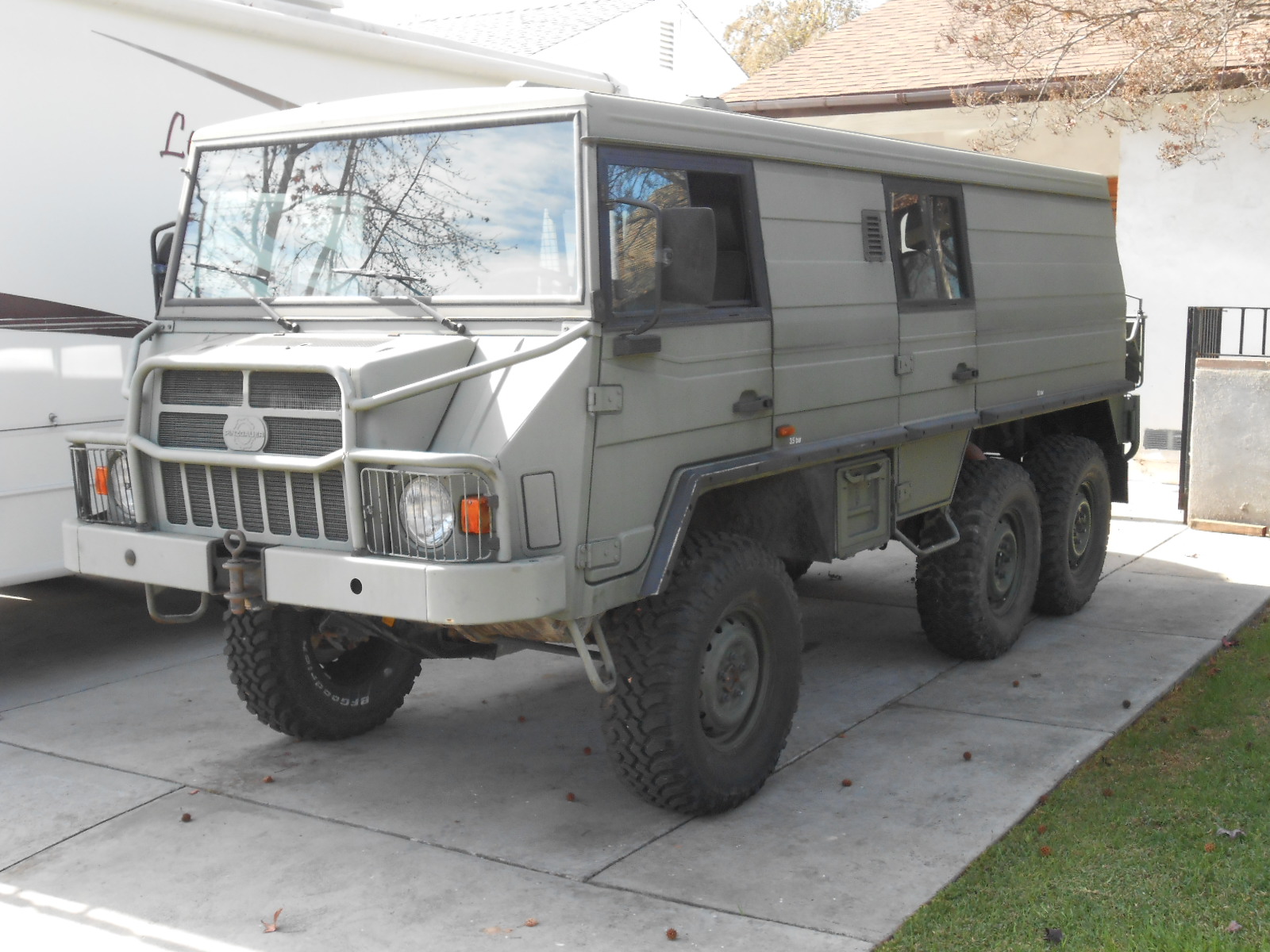

This is an extremely low mileage (262 miles) UK manufactured 718K, but what the Austrians I guess called a 758 (for the UK manufactured Pinzgauers).
Unlike SDP made TDs, this has a VW 2.5TDI engine ( the 5 cylinder version of the VW 4 cylinder 1.9TDI)
4 speed automatic, also Anti-Lock Brakiing System (ABS), Electronic Braking Distribution (EBD) and Electronic Traction Control (ETC)

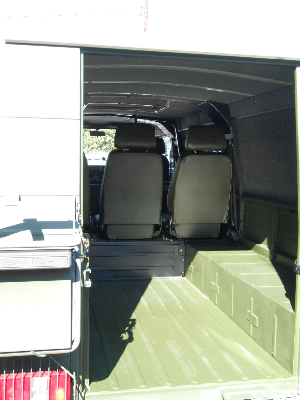

And as a FFR ( Fitted For Radio) has a 2nd set of batteries in a battery box in the inside the left rear door and a junction box on the right side.
A small 250w inverter was mounted below the junction box
And the best part is I can actually be the one to break the truck in :mrgreen:

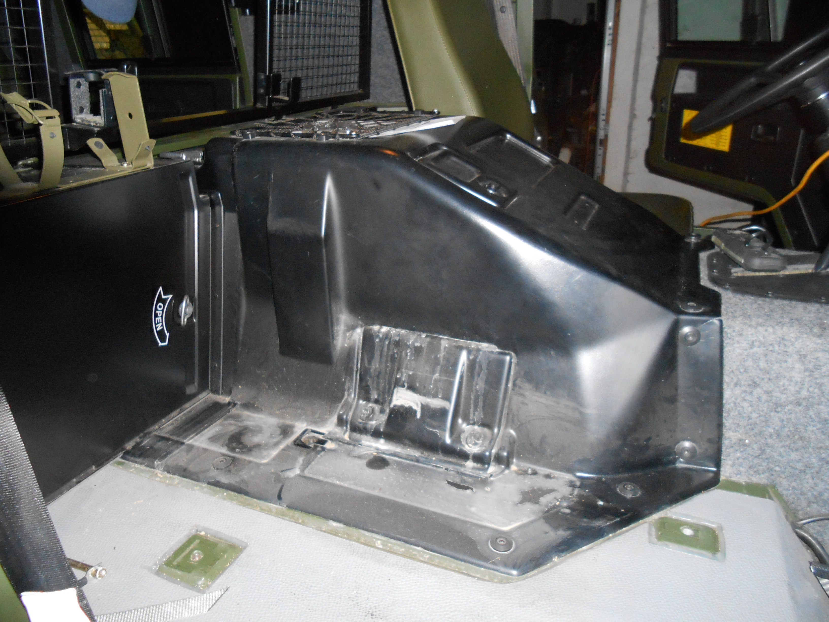

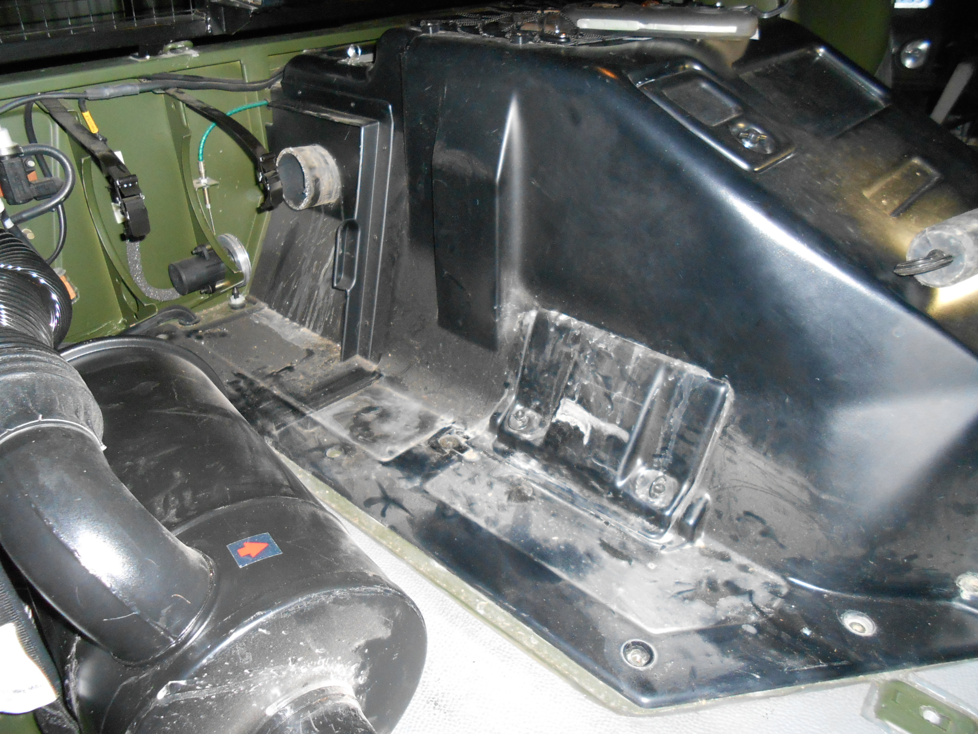

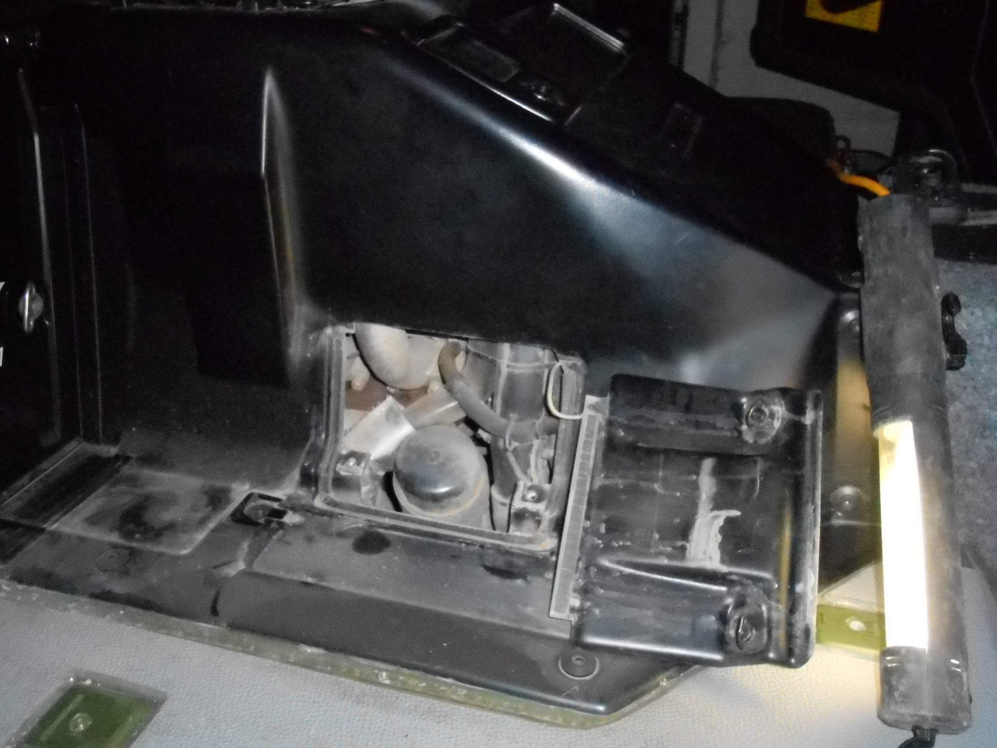

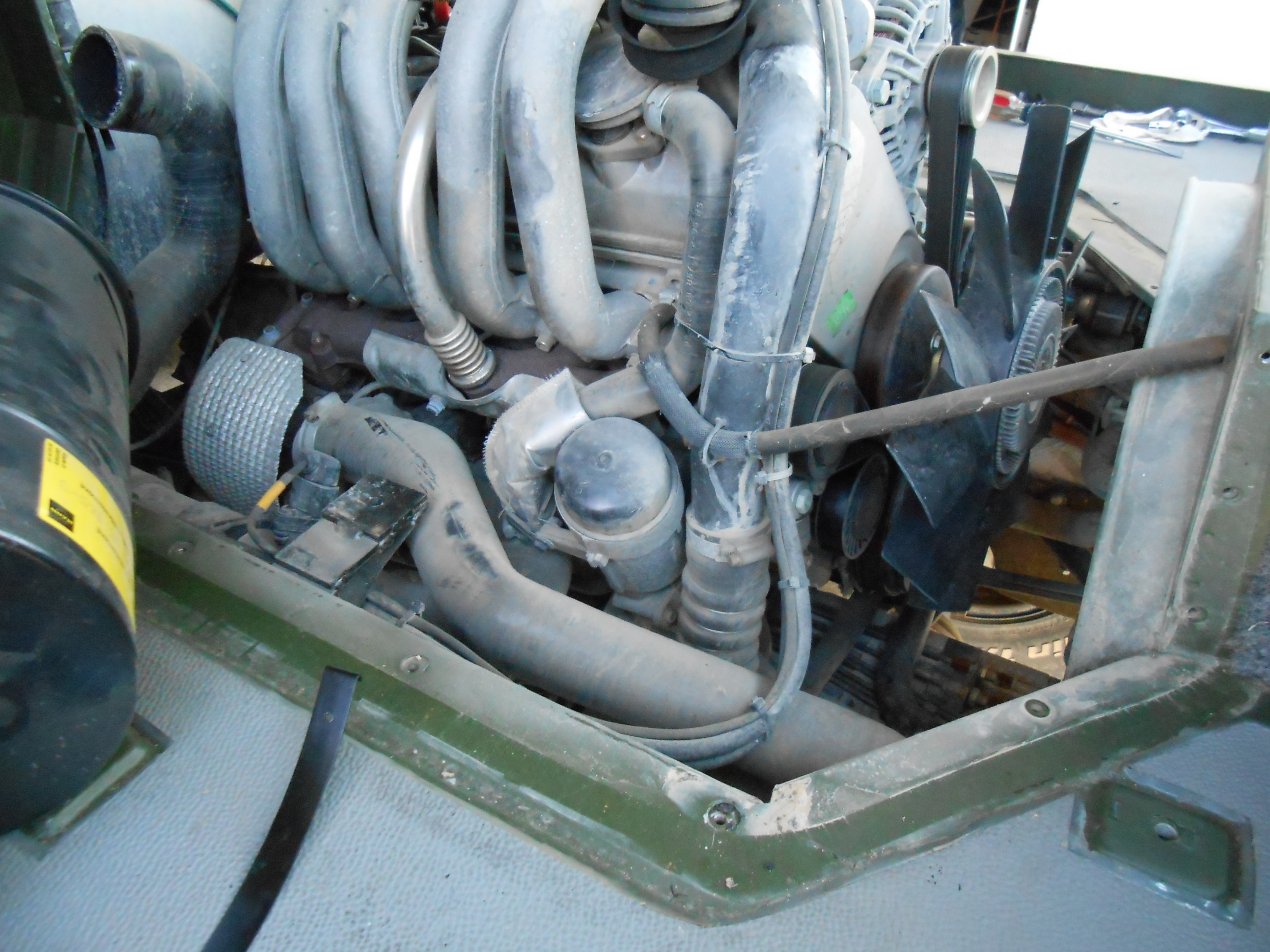

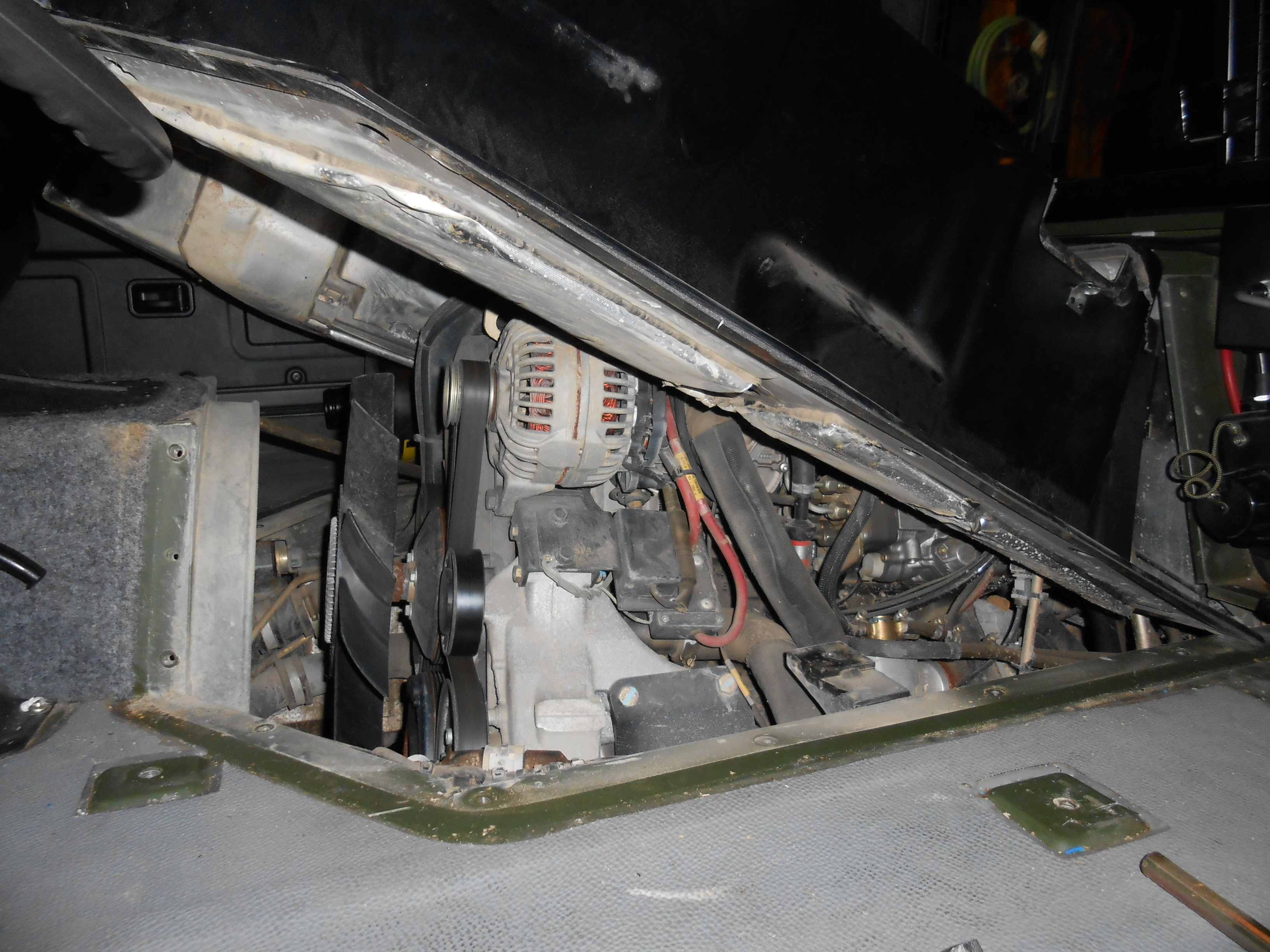

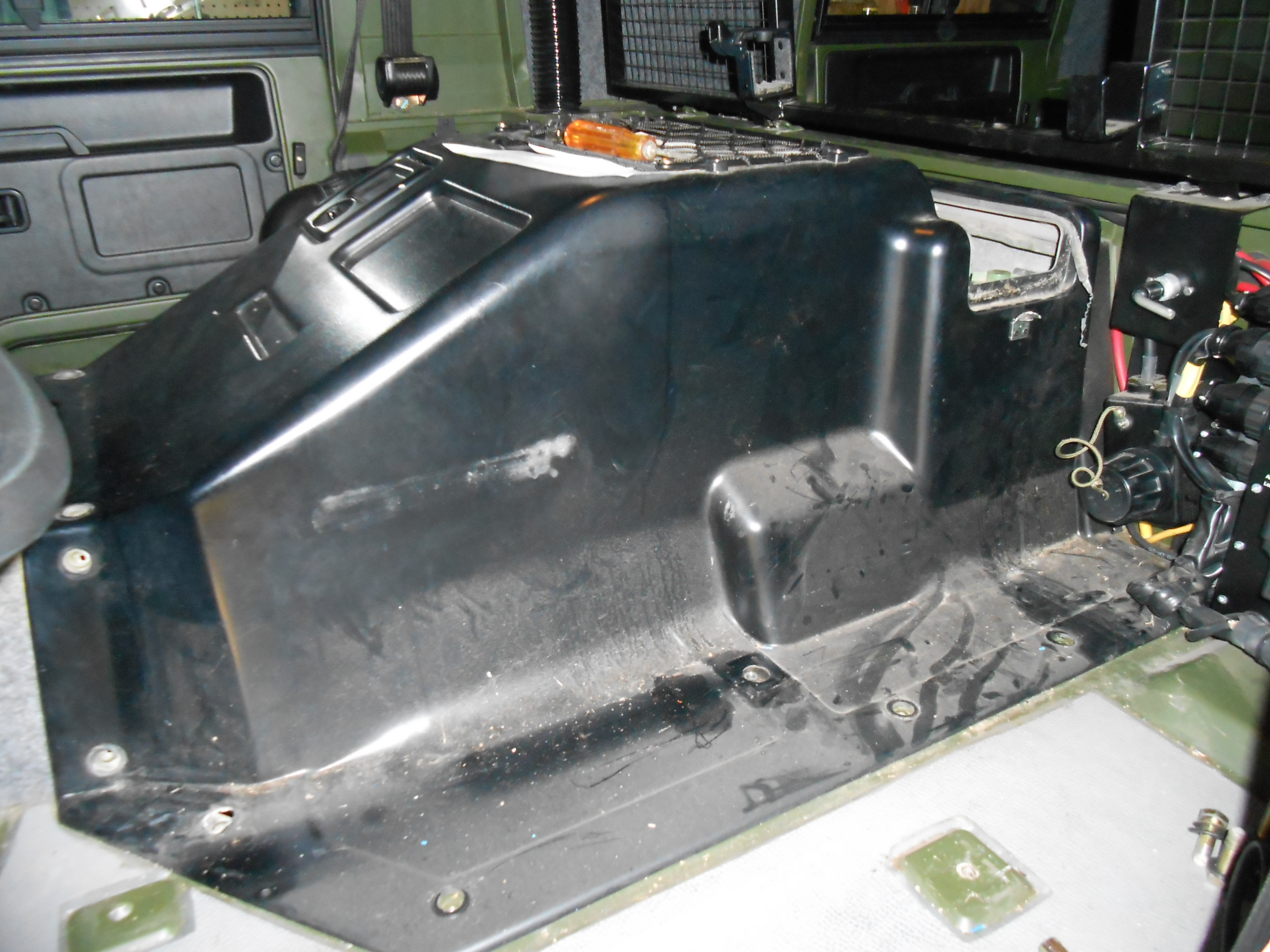

Tonight I began the tedious job of removing the doghouse.
Fewer bolts than what my SDP 716 had, but a lot more work .
I wonder if the ATL Pinzes with the 2.4TD had this or the SDP doghouse?
The access cover to the oil filter. The cover on the nearside on top of the leading edge is the oil fill
The opening towards the rear of the doghouse is for checking motor and trans oils and for the power steering reservoir.
The first looks of the engine :wink:
Reason: To fix photobucket policy changes

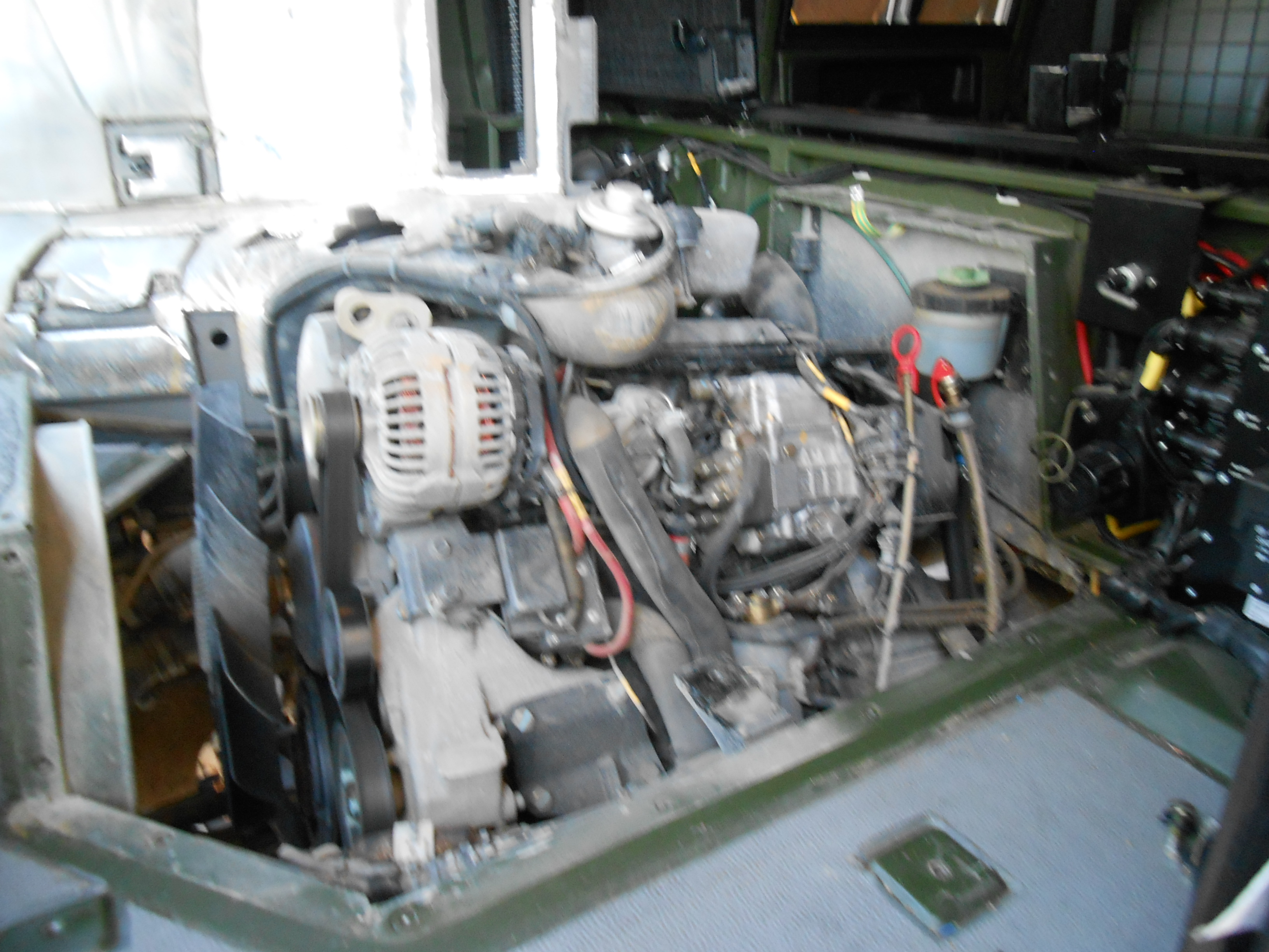

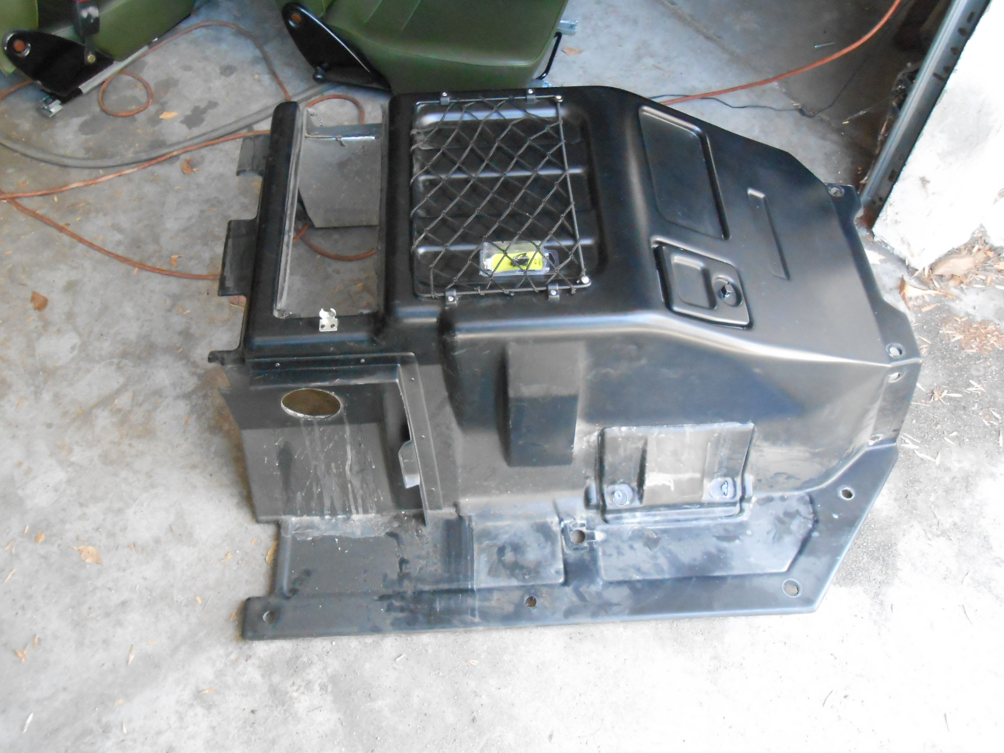

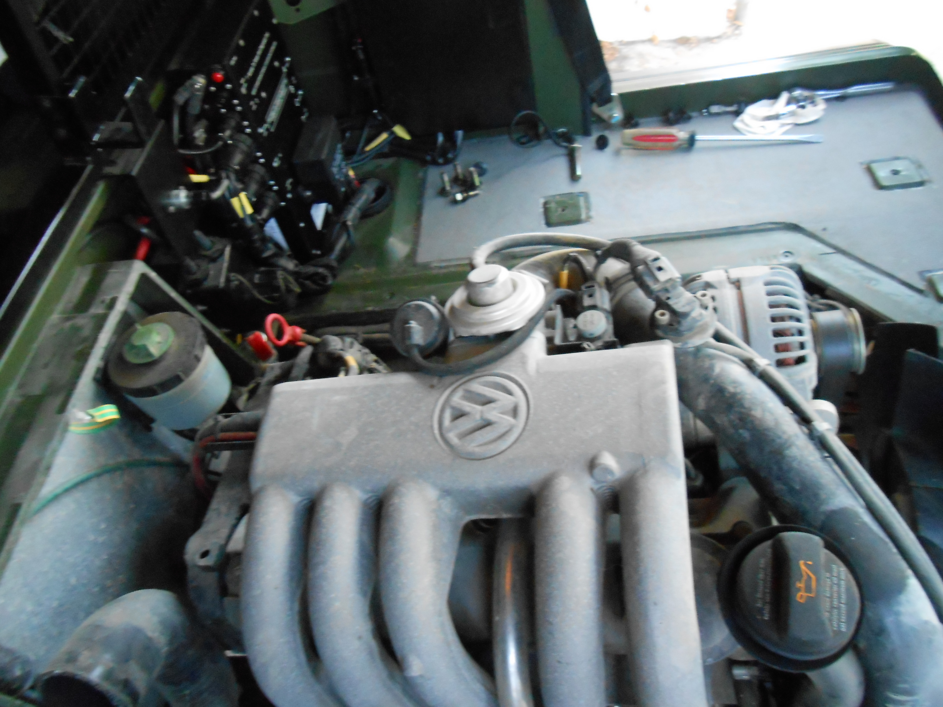

I returned to R&Ring the doghouse to know how to do it when I have to, and to see the engine :D
To prove it is a VW and not 5 hamsters :mrgreen:
The doghouse

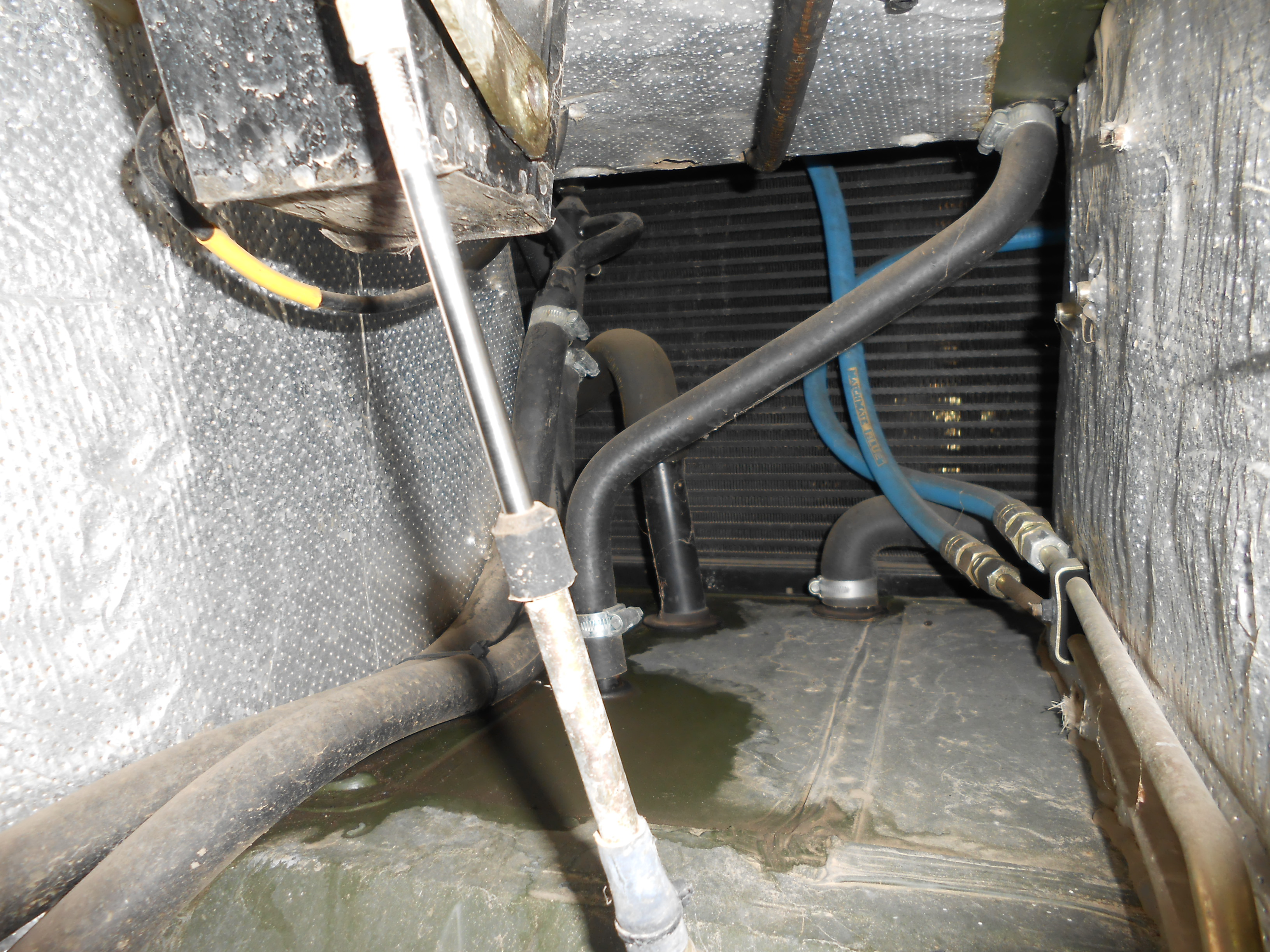

And I found my coolant lost. Unfortunately, I didn't see this until I uploaded to the computer, but it doesn't matter. The front shroud, radiator and intercooler needs to be removed to get into the tunnel.
The coolant leak isn't as bad as it may look. I have never been able to find a drop of coolant under the truck ever. So removing the cover did point me to one of the items that needed to be dealt with eventually. :D Talk about dumb luck! :lol:
And yes, it looked like the truck spent most all of it's 262 mile life in the mud hole proving grounds :roll: :lol:
