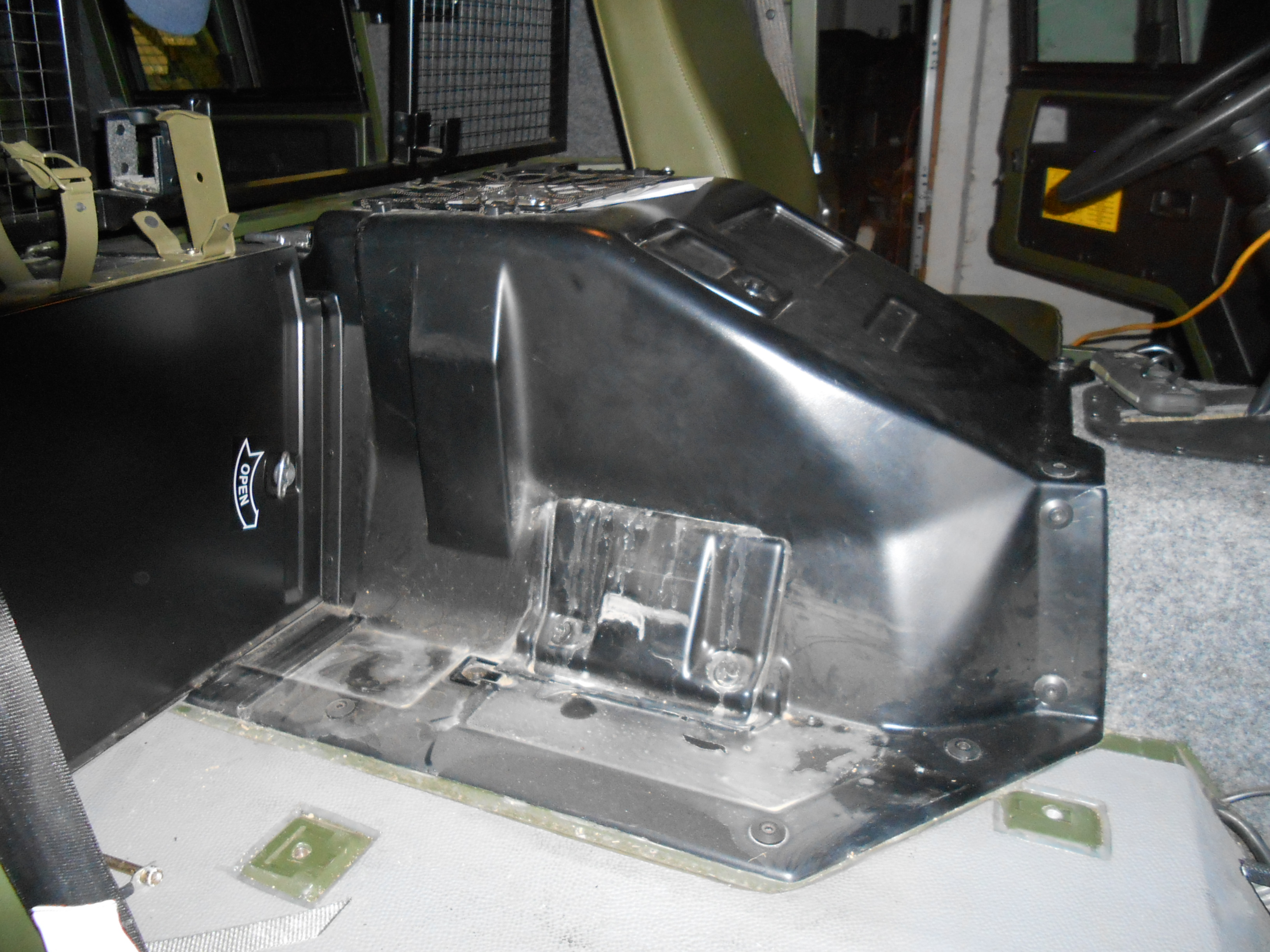

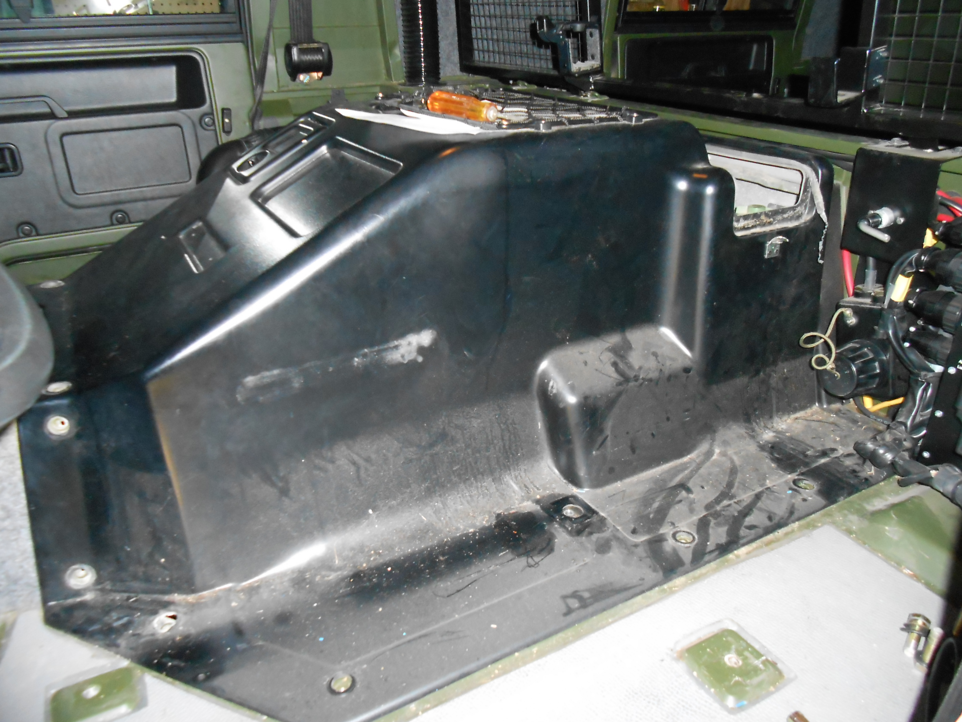

Tonight I began the tedious job of removing the doghouse.
Fewer bolts than what my SDP 716 had, but a lot more work .
I wonder if the ATL Pinzes with the 2.4TD had this or the SDP doghouse?

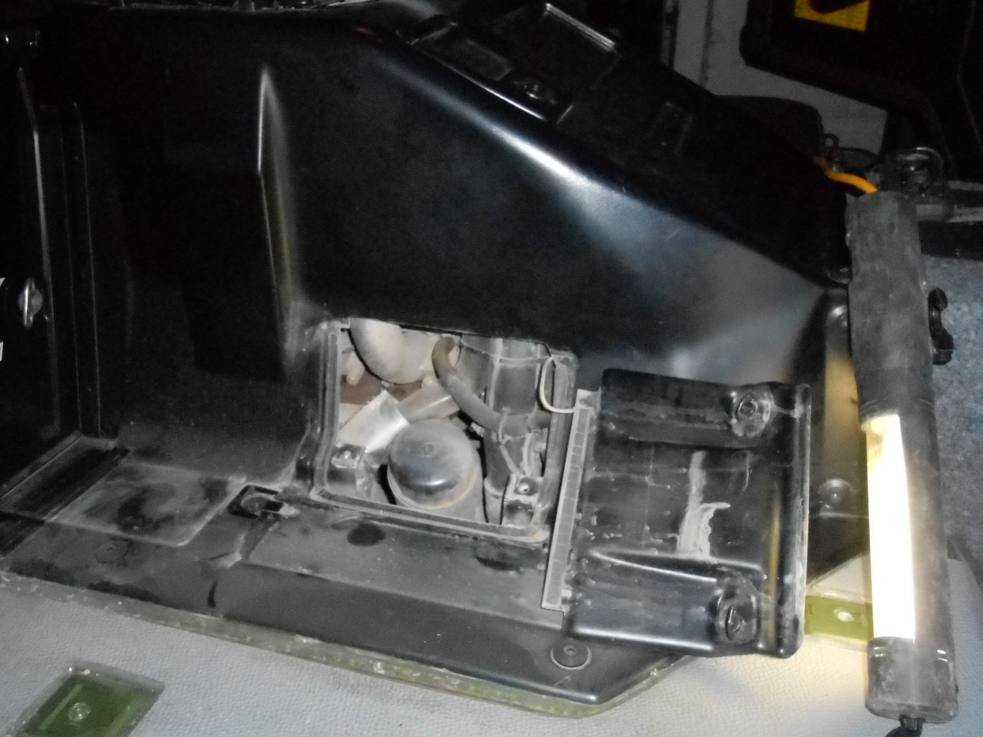

The access cover to the oil filter. The cover on the nearside on top of the leading edge is the oil fill
The opening towards the rear of the doghouse is for checking motor and trans oils and for the power steering reservoir.
The first looks of the engine :wink:

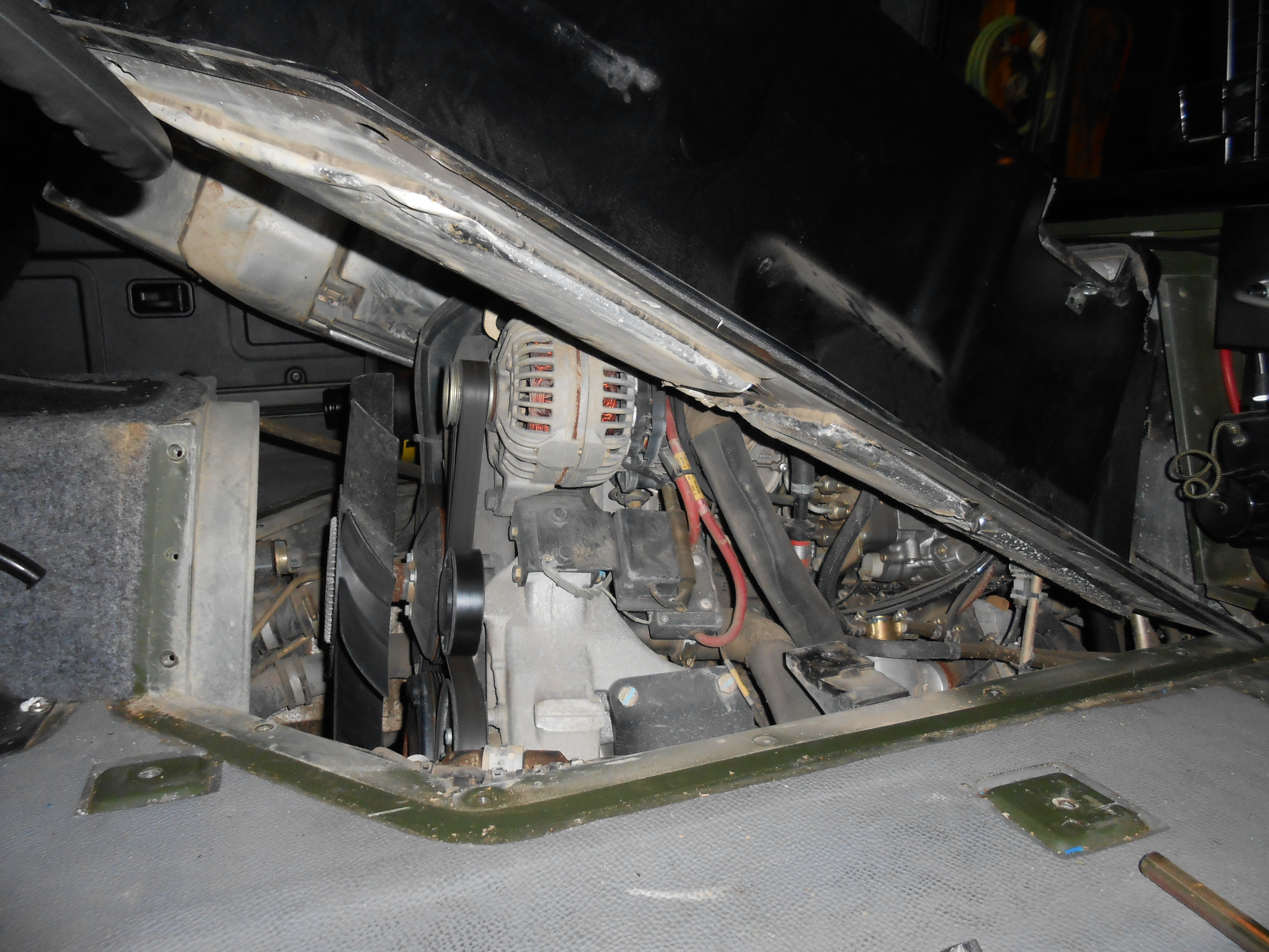

I returned to R&Ring the doghouse to know how to do it when I have to, and to see the engine :D
To prove it is a VW and not 5 hamsters :mrgreen:

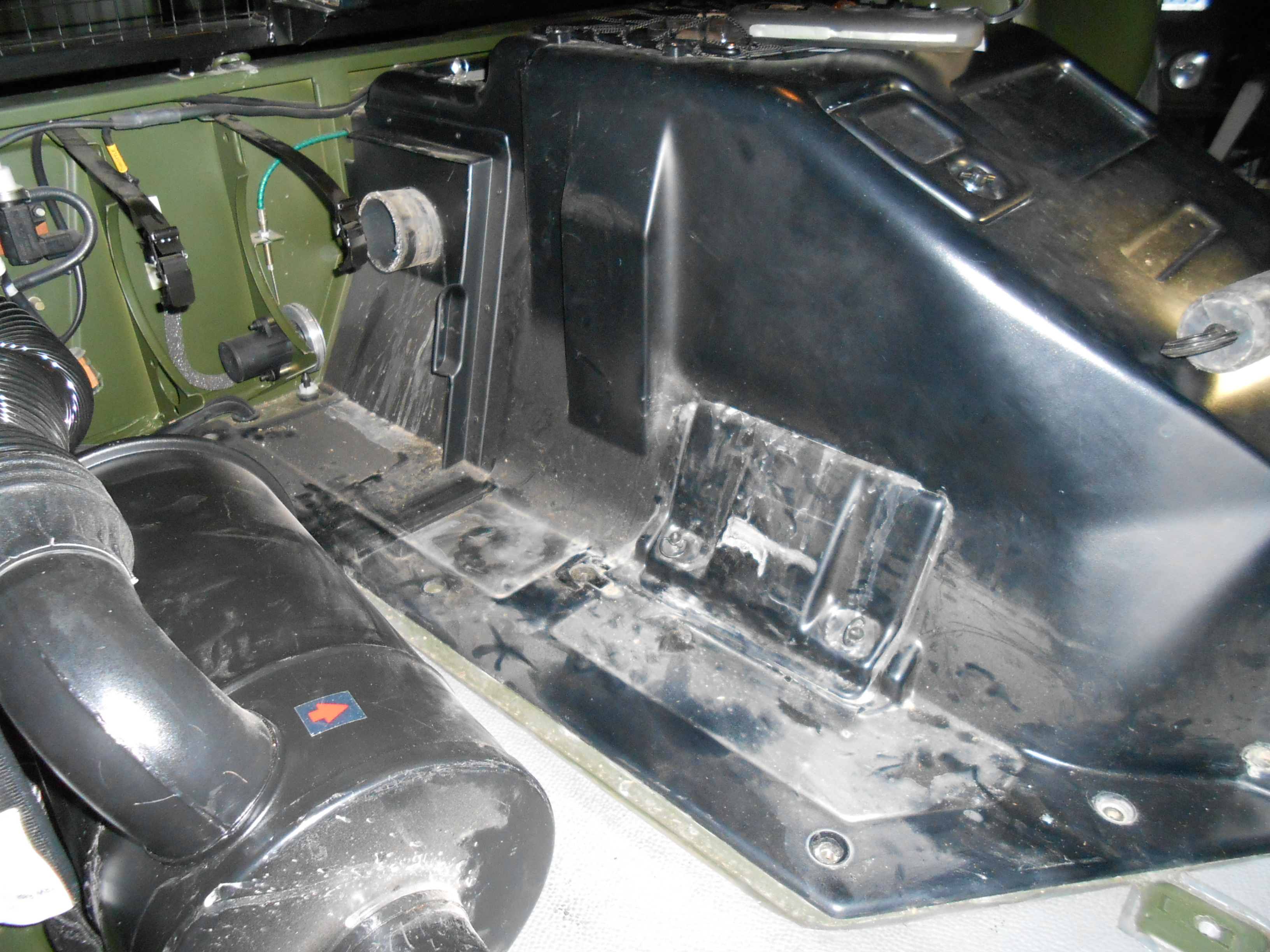

The doghouse
And I found my coolant lost. Unfortunately, I didn't see this until I uploaded to the computer, but it doesn't matter. The front shroud, radiator and intercooler needs to be removed to get into the tunnel.
The coolant leak isn't as bad as it may look. I have never been able to find a drop of coolant under the truck ever. So removing the cover did point me to one of the items that needed to be dealt with eventually. :D Talk about dumb luck! :lol:
And yes, it looked like the truck spent most all of it's 262 mile life in the mud hole proving grounds :roll: :lol:
