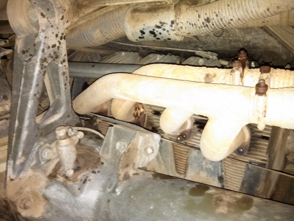

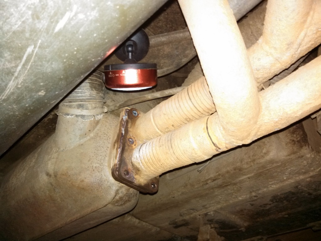

There isn't much information in any of my manuals regarding the exhaust system and a small write-up might help speed things up for others. The system is pretty simple, but can be very frustrating as you're laying on your back and dirt is falling in your face. Loosening exhaust nuts or even studs seem to be common on our trucks. My Pinz had a bad exhaust leak right at the cylinder head gasket, a few pin-holes in the shell of the heat-exchanger, and a rusty-but-solid muffler. The whole length was removed, patched, or replaced, and ceramic coated. Here's the step by step I recommend. This isn't the order the I used, but in retrospect it seems to be better.
you can see black around the leak at #4 cylinder
1. Soak every nut and bolt in pb blaster or liquid wrench or something similar and go away for a day, the do it again and go away again.

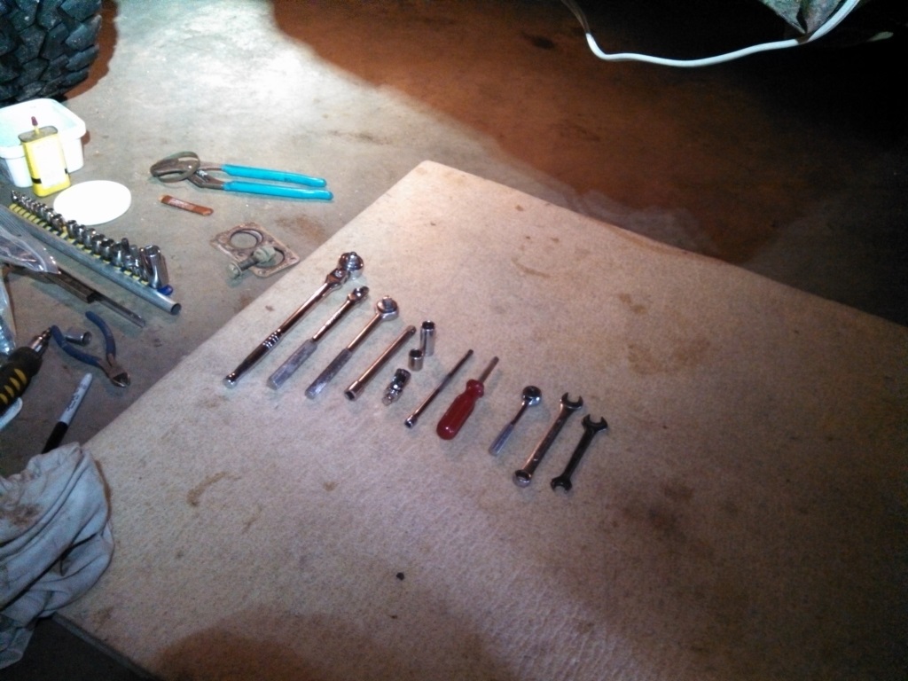

2. Lay out every 12 and 13mm socket or wrench that you own and make sure you have a couple extensions and flexible "u-joints" for your sockets. 1/4" and 3/8" drive and deep and regular sockets. You'll need them all if you take off the header. Note too that for most projects I advise to have a beer handy- not this one- its so frustrating I saved the beers until the end.

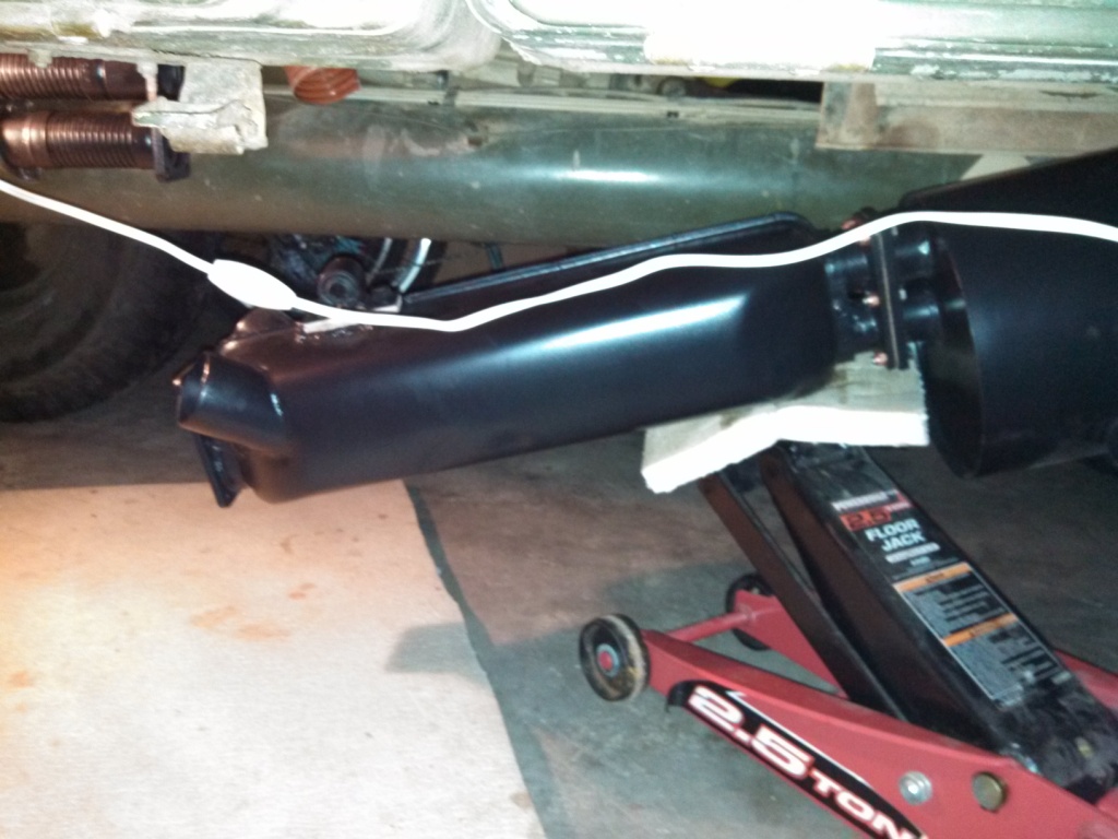

3. Support the HE and muffler with a floor jack and unbolt the 6 bolt flange connection between the header and front of the HE, Remove the hanger bolt on top of the HE, then remove the 2 bolts at the rear of the muffler and lower the whole system in 1 piece. Some of the nuts at the front of the muffler, under the heat shield, are especially difficult to get at from underneath and its much easier to work on when the whole thing is out.

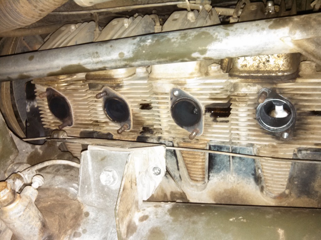

4. Now comes the joy of pulling the header. You get to use every possible combination of sockets and extensions and joints and adapters. Cylinders 3 and 4 are reasonably accessible, but 1 and 2 each have a very difficult to reach nut. Some nuts were loose and others only came out with the stud. Release the parking brake to loosen tension on the cable if its in your way.

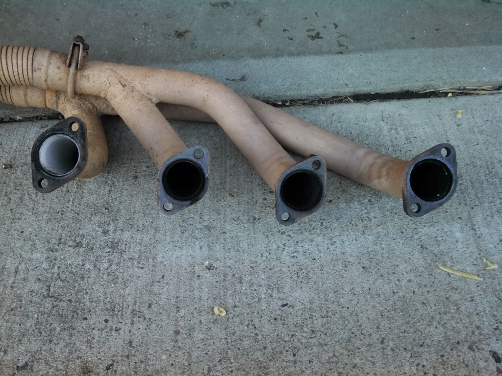

5. Save the nuts and bolts and soak them in PB blaster. Keep track of the 8 header nuts and washers they're nice little pieces of engineering. 11 of the 12 flange nuts are special slotted locking nuts and don't need lock washers. Clean them to see the slots. Replacements are available on ebay- same as BMW's use. 1 of the nuts by the HE is different- thinner than the rest and also has a shorter bolt too.
white deposit from lean condition due to exhaust leak on #4

7. Make any repairs. After sandblasting and patching a hole in the HE, the whole thing, including the SS muffler was ceramic coated. Its supposed to help with keeping the exhaust gasses hot.
8. Inspect and replace gaskets. Install the header centering rings on the heads and fit the header back on. The torque values are __
9. Bolt the HE and muffler together again. Use anti-seize on all the nuts and bolts in case you ever have to do this again.

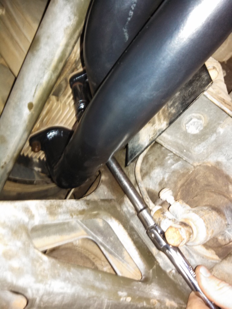

10. Lift the assembly back in place with a jack and hand tighten the 2 rear muffler nuts and bolts. Slip the HE hanger bolt back in place to support the assembly.

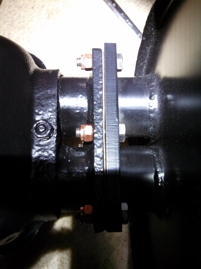

12. Align the HE/muffler with the 6 bolt flange on the flex coupling of the header. Slip in a new gasket and bolt up tight. Remember the one thinner nut and shorter bolt here.
13. Check the bolts for torque from stem to stern- don't forget the top hanger bolt! Enjoy beer now.

the center nut is thinner and the bolt shorter
