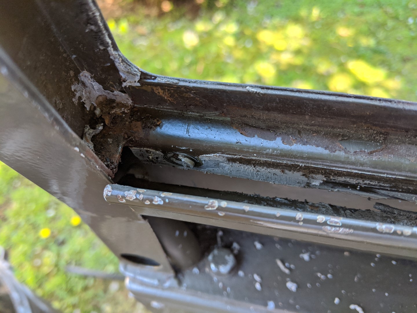

Same issue on my left-side-front door -- lots of adhesive holding the lower U-channel in placed, and gluing the z-shaped retention strip in place (the one with five bolts). Just required pulling out pieces of the lower U-channel and working a thin putty knife in the gap to separate the retention strip.
