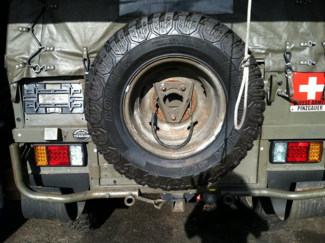

Has anyone installed the Swiss Style LED tailights from SAV? I am not a huge fan of the newer bar light from the Diesel Pinz, and these look like a great compromise.

Those sure look nice, might be time for an upgrade.

Like a dumbass....when I replaced the DS rear panel, I forgot to re-insert the rubber grommet on the light when reassembling. Took the truck out this past weekend and noticed the rear lights were not working. Opened up the DS tailight and it was FULL of corrosion. Figured I would replace both. :oops:
Forgot to mention you need the new flasher unit for these.

I didn't like the TD lights either - your rear tire ends up hitting them as well and can break the left one if you don't adjust the door stop!
Only posting these as they are another LED option and include reverse lights

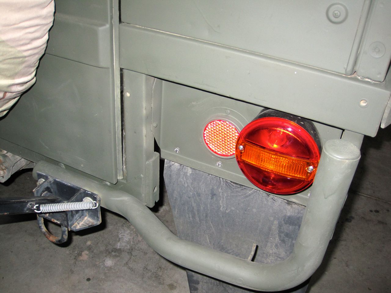

The original lights provide poor visibility for following drivers which is why many of us have changed ours. Hella makes a "cheeseburger" style combo light that looks similar to the LED units but uses filament bulbs.
http://www.amazon.com/HELLA-001685231-1 ... stop+light
They are larger than original but provide plenty of visibility. No reverse bulb though.

Excellent! SAV sells something similar for $26.50US, plus shipping. Issue for me is still bulb sourcing.

I installed the $26 SAV standard filament "Cheeseburgers" last year and they are great. They were an easy and direct fit. The way they are wired, the amber light goes unused; I intend to wire those up to an additional flasher module and have yellow flashers for when I'm freeway driving or on hills.
I am very happy with them and I feel that they maintain a classic / pseudo-stock look.
Edit...I wanted to mention that I feel it's very important to have red brake lights, at least where I live; this was the primary factor that influenced me to upgrade. I used to be terrified that I would get rear-ended because of the amber brake lights and now it's one less thing for me to worry about.

don't mistake the two types of lights shown here. The ones that SAV sells for around $30 are not the same lights that SAV sells for $128 a set. The $128 a set lights are GREAT! One of our members has them and you can see his truck from very long ranges. The brake lights are MUCH brighter then the lesser expensive set. Both are better then the original for lighting.
