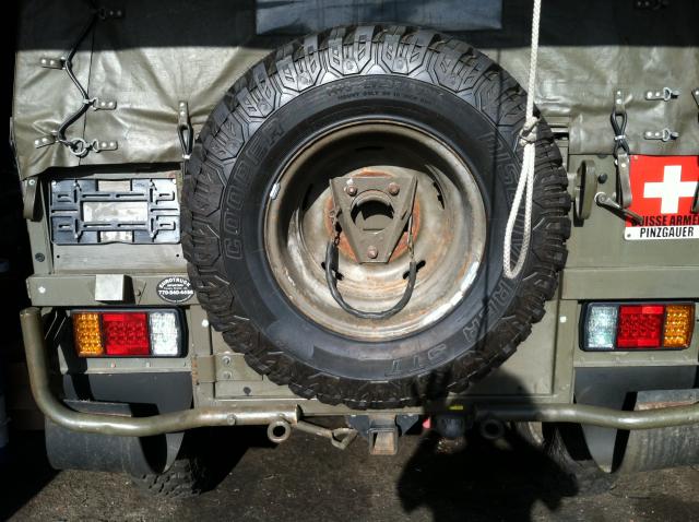

I didn't like the TD lights either - your rear tire ends up hitting them as well and can break the left one if you don't adjust the door stop!
Only posting these as they are another LED option and include reverse lights
I went with the JW Speaker Model 265 based on Chris' post
viewtopic.php?f=18&t=5326
My install:
For me they were IMO the cleanest install but you do have to cut a hole.

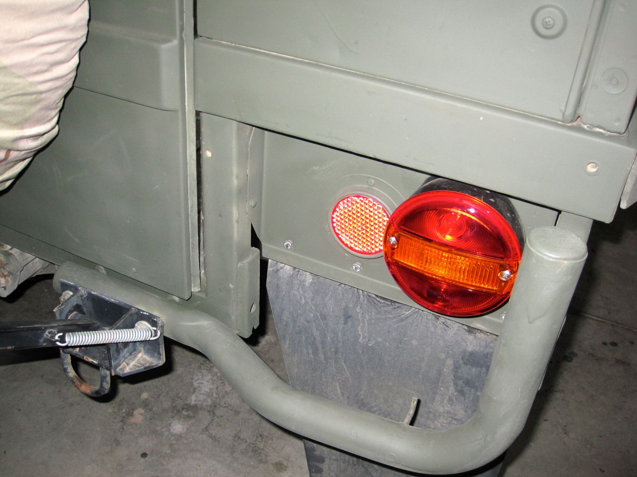

The original lights provide poor visibility for following drivers which is why many of us have changed ours. Hella makes a "cheeseburger" style combo light that looks similar to the LED units but uses filament bulbs.
http://www.amazon.com/HELLA-001685231-1 ... stop+light
They are larger than original but provide plenty of visibility. No reverse bulb though.
Excellent! SAV sells something similar for $26.50US, plus shipping. Issue for me is still bulb sourcing.
http://www.pinzgauer.com/showdetails.ph ... no=SAV3503
