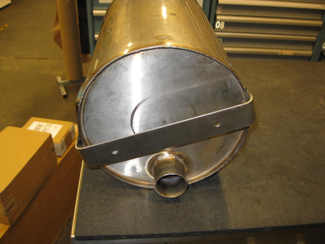

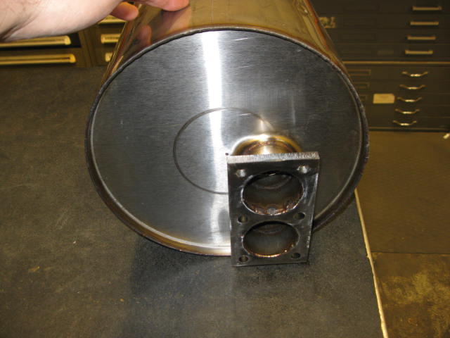

Does a portion of the pipe stick out the rear to attach a tail pipe to? Same configuration in the front (engine side)?

Re: Stainless Steel "Rear Exit" Mufflers in Production
Picture says 1000 words.......
Scott
Scott
- IMG_1114.JPG (48.16 KiB) Viewed 8986 times
