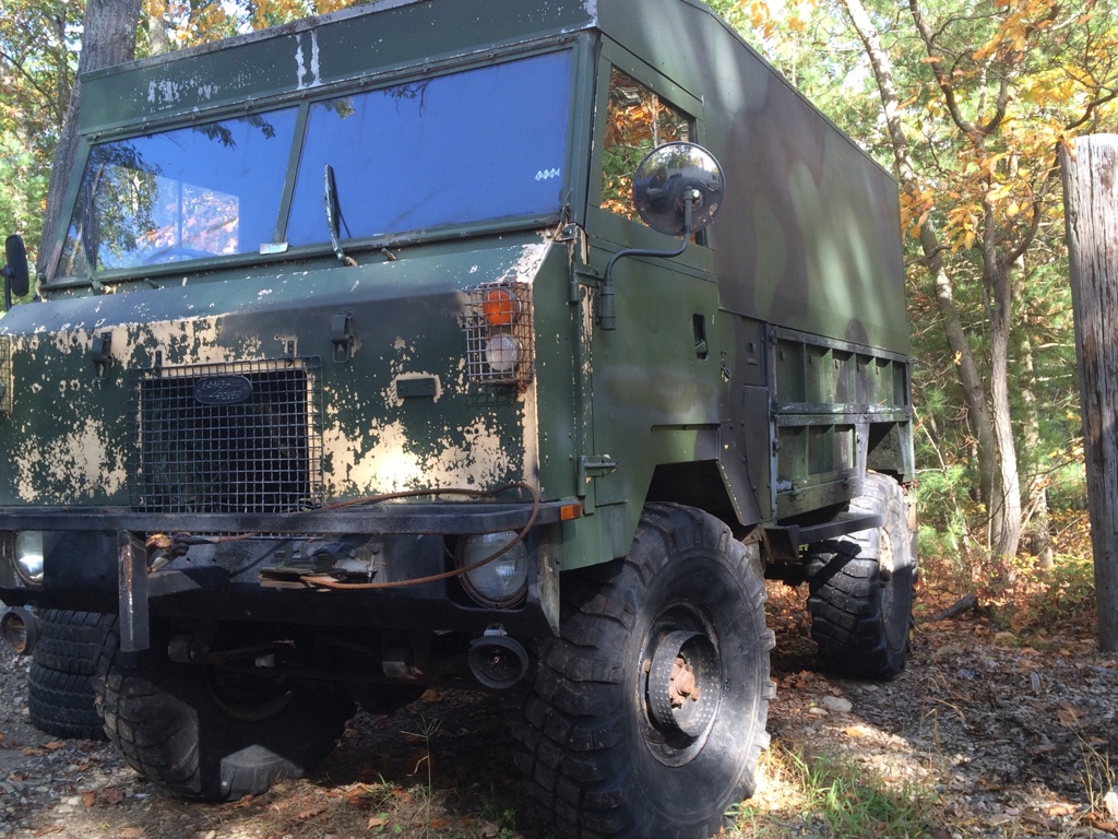

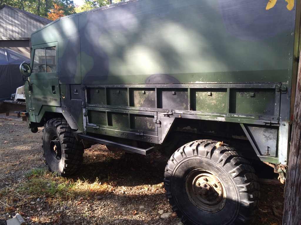

Hey guys! New to the forum. I may not have a mog, pinzgauer or Laplander at the moment, but I did pick up this beast over the summer off a gentleman in Connecticuit. It's a land rover 101 forward control. It's an ex English military "air portable" gun tractor, and I've been slowly restoring it this summer
I have more pics in the link too!
https://www.dropbox.com/sh/dgge1337wccg ... d8Jbjur0Ya
While it doesn't have front and rear diff locks, or portal axles, it does have the land rover 3.5 v8, range rover 4 speed w/ overdrive "all wheel drive", and pto driven "nokken" winch. I also have the original canvas top for it that I'll be replacing the custom hard top with.

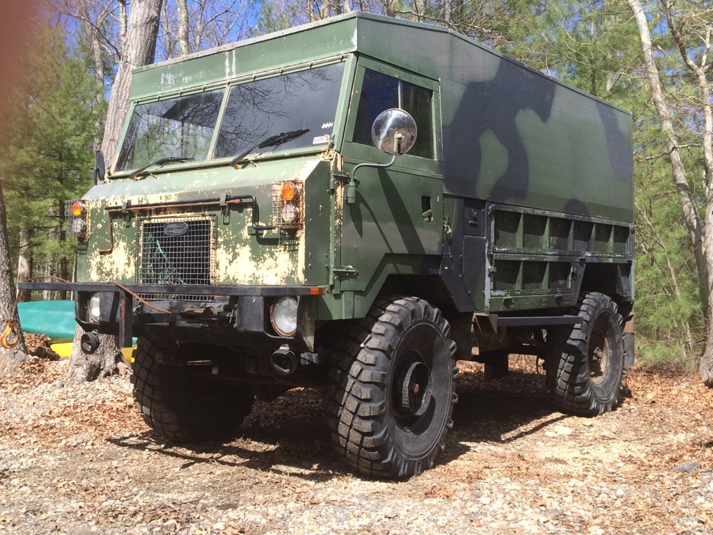

The resto has been slow going since its winter and working on this thing in the cold kind of sucks. At least lots of my European parts have come in so I can finish putting her together!
Here's some more pics to hold YA over
