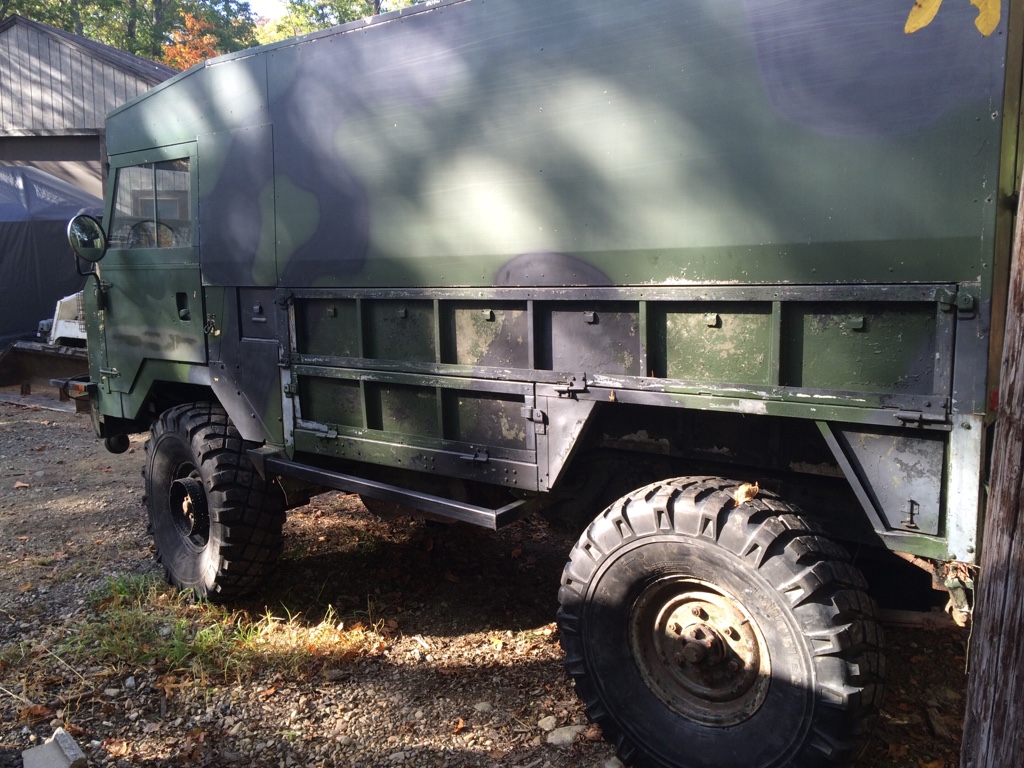

Posted: Mon Oct 20, 2014 7:59 pm
by Heyitsmike
Big tires!
Re: Rosie the rover
Posted: Tue Oct 21, 2014 6:13 pm
by Garrycol
Those tyres look the goods - will be good to see it back on the road.

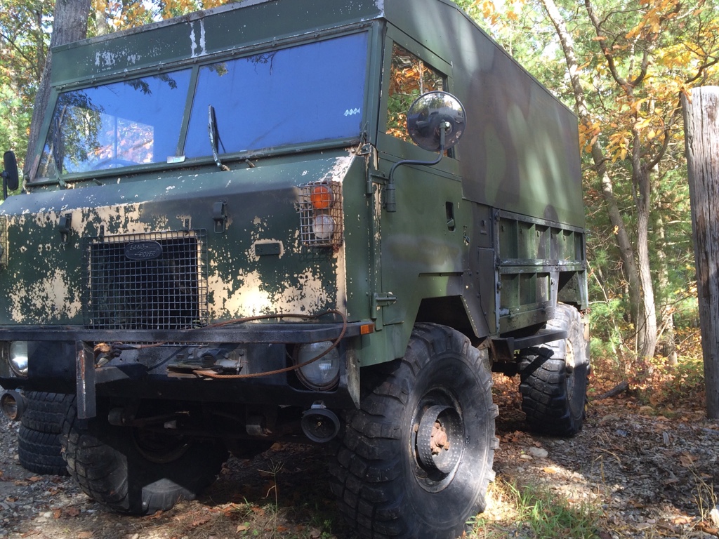

Posted: Fri Jan 23, 2015 10:16 pm
by Heyitsmike
The resto has been slow going since its winter and working on this thing in the cold kind of sucks. At least lots of my European parts have come in so I can finish putting her together!
Here's some more pics to hold YA over

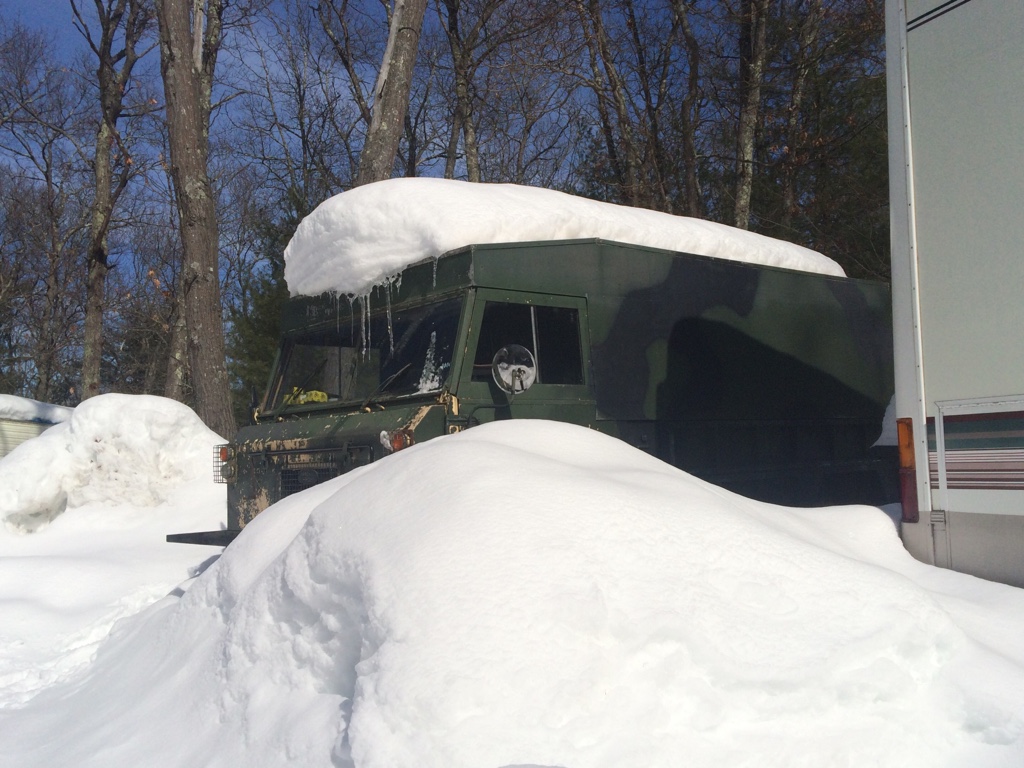

Posted: Thu Mar 05, 2015 12:37 am
by Heyitsmike
Getting reaaaaaallyy sick of your crap Mother Nature...
