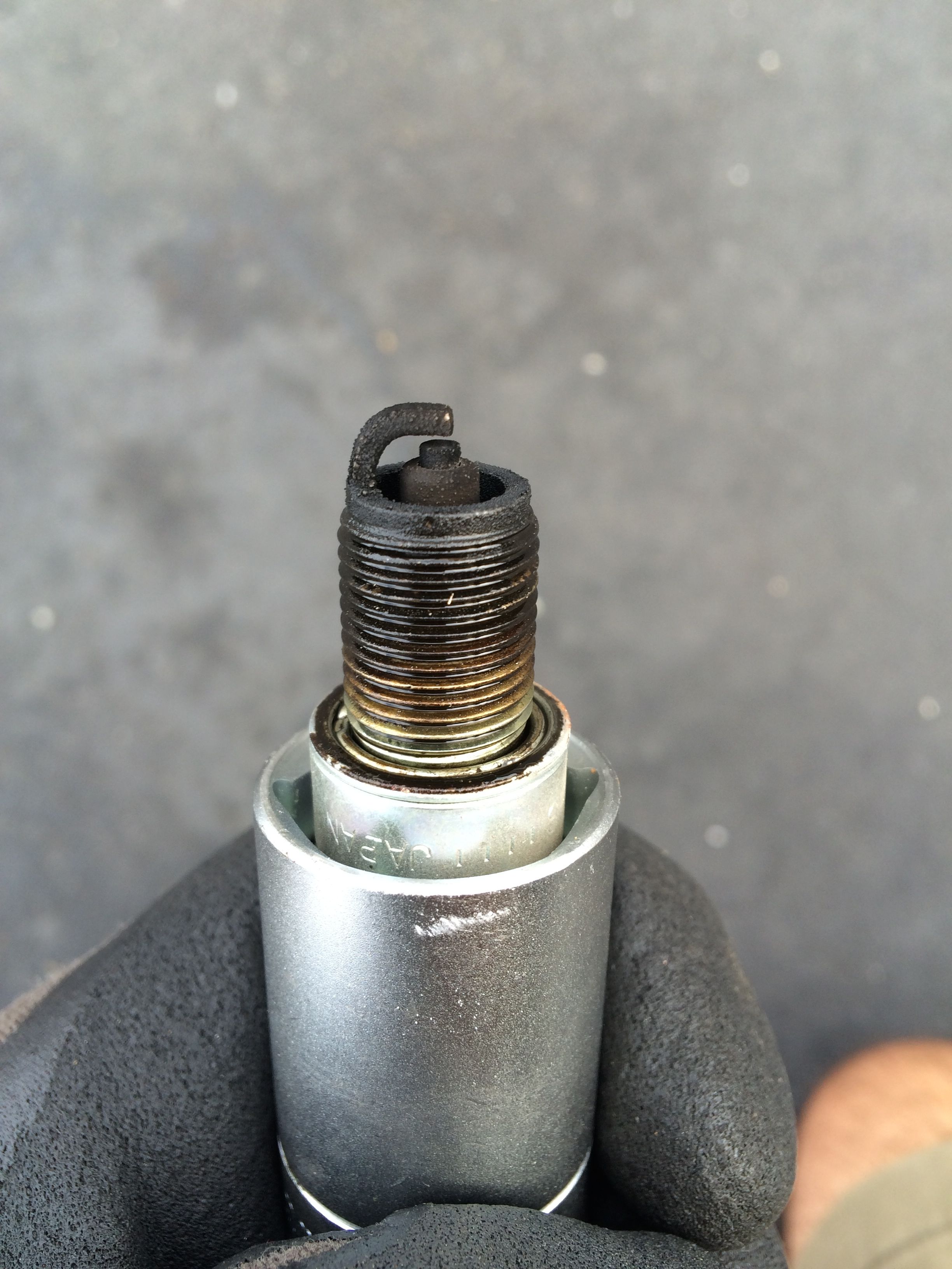

#3: Dark + LOTs of Oil
#4: Dark + Oil

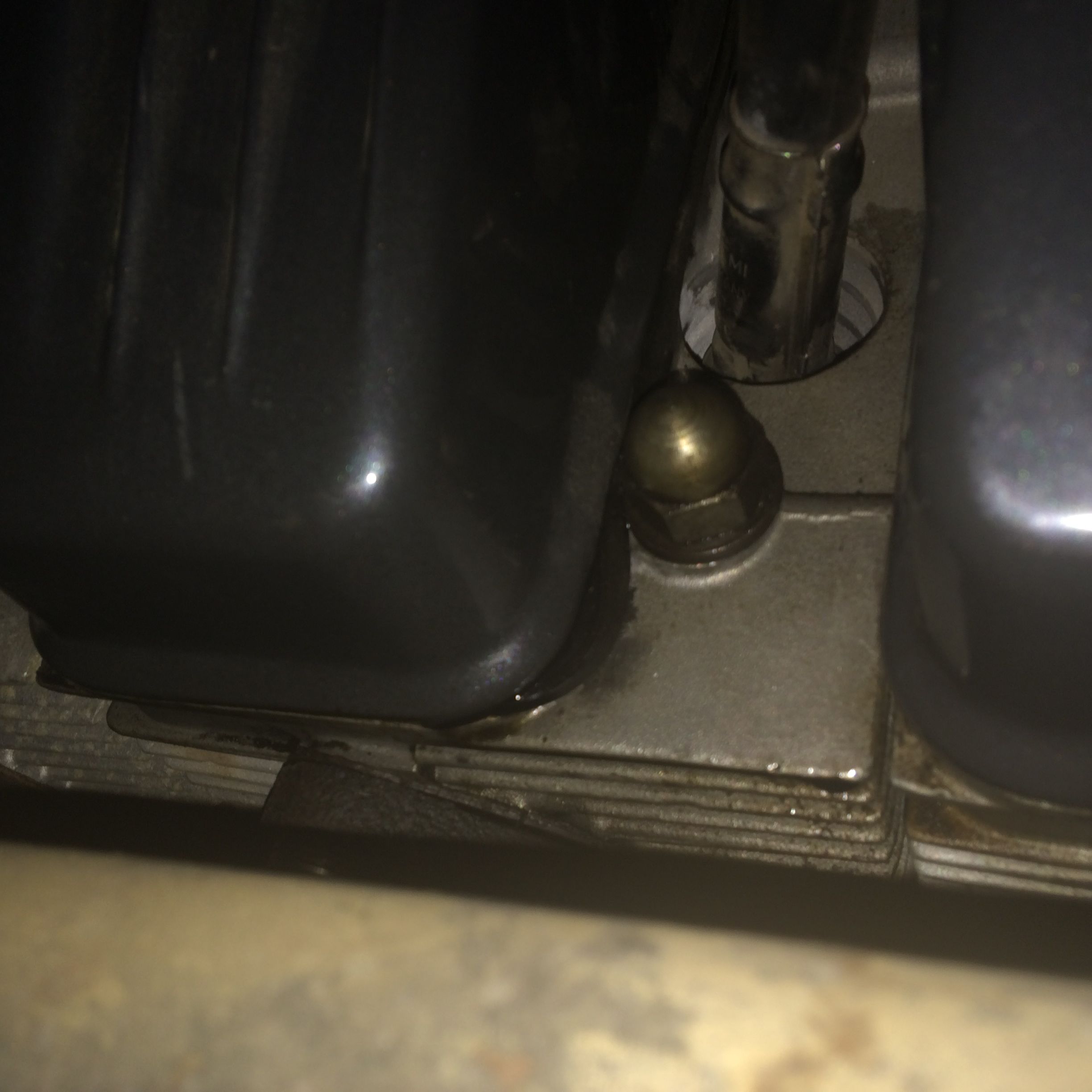

#3: the valve cover gasket seems to be off on it's lower right side
#4: Dark + Oil

- Valve cover gasket Cylinder #3
- Valve cover gasket #3.jpg (294.67 KiB) Viewed 8440 times

- spark plug cylinder #3
- spark plug #3.jpg (729.43 KiB) Viewed 8440 times

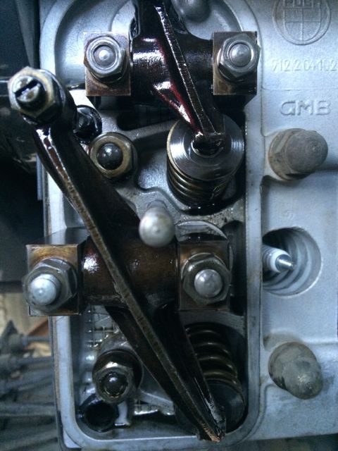

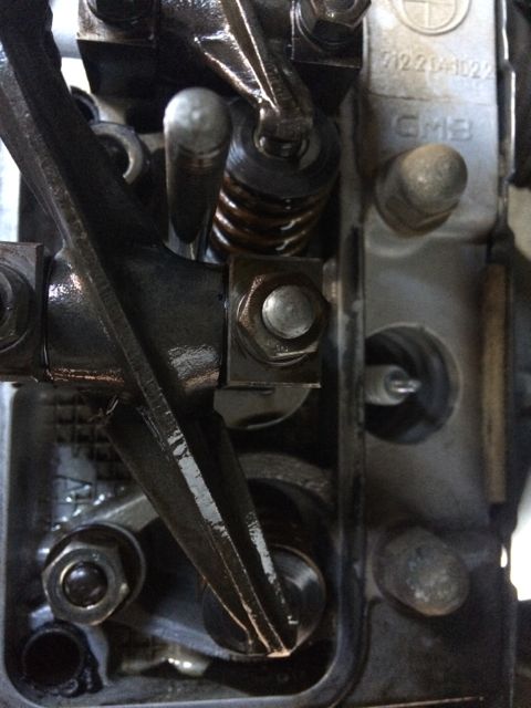

- I opened the Cylinder head covers:
My observation shows O-rings on the oil return tube are decreasing in quality from 1 to 4 (see picts). Could this be something / indicate a O-ring / Oil return tube replacement?

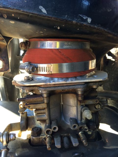

- Weber 36DC NVA 18
- Weber 36DC NVA 18.jpg (56.11 KiB) Viewed 8437 times
- Cylinder #4 - open head cover
- Cylinder #4 open head cover.jpg (51.81 KiB) Viewed 8437 times
- Cylinder #1 - open head cover
- Cylinder #1 open head cover.jpg (61.87 KiB) Viewed 8437 times

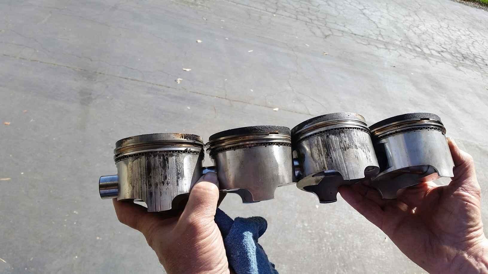

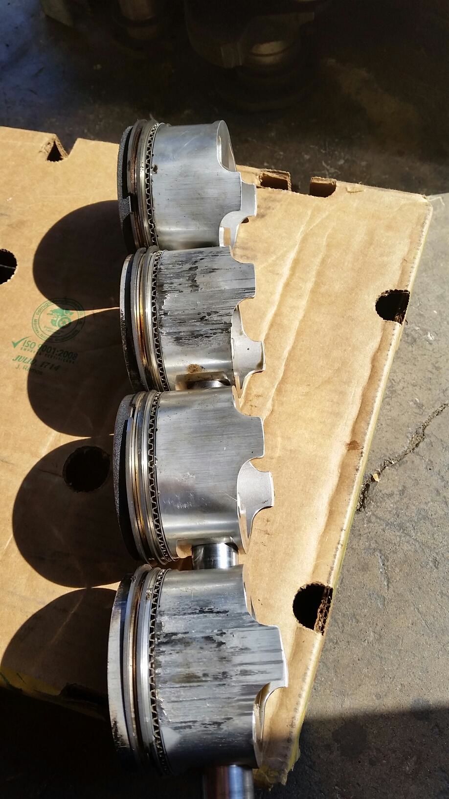

ok, riddle solved. Two of the 4 pistons were bad (see pict). New ones are in the making.
Question to the community: I wonder how this could have happened? The car's engine was completely rebuilt; and not driven past 500 miles after that (over 3 years). According to the tech shop, some dirt got to the pistons and srewed things up. Not sure if that's it. I want to avoid that I'm not overlooking another issue that led to this prob.
All ideas/thoughts are welcome!
Thanks, Sacha
Thanks, Sacha
- Bad pistons 2/2
- IMG_2311.jpg (211.23 KiB) Viewed 8053 times
- Bad pistons 1/2
- IMG_2310.jpg (137.45 KiB) Viewed 8053 times

Was your engine rebuilder familiar with air cooled engines? Piston clearance needs to be greater in an air cooled engine to prevent scuffing like you've experienced. Also, were the pistons oriented properly at assembly (mark on piston crown faces flywheel)?

First, what brand are the pistons and second what was the clearance spec?
Lack of clearance is main suspect.

I agree with GRCameron & Jim L. You need to do the math! The pistons also need to be 4032 aluminum, not 2618. Here are the coefficients of expansion for each.
4032 AL 2618 AL Cast Iron (cyl)
0.0000112 0.0000129 0.0000058
These are in inches/inch/degF Figure on ~ 175 deg increase in temp from room temp so 240. You'll appreciate where that little bit between the 4032 & the 2618 can be the difference between clearance and seizing.
