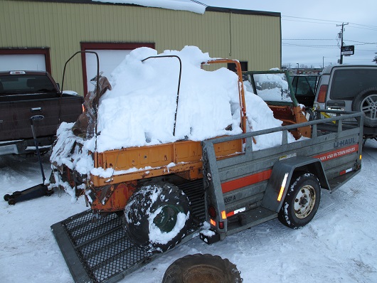

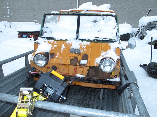

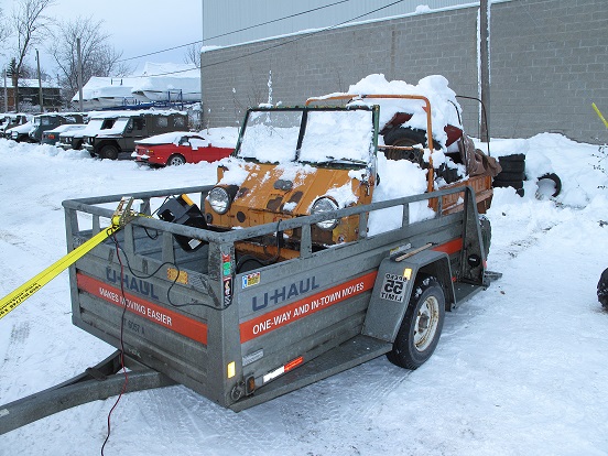

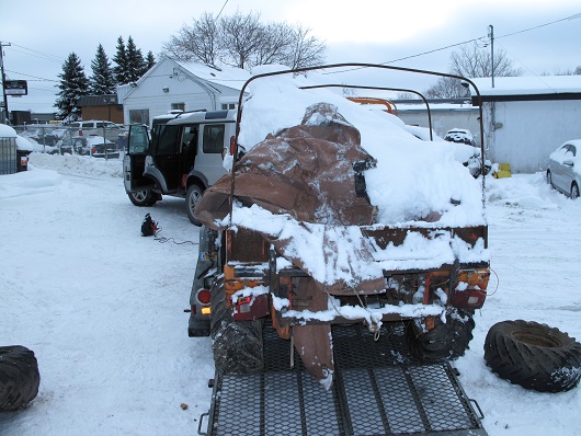

Ok! Ok! I get the hint. Here are the first photos complete with a little Montreal snow.
The wide tires had to come off to fit the trailer.
If I save my pennies maybe a can rent a ride in the tracked beast some day!
Afraid the Rover got jealous after getting us home safely and now will chew up tomorrow evening with a fraying serpentine belt. There really is a reason the Rover in the Gods Must be Crazy was called the anti-Christ. What can you expect from a Rover with carpets?! The 63 will haul it to the wrecker one day!
The snow did melt by the time we got home.
Cheers, Clive
PS Dan, any idea of the model and age? It has no number plates and I haven't found the frame number yet.

Is that at Pinzgauer Canada in Laval?
I think that's a Canadian unit.. 64-67.. Just a guess.
