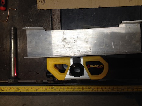

up with is a way to to the reference more accurately using a Laser level. You need a Laser level (any one should do), a 12" piece of 1"x3" (or 4")
Aluminum U stock, and 4 plastic 12" x 16" cutting boards (Walmart, or Target). Cut clearance for the lug nuts, you won't need to remove the hub
steps. Picture below shows LAser and mounting bracket, bean is hitting a "reference" point.

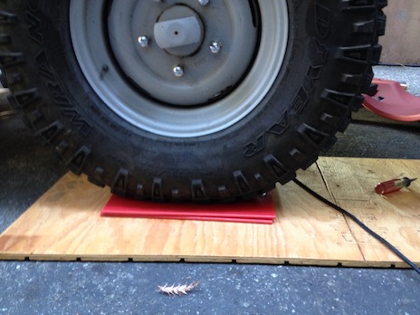

Next you need to get your front end on Toe In slip plates. The wheels need to rotate reasonably freely and not have a lot of ground friction
which will throw off your adjustments. The trick here is you cannot jack up your front as then you will have a lot of artificial camber which is
not natural. Place a pair of cutting boards on a sheet of plywood, put a little Oil on the inner surfaces, box them in with strapping on the edges
to temporarily hold them in place while you drive on the cutting boards. Remove strapping -- your all set with Toe in slip plates.
Next position the Laser finder and mounting bracket. To the inner wheel, keep it flat. Measure the distance from the rim to the hot point of the Laser,
mine was 78mm. Place a piece of anything off the rear rim e.g. cardboard, and measure that to the reference height (e.g. 78mm in my case), mark
that. You will also need a 2'nd mark further out for the amount of Toe in desired -- discussed next.
The amount of desired Toe in is a little simple math. Toe in is 2mm to 4mm, or from the center of the wheel to the rim is 1/2 that or 1mm to 2mm.
The rim to rim length is 438.15mm or a radius of 219.075mm. The distance from the center of the front wheel to the rear rim edge is 1981.2mm.
Doing the math the additional distance beyond the reference length at the rear rim is 9mm to 18mm, in my case this was 78+9 to 78+18. This was
dead accurate -- no strings attached. It was also very fast to do.
