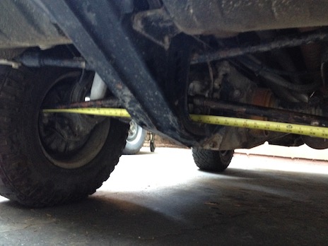

good idea where you are with a tape measure, measuring front and back distances across the front tire rims as below -- go through the yoke hole
to keep the tape straight.
When I did this it was clear I was way off and in the wrong direction.

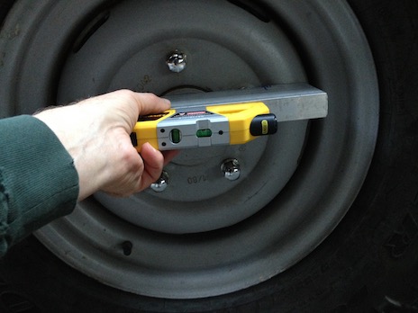

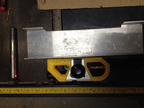

up with is a way to to the reference more accurately using a Laser level. You need a Laser level (any one should do), a 12" piece of 1"x3" (or 4")
Aluminum U stock, and 4 plastic 12" x 16" cutting boards (Walmart, or Target). Cut clearance for the lug nuts, you won't need to remove the hub
steps. Picture below shows LAser and mounting bracket, bean is hitting a "reference" point.

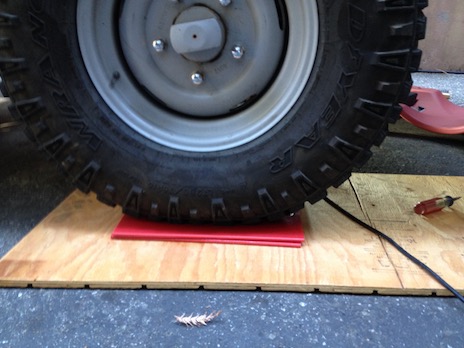

Next you need to get your front end on Toe In slip plates. The wheels need to rotate reasonably freely and not have a lot of ground friction
which will throw off your adjustments. The trick here is you cannot jack up your front as then you will have a lot of artificial camber which is
not natural. Place a pair of cutting boards on a sheet of plywood, put a little Oil on the inner surfaces, box them in with strapping on the edges
to temporarily hold them in place while you drive on the cutting boards. Remove strapping -- your all set with Toe in slip plates.
Next position the Laser finder and mounting bracket. To the inner wheel, keep it flat. Measure the distance from the rim to the hot point of the Laser,
mine was 78mm. Place a piece of anything off the rear rim e.g. cardboard, and measure that to the reference height (e.g. 78mm in my case), mark
that. You will also need a 2'nd mark further out for the amount of Toe in desired -- discussed next.
